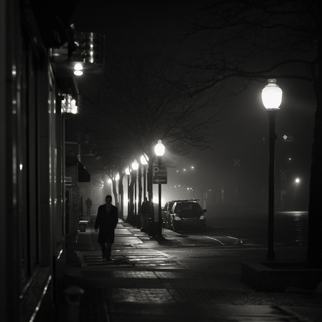

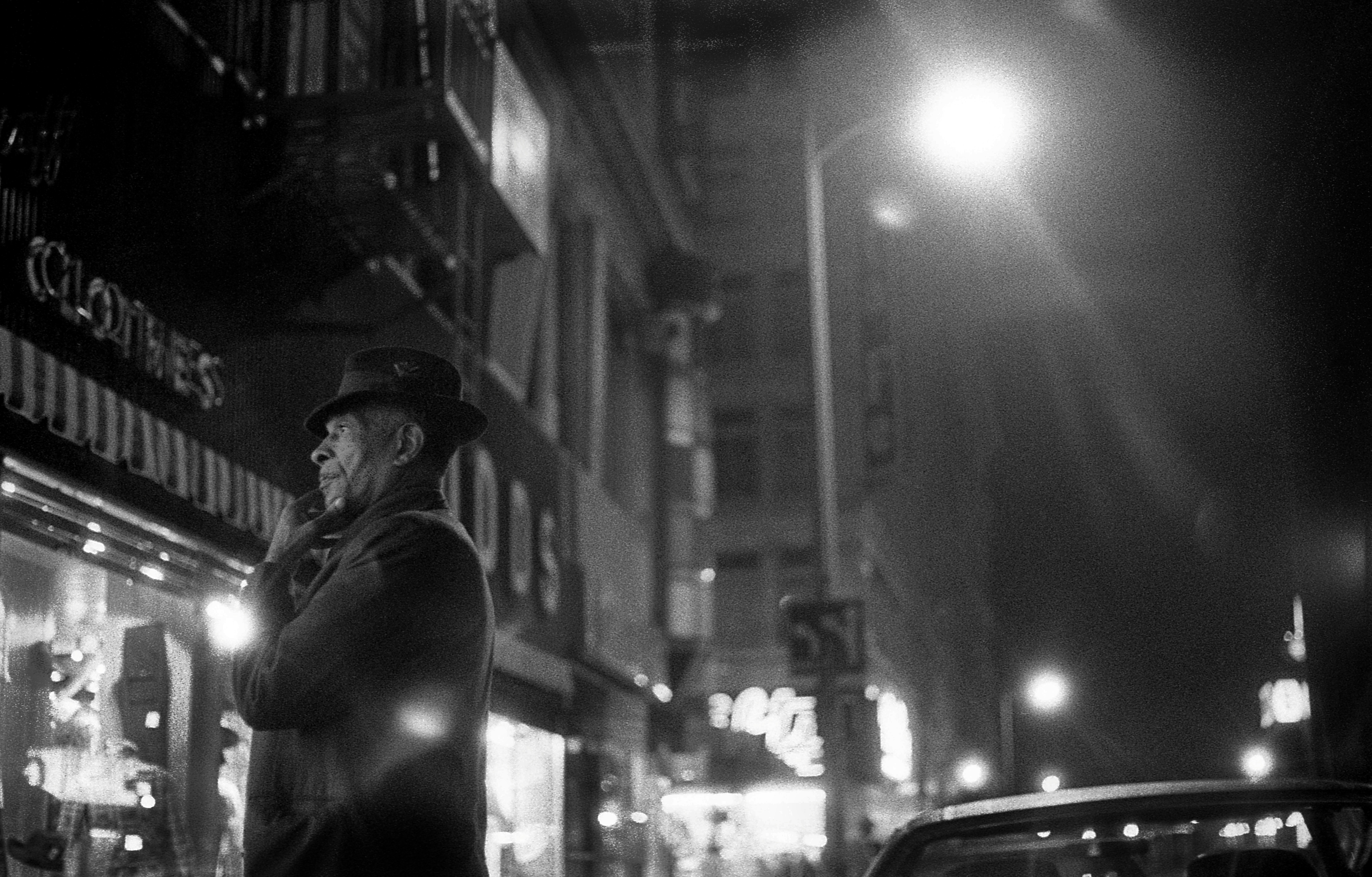

These aren't my photos, but I'm thinking similar scenes, but probably with less light sources and more dark areas:

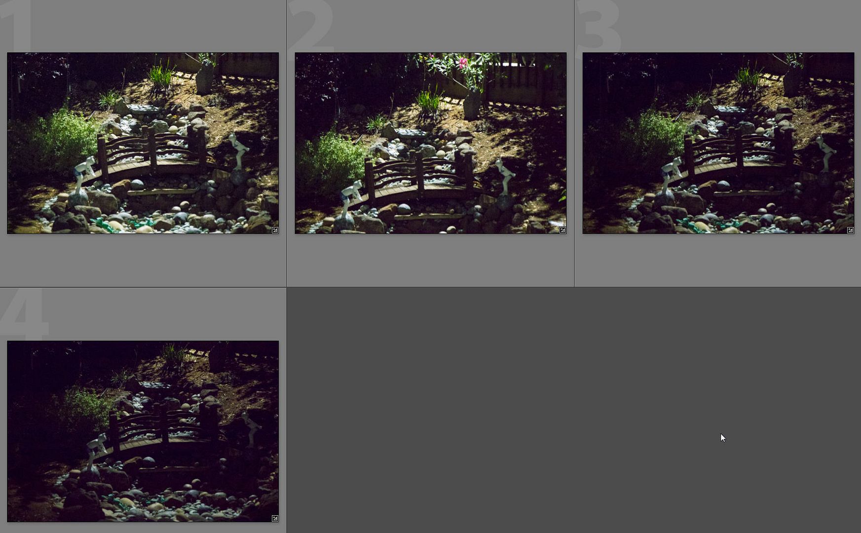

Here is a shot taken at night in my front yard just now (11pm), with scene illumination only an overhead LED street light which is about 25' behind where the bridge in the photo is located.
Photo 1 is per an incident light meter. Photo 2 is per a camera Evaluative metering. Photo 3 is -1EV, and Photo 4 is -2EV exposure (compared to Photo 2).
To the naked eye, photo 4 (or a bit darker) is how the scene appears. Photos 1 and 2 are totally unrealistic capture of the scene, although how a meter would have you expose the shot.
(photos 1 and 2 shot with dSLR set to ISO 12800, 1/4 f/2.8)
