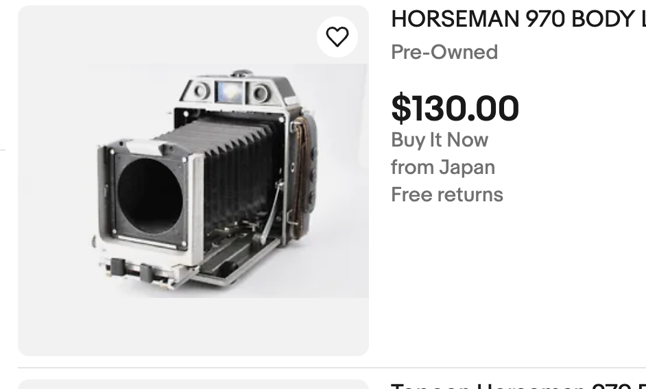

The earlier Horsman cameras are pretty inexpensive. Especially compared to Linhof from which they are inspired. No DOF scale, however.
