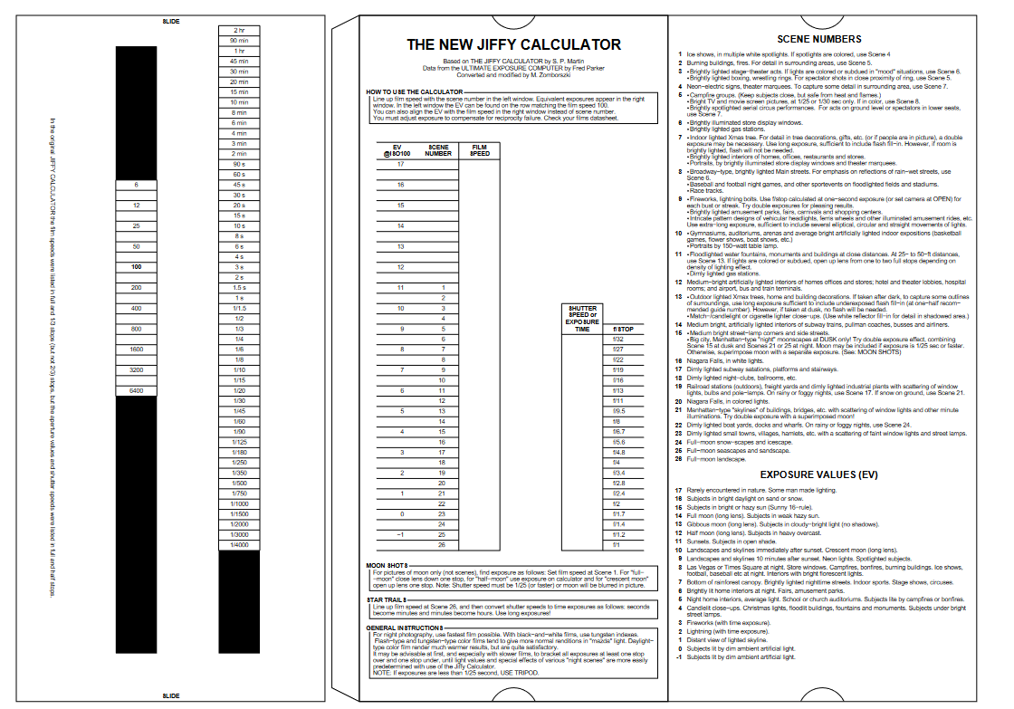

Sirius Glass
Jan 18, 2007
50,869
Southern California
A useful device since 1964.
