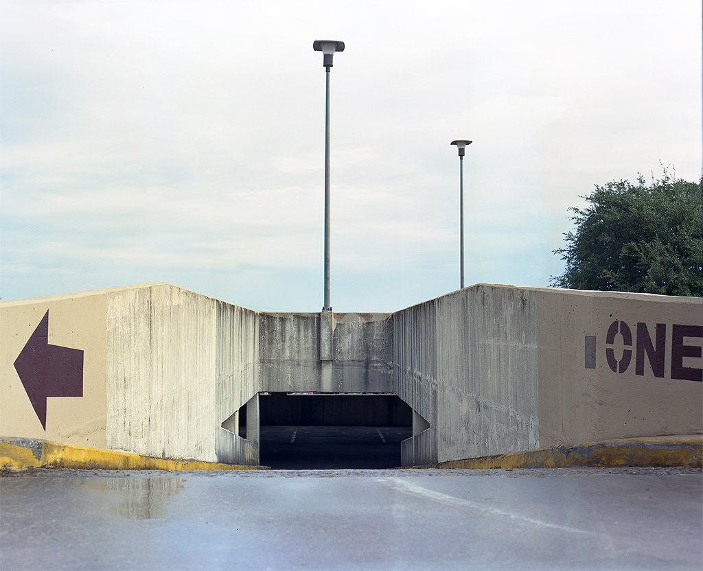

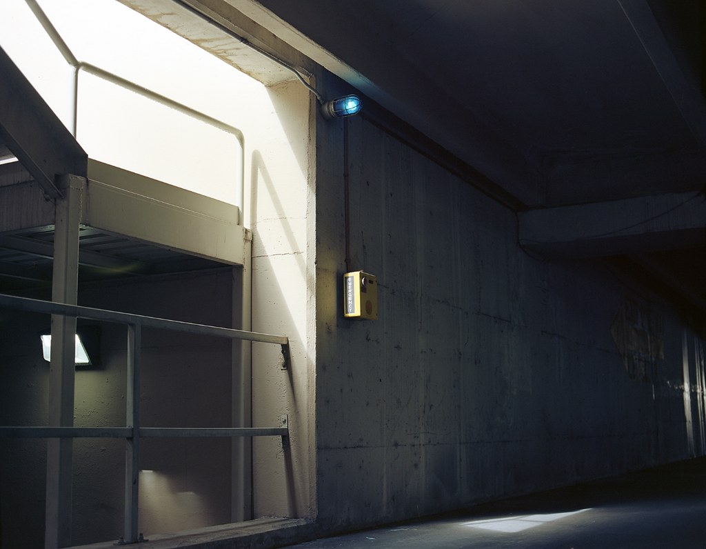

One more test frame. For light leaks. I'm going to do it.
But in the meantime, to anyone who says they see no visible issues; is there really nothing in the first set of pictures, of the wall, that indicates something amiss with the exposure? Nothing in the final picture, of the house, in the shift from red to yellow in the brick work, that is out of the ordinary?
I ask because, let's say that I do decide to switch to a different camera. Would I be right to offer this RB67 as 'tested and fully functioning' with no issues? On eBay right now a good RB67 kit with two lenses goes for $400, at least. Would that be a fair price for this kit? I think this 65KL in near perfect cosmetic condition would probably fetch a little more if sold separately, but generally speaking that's a good price? Given the photos I've posted, this is a perfectly functional camera with no issues?

Your camera and lenses are working perfectly. What you are observing is the natural result of your scene, the light illuminating it, and the laws of physics. Those most recent examples are normal and natural and are consistent with how we see the world.
Your RB67 has a "sensor" that is approximately 56mm x 65mm. Your lenses have to cover that format, and they have to be able to image three dimensional subjects over a wide range of distances. They do that superbly. They show gradation of colour and tone and through that communicate a natural depth and complexity to your photographs.
Your micro 4/3 camera has a sensor that is 18mm × 13.5mm. The output of that sensor is likely to be digitally adjusted (even in RAW) to even out colour and exposure over the frame - thus the unnatural look of your digital example. The lenses only need to cover that relatively tiny sensor, and their "peculiarities" can be measured and adjusted for, either in the camera or later in "post".
Your light source is multi-coloured and multi-directional. Your subject is multi-textured, multi-coloured and reflects light in multiple directions at once. The subject will appear different (both as to colour and as to illumination) depending on the angle of view. The angle of view is different for different parts of your scene. All of those realities result in the real world actually appearing the way your examples show it to be.
If you had a two-dimensional smooth subject, you photographed it with lighting that was much more even, and was controlled in direction and colour and you used a process lens at a distance which it was optimized for, it would be natural to see even colour and illumination.
It is rare for me to say something like this, but it may be that you would be happier with the (somewhat unnatural) output from digital.
But if you want the benefits of those beautiful, large hunks of film you can get them with more even colour and tone, as long as you take control of the light and consider some of the options that light modifying filters can give you.
Sirius Glass
Jan 18, 2007
50,717
Southern California
You do not have a light leak. The dark corners in one of the photographs of the bricks is from the 1/cos4theta lost, which is in all lenses to a greater or lesser extent based on angle of the view [theta].
MattKing
Apr 24, 2005
54,740
Delta, BC Canada
Sirius is correct, although the visibility of the effect is increased by the contrast choices you have made in the digital parts of your process.
Your pure digital example probably just compensates the effect out using firmware/software.

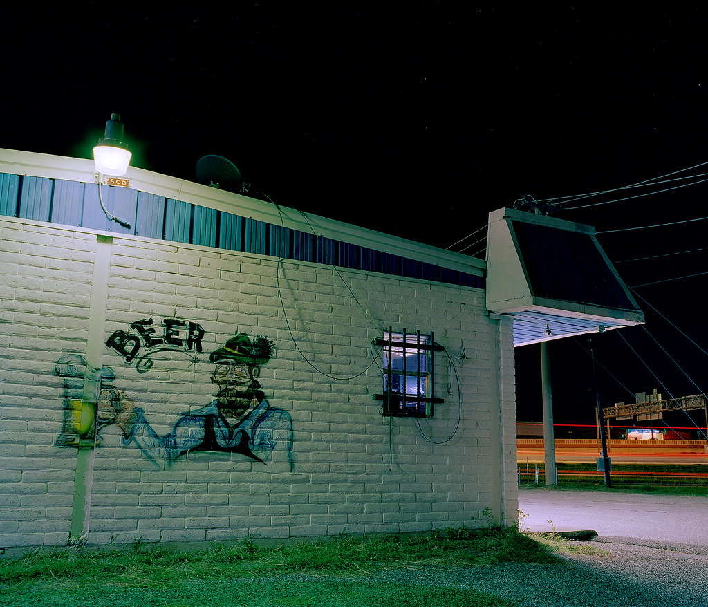

I don't question the statement that our eyes 'fill in' and 'smooth out' what we see. And I agree that how our eyes see and how our brains process visual information is going to affect how we see color in the world compared to how film registers it. But, if we just stay on that last picture of the house... There was nothing in the scene that would have caused the eave to reflect more red light on the right, and nothing to cause the brick to be more reddish-blue on the left, and nothing to make the leaves on the shrubs look more yellow/green on the right. There is nothing but an old fence behind the camera in that shot. Farther out there are some trees and another house.
The camera was pointed directly at the sun, and yet in the image you would think that the sun was to the right, as the left 1/3rd of the sky is cooler.
I'm on the verge of just accepting it and going about using this camera for its normal purposes, which include occasional paid jobs. I still think there's something going on, but whatever it is, it doesn't appear consistently, and isn't really identifiable. It's just that it isn't going to be correctable in traditional prints, as far as I can tell. And while its possible to correct digitally, it's a much more involved and imprecise process, requiring a very low opacity color mask.

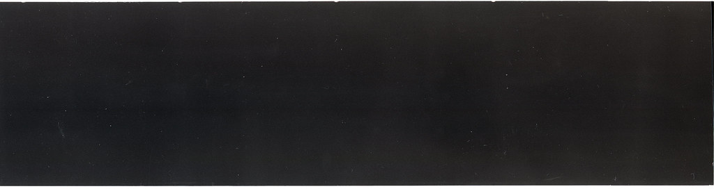

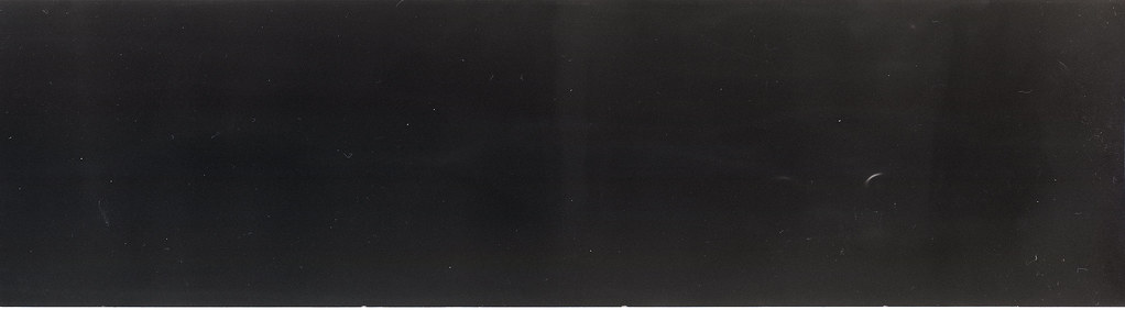

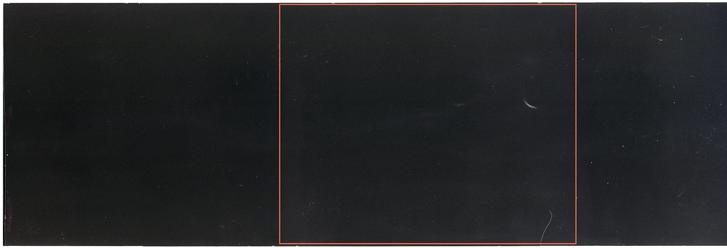

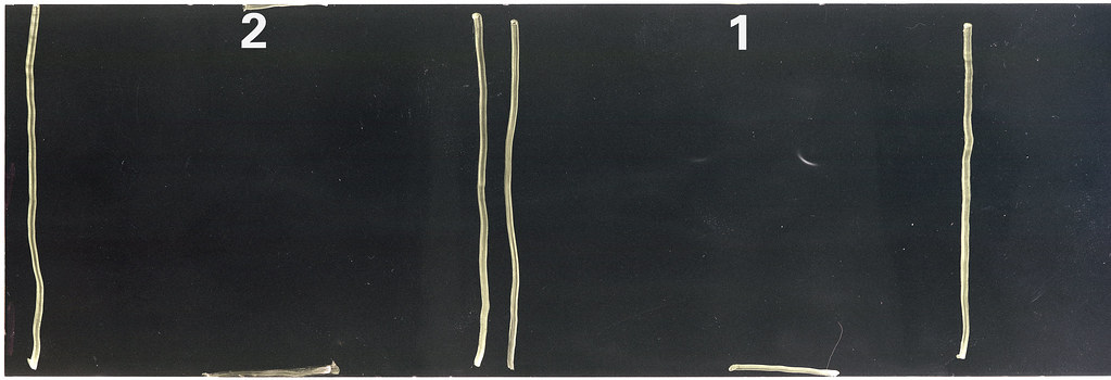

So I did the light leak check. Results were... somewhat inconclusive. Used a very bright LED (my phone's flash light) and circled all around the sealed up RB67 as it was making a Time exposure. I repeated this a few of times with the bellows & WLF open/closed back rotated or not rotated during exposure, for a total of four exposures. (I am thinking now that maybe it wasn't a good idea to rotate the back while making an exposure... didn't seem to resist or cause any damage that I could tell, at least)
I opened the scans in photoshop and cranked up the curves to show a brighter and more contrasty image, bringing out more subtle variation. A pretty hasty scan job... lots of dust, but it doesn't really matter much in this case.
Scan of the first ~40% of the roll. Kind of hard to tell where the frames begin and end.
Start of roll is on the right side of the first scan. The first exposure is also when I was most keen about really bathing the camera in light from all angles for several minutes. It should be that lighter area to the right.
Note that there are a lot of vertical bands.
Those same vertical bands don't seem to appear as strong in this scan from near the end of the roll. I left about 60% of the roll "unexposed". It would only have been exposed to any possible light leak very briefly as I was continuously advancing the film after the 4th exposure.
So, I'm left with the sense that maybe there is a very, very weak light leak that shows up as a vertical band. At first I was thinking that it was just a development process thing, but the 'exposed' part of the roll seems to have way more vertical bands. The last 60% is more uniform.

oh great the results are in.
those bands may be from the light source in your scanner.
look directly at the negatives surfaces? also, perhaps on your tablet or the enlarger baseboard? do you still see those bands? im sure it would be difficult to tell on clear negatives.
rotating the back during an exposure should not leak light.
the dust in scans are usually digital noise.
ive never seen light leaks in the types of bands you exhibit here. if it were a leak, youd see definate localized streaks, spots or flares, but always very consistant n reproduceable.
i wish you did this test outdoors in the sun rather than using an led phone light.
just one more thing.... are these bands consistant with the problem areas in your initial examples at the start of this thread?

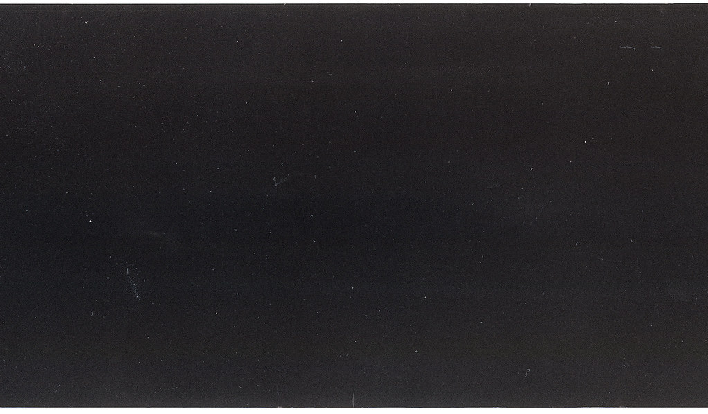

So far I've found no light leaks from application of bright lights into the camera, from the front or the back, or closing up an LED inside. Sometimes it feels like maybe the film back has a little bit of play even when it is locked on. Maybe this could be a point of light intrusion when I'm holding/moving the camera and happen to pull on the back a little bit..
Paul Ron, I have checked it on my DSLR scanning rig. The vertical bands are not as obvious as they are in the scan... but they're there - in the same places. Triple-checked by putting back in the scanner but flipping the orientation of the film so those parts in question are being scanned on a different part of the glass. Results were identical.
I tried lining up the first two frames from this roll with the last roll of film that I shot. Just traced over frame edges in sharpie. Here's the result, from the second flatbed scan:
Even if we adjusted their positions, there's not really any way to space out two frames so that the bands appear at the same general place on both 1 and 2.
-But-
If we consider that maybe the beginning of the first frame was a little farther up the roll (which it could have been), and that the first frame was subjected to a longer 'bath' of light on the camera (which it was), then maybe it is possible to see that there was a little bit of light leaking in on both sides of the frame.. if we place the frame like so
But this isn't repeated in the second frame. If there is light coming into the camera and causing this effect, it is a minute amount.
I wish I had done this in bright daylight, too. But I was impatient and did it in the evening after work. It's too bad, because I'm seeing now how much easier it would have been to compare frame to frame if there was always a constant amount of light all over the camera instead of in different places over time.
The only things I can think to do now, besides take it outside and blow another roll of film on another test tomorrow afternoon, are:
... to get a brighter, safe light and really blast it inside the camera. Maybe I will find a leak this time.
... double check every light seal and redo anything that looks questionable. This may include the dark slide seal, which I have never tried to get at or replace.
To those of you with enough experience to know, does this vertical banding/streaking indicate a possible process issue? Could it be that my fixer is starting to wear out? Is it possible to have varying density in the emulsion due to improper agitation or bad chems? Or does there have to be a latent image of some sort to cause the kind of blotchy bands or streaks that I'm seeing?

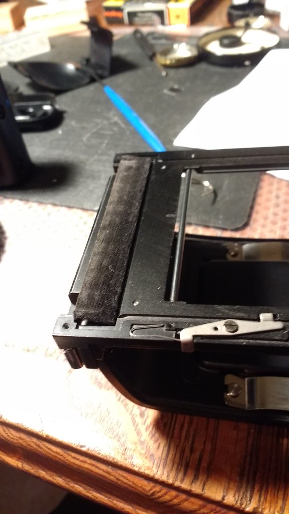

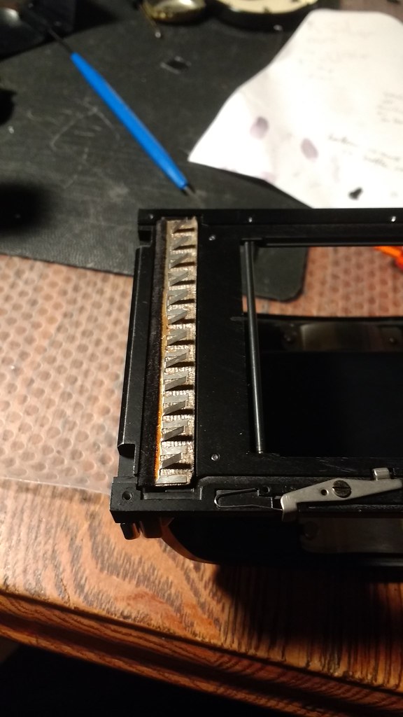

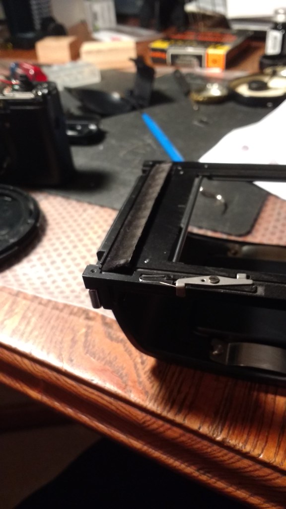

I'm bringing this thread back from the dead for an update. I had decided that however my photos were turning out was good enough, and began using the RB again. Then before long a nice, very very obvious and intense light leak began appearing on every frame I shot. I did the LED-in-the-dark test again, and sure enough there's a light leak at the top of the dark slide slot.
Opened up the slide holder to get a handle on what needed to be resealed, but instead I lost my grip and the little felt-covered light baffle insert got flipped around before I could see how it sat originally.
Anyone with experience working on these things able to help me out? Does it go like this:
or like this:
or like this...?
paul ron
Jan 22, 2004
2,709
NYC
your last picture is correct. remove the dust from the flocking using a post it sticky end. bend the springs ever so slightly to incrrase the tension a bit n help keep it uniformly against the mask to complete the seal.

Replace it carefully. The flocking here is vital to ensuring you don't get light leaks from inserting or removing the darkslide in any kind of lighting. The darkslide being bare metal reflects tremendously well into the film back causing delightful light leak splotches about 10-15% of the way into the image area.

Yeah this leak is new. Although I think there could have been extremely minimal traces of light leakage from the same spot before, as the new bright blotch's location on the frame is roughly congruous with the location of the very slight color shifts I was seeing before. That is, about a finger's width inside from the right edge. Which, when I think about it, I wonder... if the leak is on the right side of the camera, shouldn't the effect be seen on the left side of the image? This is a basic concept that I've forgotten since my HS photography class. Maybe it's reflecting off something internally.
Anyway, after fluffing up the springy felt piece, no more light is coming out of the dark slide slot when I do the LED test. However, the light from the slot was obscuring another leak, this time from just in front of the slot, where the revolving back connects to the mirror box. I have to apply a tiny amount of pressure to really see it, even in total darkness otherwise, but it's definitely there. But the light seals around the back are new, and bear the imprint of the mating surfaces all the way around, so besides doubling up on the thickness of the seals, the only way I could see how to fix this would be to tighten the fasteners between the two pieces... I wonder if that's possible without doing major disassembly. There are four bolt heads on the revolving back that slip into catches on the mirror box. The bolt heads appear to have flathead screwdriver slots in them, which would suggest to me that they can be adjusted, but they seem to be locked up tight.
I'm hoping that I can just find a new revolving back. I'm going to mess with this one and see if I can tighten it up in the meantime.[/url]
