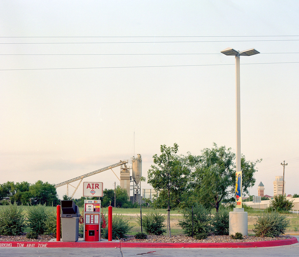

I picked up an RB67 after dealing with some older 6x6 cameras with horizontal cloth shutters. Frame exposure consistency issues were coming up a little to often, so I figured that I could do away with them by switching to a leaf shutter. The bump in format size was more than just a nice bonus, too.
I'm using a Pro-S, with 90mm f/3.8 C & 65mm f/4 K/L. I have been cropping out everything past the blue edges here -
But lately, in part because I'm so used to closely scrutinizing my scans for uneven exposure, I've started to notice something a little off in the color balance of the vertical edges of the negatives from the RB67.

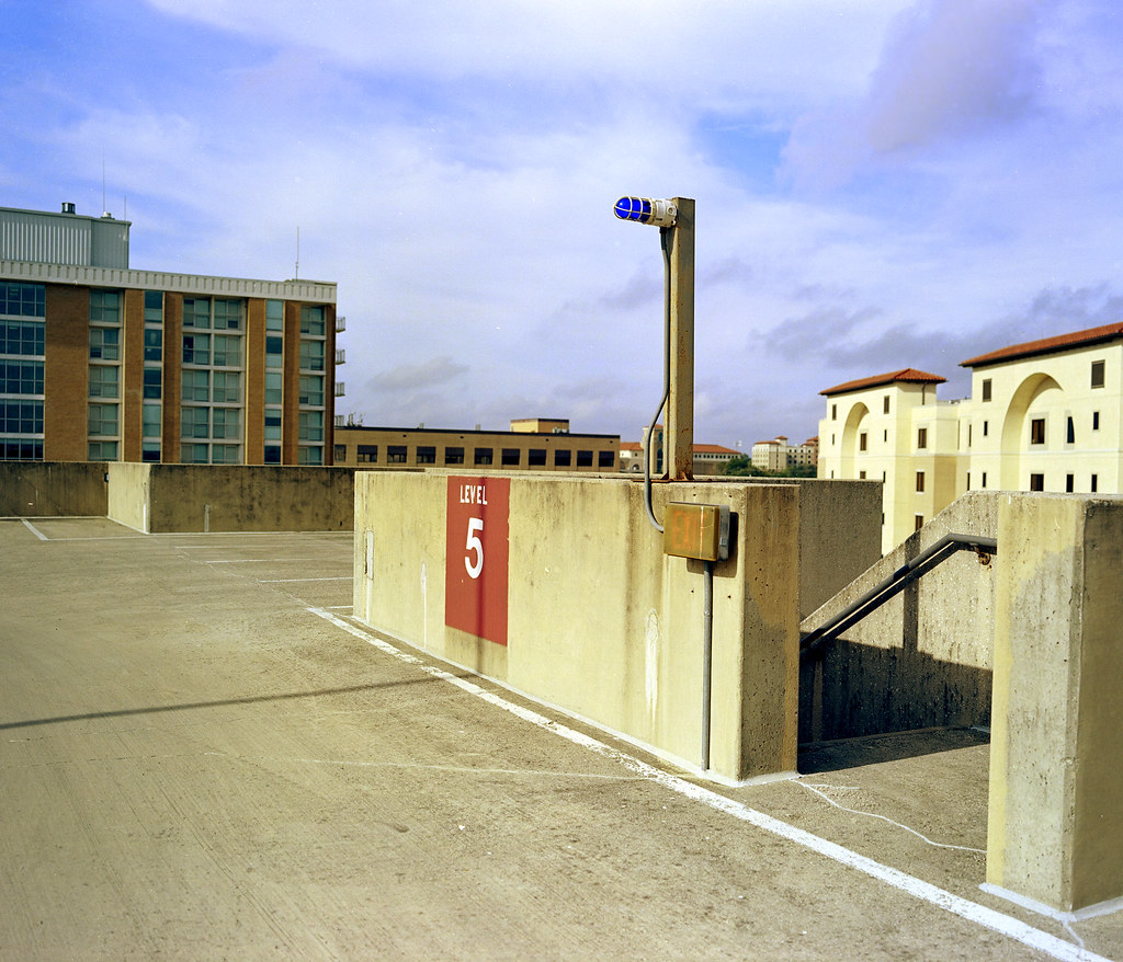

Now, this effect can be subtle, but hopefully this image illustrates what I'm trying to get at. Check out the color of the red fire lane curb stripe on the left. In reality, it should be the same color as the rest of the red paint -

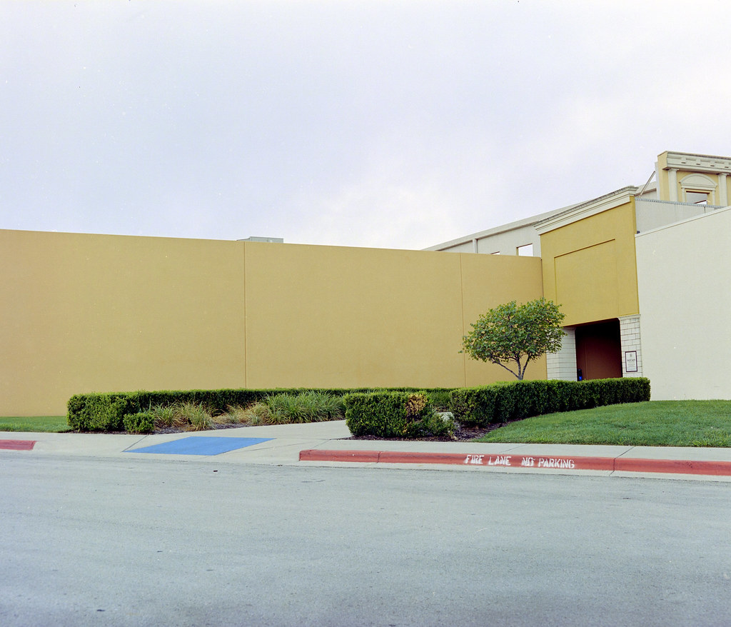

Here's another example. This time, it's on the right. Fire lane curbs do a good job of emphasizing the existence of whatever kind of problem this is. On other surfaces, like green grass, it's more subtle -
This effect isn't always apparent. Much of the time, it's basically invisible. And as you can see, the side that gets affected can change. That kind of makes me doubt that a light leak is the culprit, and I think there are fresh seals everywhere but around the mirror, but I guess there could be similar light leaks on both sides of the camera. That could cause the appearance of the aberration to occur on one side or the other, depending on the direction of the light source. Maybe light is getting in around the mirror?
It's not likely due to the lens shutters, I suppose?
Maybe an internal reflection of some sort? Flare? An optical issue with the lens elements?
I'm just not familiar with all the quirks of this camera yet, nor am I very good at diagnosing the causes of film aberrations.
One last question: does that blue crop line look correctly placed? I figure that the outer right and left sides show where the film curves away from the pressure plate, and therefore isn't perfectly flat, and should be cropped out.

I think that the change in hue is just the angle of the light and the effect it has on irregular surfaces that are extremely off axis.
And I print a fair percentage of my RB67 negatives full frame and am usually happy with the sharpness and resolution right at the edge of the image. AFAIK, the pressure plate is larger than that image area.
Neither of your lenses is a macro lens, so there will most likely be some curvature of field.

If this is produced by the lens, which i doubt, it would be produced by lens group separation (lens cement going bad). This creates a spot on a lens group, which will have different color balance.

A light leak of any kind or intensity will affect a larger area than a single color band that runs across the image such as the curb does in your examples. You will notice the density difference in the negative also.
If you still suspect your camera or lens then get some ISO 400 B&W film and shoot an evenly lit mid tone monotone wall with the camera square to the wall. It will show any flaws in exposure or development quickly. Be sure to meter the wall in a 6 or 9 cell grid of the area that will be captured on film to ensure the lighting is even.
Check your roll film holder for proper tensioning of the film by loading a scrap roll of film or the backing paper of a processed roll and advancing it through the holder verifying the tightness to the pressure plate on each frame. Low supply spool tension will allow the supply to unroll an extra amount per wind and be loose at the supply guide roller, too high tension will make winding harder. Check the pressure plate depth in a 9 cell grid to the holder shell's face, it should be the same at any point.
Always check the negative with a good loupe when trouble shooting problems. If its on the negative it should be in the print or scan, if its in the print or scan but not in the negative then its the enlarger, scanner, or printer at fault.

Lens performance limitations would be my first choice of explanation. It is the nature of a lens that the contrast and resolution performance is inferior at the edges compared to the center, this is quantifiable and is shown on charts of lens performance. Reduced contrast at the edges also reduces color saturation.

I agree that the effect is more apparent on the image of the store wall than it is on the image of the air pump station. Here, by really abusing the scan of the pump station, I can try to show if the aberration is covering any more of the frame:
... I've highlighted in yellow where I think you can see some hue shifts. The top right corner could be something else, but there's also a little bit of hue shift towards the bottom right, appearing on the highway wall.
Same camera, lens, and film. Here it's on the left again. The JPEG compression artifacts really make it obvious, I think. This time appearing darker:
And on the right. Grass shifting towards cyan..
All told, the examples I've posted came from three different rolls.
I wonder about light leaks, because if I fire the 'shutter' (which really just actuates the mirror/baffle assembly when there is no lens attached), then half-cock the return level it so that the mirror still sits flush against the bottom of the viewfinder, like so:
(I've heard that it's supposed to rest unevenly, maybe not that much though) .. but that the light baffle goes on back down, like so:
, then take it into the darkroom and shine a very bright LED into the lens throat or the viewfinder, I can see just a barely perceptible amount of light coming in through one side of the baffle to the film back. It's really very, very subtle illumination, but it's there.
Maybe it's just wishful thinking that there would be a light leak causing this issue. After all, the leak looks like it is on just one side, while the aberration can appear on either side. I'd much rather be able to fix the issue by upgrading to a Pro-SD body than replacing the expensive 65mm lens that I ordered from Japan.
