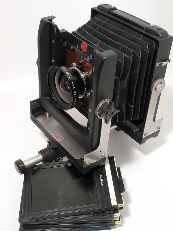

After more than sixty years with large format, one of the most useful and versatile cameras I have found is the Wide Angle version of the Calumet 400 Series. No recessed lens board needed for a 90mm and plenty of movements, the camera is (despite being a monorail) relatively compact and definitely inexpensive! I still have one which is my "go to" camera for architectural work. An inexpensive lens with adequate coverage for 5x7 which I find very useful is the older Fujinon 135mm f5.6 W (usually in Seiko shutter). This is the version with nomenclature on the bezel ring rather than on the lens barrel. The same series Fujinon in 90mm also has plenty of coverage, performs well and is available generally for less than $200. True, the camera is of limited use with lenses greater than 150mm but for the usage indicated by the OP I would recommend the WA Calumet 400 Series without hesitation!
