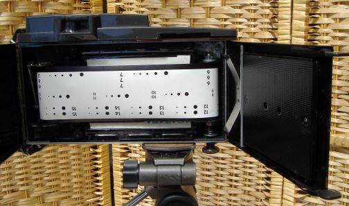

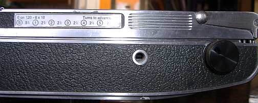

The old Polaroid rollfilm cameras can be converted too. I did a 160 as shown in the attached pictures. The conversion is fairly easy.
I currently have a 110A but I can't decide if I want to convert it to 120 or 5x4 yet.
These conversions are not quite as wide as the Kodak 3A conversions as the final image size is around 6 x 10.5cm
steve.
