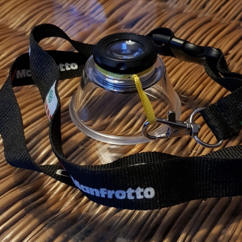

MattiS: What model is that one you pictured? What strength?
It‘s a Kaiser 10x magnifier, about 15€. I use it on my 4x5 Technica.

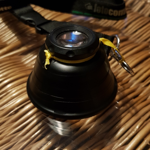

Loupes with a transparent base are usually for looking at prints and proof sheets. For groundglass viewing, you want an opaque base ideally. If you’re viewing under a darkcloth, it won’t make much difference, but it can make more of a difference if you are using a folding focusing hood.
Wrap some electrical tape around the transparent part and be a true punk photog...

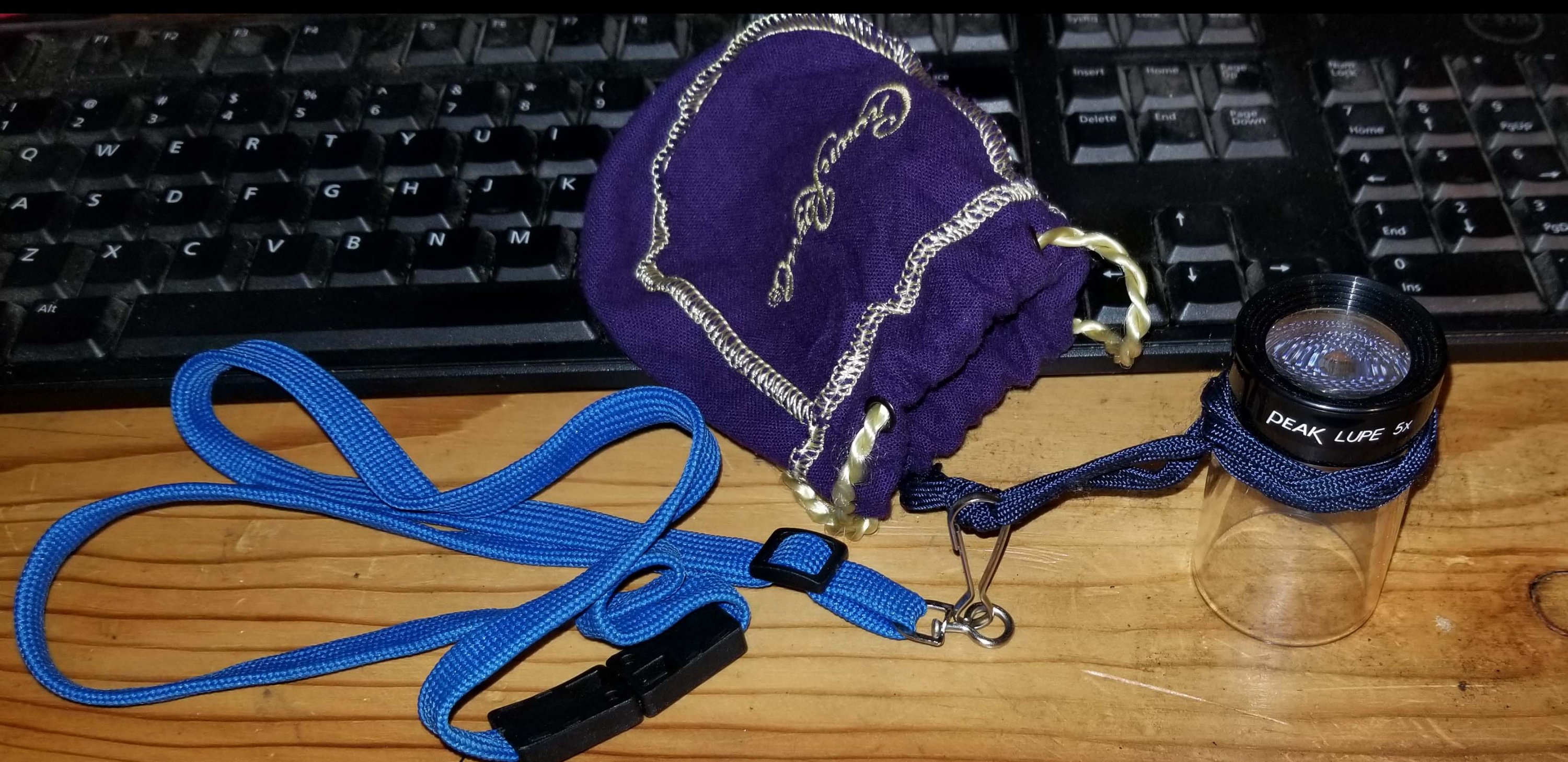

I did' but it isn't made with an attachment point. I just tied a turkshead knot on it and made a loop to hang it from a cheap ID card lanyard I picked up at wallyworld. and store it in a small Crown Royal bag.
