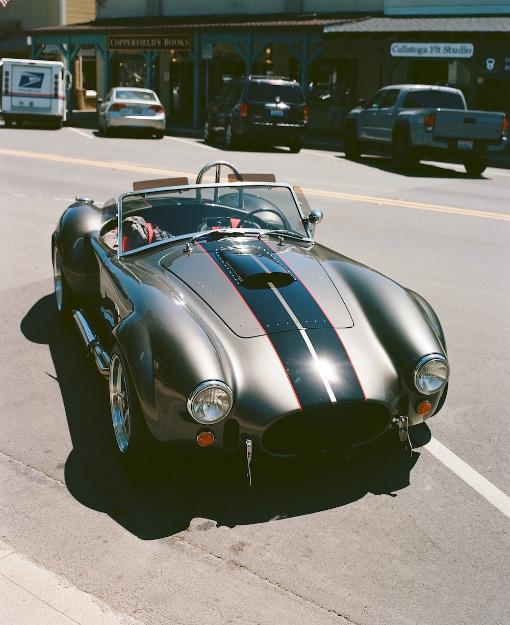

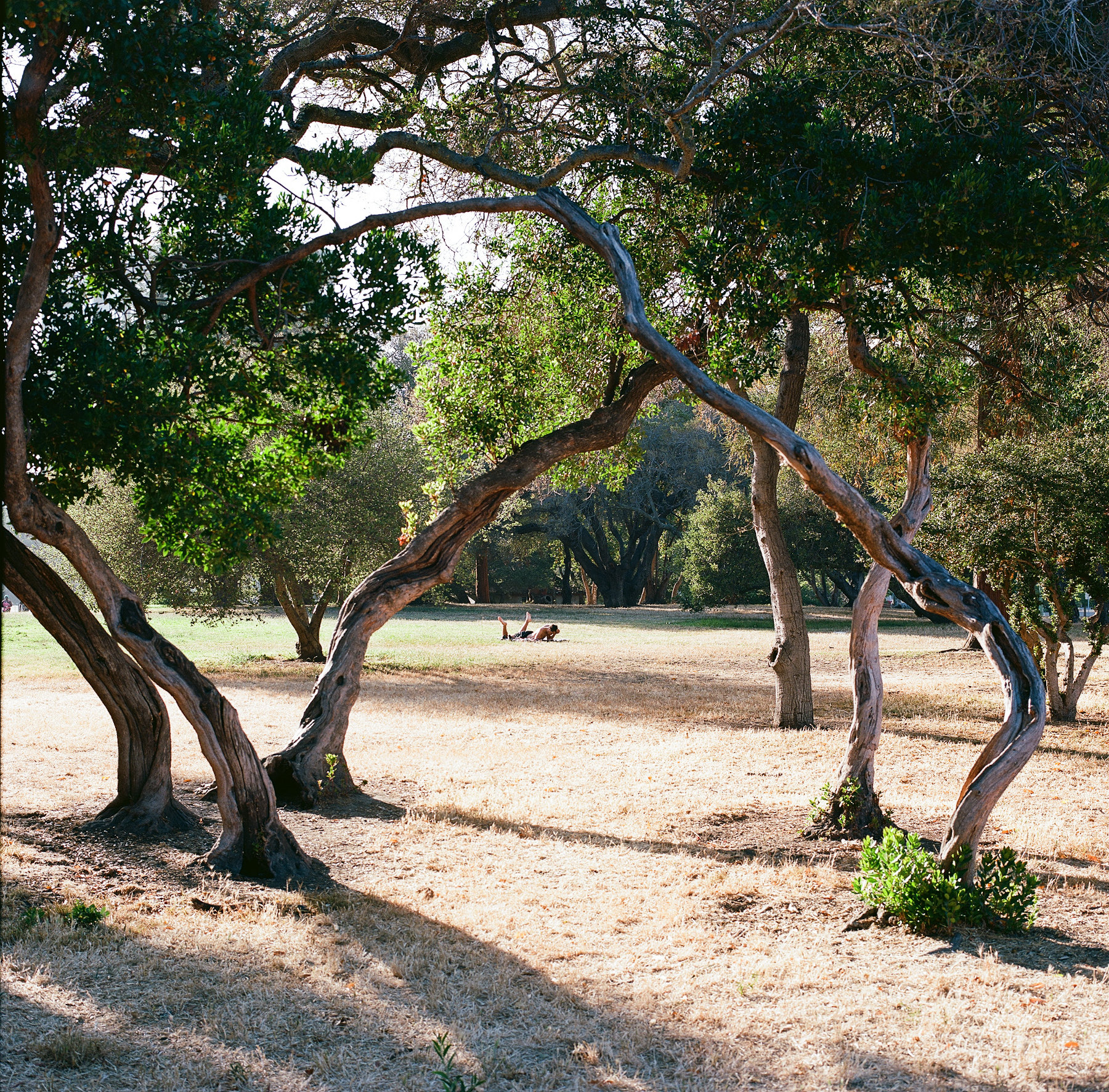

The car still has distinctly green shadows and very slightly magenta highlights, even to my rather accepting eye. The park has blue/cyan shadows, but that's to be expected in late day sunlight. I still see a hint of magenta in the hightlights on the tree trunks, so I suspect it's the same deal as with the car -- a magenta/green crossover shifting the blue shadows into cyan. Not so bad I'd be bothered by it if I saw it in a magazine or on a wall -- and it's just possible it's a difference in monitor calibration rather than a real crossover.

Thanks Bormental Your exposures times does not suggest to me a gross over exposure time but I have no knowledge of the latitude of Ektar 100 to overexposure. 1/125 @ f8 suggests at a little less than 2 stops over and 1/500th no overexposure at all, if I have understood the "sunny 16" rule. They certainly look better to my eye but that is largely incidental as it is your taste that counts. What is important for me is whether you negatives are OK in the sense of being capable of being printed under an enlarger to look like your second set of scans or have you had to do something with the scanning tools that has enabled you to correct the crossover that has been suggested is there?

@pentaxuser I have no way of knowing, since I have zero experience printing in color! :smile: Just recently I've added color film to my bag and, to be honest, I am still having difficulties evaluating negatives on the light table!
@Donald Qualls Agreed. By the way, the car's paint had a faint green tint to it in real life. I wish I had taken a digital photo as well.

Lachlan what should I be looking for in the above examples that demonstrates colour crossover.
The yellow cast that results from attempts to correct the colour shifts produced by the crossover, but because it's crossover, not an overall cast, this attempted correction throws the colour balance of other areas off too.
If Ektar is correctly exposed, it's near dead neutral but saturated.

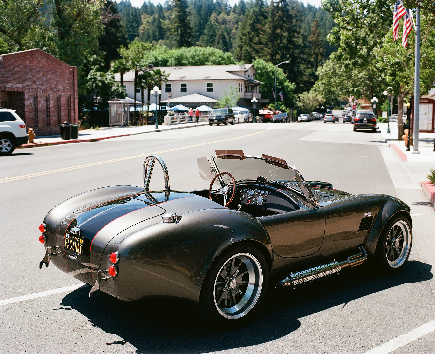

Lachlan, what do I need to look at to see the yellow cast and what has caused this, given it looks safe to assume that the Ektar negs were not grossly over-exposed and the development process was carried out as per C41 standard specs
Is a yellow cast the usual sign of crossover or just the sign of it in this scan? What has ensured that the middle picture of the car and house does not have a crossover or is this included in the yellow cast sign?

Lachlan has correctly expressed the dilemma. People try to correct for crossover by adjusting overall color balance afterwards, which just throws something else off. Crossover in Ektar generally goes cyan, so the steering wheel gets yanked the opposite direction (warm) afterwards, and potentially pulls the whole car off the road. Makes no difference whether we're talking about RA4 printing in a darkroom or digital reproduction. Either way, it's far easier to obtain "neutrality" using corrective filtration at the time of the shot if necessary, along with careful metering.

So if we go back to the scene in question, namely the green parked sportscar, where in this print do I need to look for the signs of colour crossover that are apparent there? Equally importantly what might be the cause and what might the OP have done in the middle shot( the car on a drive with a house) to have achieved a pic with no crossover unless there is also crossover here as well. In which case what do I need to look for here that says "crossover "
Clearly the OP has a different outlook on what he wants from a colour negative from what I'd want but this is largely irrelevant to the discussion on crossover but he appears to have answered honestly in terms of his exposure which doesn't seem to be much over-exposed and we know that his negs were commercially processed at what I assume to be standard C41 processing.
I think we may have sourced one of the problems.
I believe that car isn't green - it is grey.
If you are seeing a green car, it is unlikely that is either a result of a problem with your monitor calibration, or the effects of crossover.
I don't see any clear indications of crossover in the uploaded version of this image - exposure seems to be good, and the scan appears good as well - at least as far as we can see here.
The most obvious signs of crossover are in the highlighted grass in the scene with the field and the arch of trees. The crossover makes that grass look like frost because of the cyan hue, rather than dried brown.
