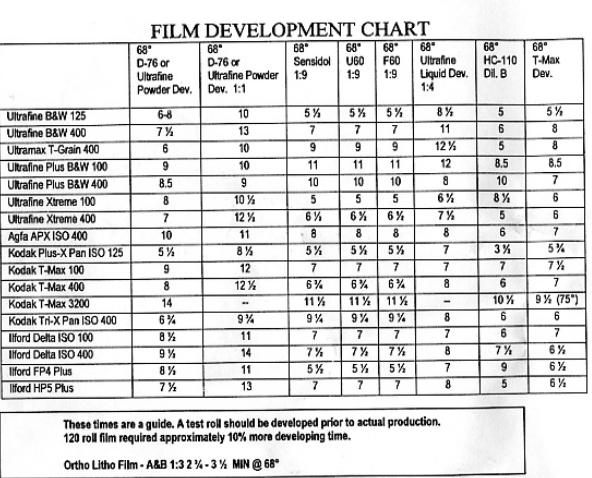

Here a more complete chart where Ultrafine Plus 100 times are included. Click on the image to enlarge it:
Personally, I don't find that Ultrafine Plus 100 has that much of that purple base. On contrary, I find the base quite grey or transparent, although it curls quite a lot.
Did try to develop the film with Rodinal 1:100 (14 min at 68 F) - according to the Mass. Chart - and it looks like it ain't enough.

I checked the times for Ultrafine Plus 100, and they don't match with Lucky. But I can't think of any other film it might be. The film I'm using can't be Foma, the base is almost completely clear, no blue tint. It can't be Shanghai GP3 because it doesn't have an anti-halation layer on the base side of the film. Lucky is the only film that has the same basic characteristics. The times didn't match, but I had to use two different charts. Different charts might have different times for the same film and developer combination.
I did check out times and neither Lucky or Foma match.
Personally, I use HC-110 dil. B 10 min at 20C and the results are just fine. This time dev. isn't even recommanded by Ultrafin Online.
