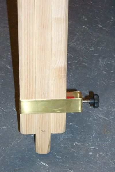

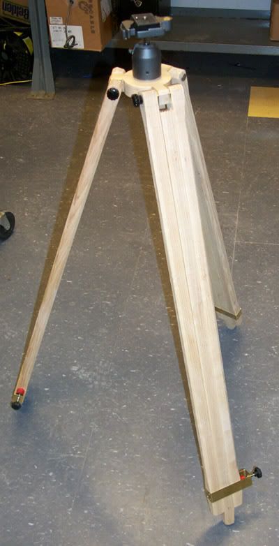

Many months ago I said I was going to make a tripod, and just so you don't think that I was more talk than action, I've finally made some headway on this project:

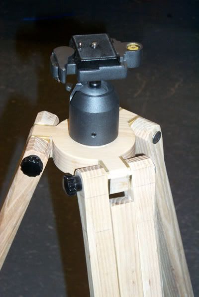

In all it's naked beauty. I still have a bunch of sanding to do, and then throw on some PolyUrethane. I also need to make some kind of spreader to keep the legs from slipping out when it's loaded. Notice the ball head made of the cheapest possible materials that mankind can create. I don't think that head will last very long before I trash it. The ball isn't even chromed or hardened so it is wearing against the rest of the head as I move it. Aluminum on aluminum, not pretty.
The only problem I'm having right now is that I don't have enough friction at the leg locks. Hopefully the Urethane will help to make it grab a little better.
The lumber was extremely easy to work with. Very straight, very smooth right from the beginning. This came from http://www.hardwoodstore.com/lumber.html and was surfaced on 4 sides to my specific dimensions. If I was to do it all again I would probably go for 3/4 inch squares as opposed to the 1 inch squares that I used. Cost was very low for the lumber, and the other metal and screws not too bad either. I'll update this when I get it semi-finished.

Did you have any problems getting enough friction from the leg lock? That's about the only thing that may cause a serious delay on mine. I'm going to test putting some urethane on the inner surfaces today and see what happens.

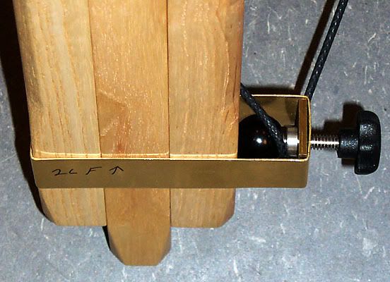

I found the problem. The red hard urethane feet that I was using to press the legs together was causing too much rotational friction, so I couldn't get it to tighten down enough. I just changed them to a spherical plastic knob and now I can apply more pressure than the thin brass will handle. So I need to solder in some thicker brass at the forcing nut, which is something I though I would need to do anyway.
Now I have some nice red urethane feet for the bottom of the legs.

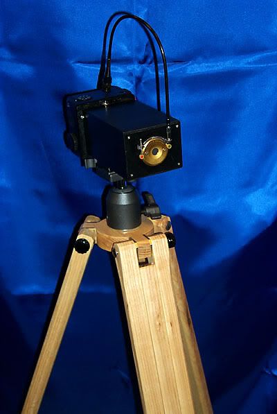

This project came about because I need something more stable for the pinhole camera that I built. So I kind of started the other way around.

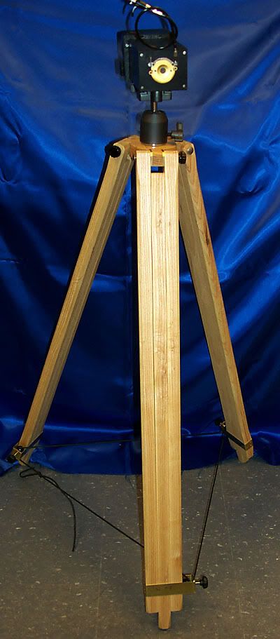

And while I'm here, I have a few new pictures of mine, now that it is in a semi functional state. Still a lot of work to be done, sanding and more coats of polyurethane. And better spreader. Cut the extra off of all the bolts so that everything has a cleaner look. Things like that.

Greg, you were posting at the same time as me again! Man is that strange or what??!! Thanks for puting up my link. I like the way your tripod is coming together. Nice idea on controling the leg spread! I still have to mount my bubble levels on mine. I like the pinhole. Very nice build quality! Keep up the great work. Are you into building something bigger? I'm stopping at 8x20, of course a pinhole would be nice!!! It never ends!!! I am obsessed!!!!

Bigger is not likely. It's too hard to get processed right now. I may make a 6x6 or 6x7 pinhole in the future, but that may be the end. At some point I will definitely make another tripod in the exact same design with 18 inch legs. That way I can interchange the parts. I'm not really happy with the ball head, I may look into building my own, or replacing the cheap ball with something better.
Also the cheapo head I bought has a bubble level on it, so I don't need to worry so much about the platform being level. Of course that would be difficult with that big geared head that you have.
I think I am going to modify this design a little bit. I think I'm going to put some brass on the upper part of the legs where the bolt goes so that there is something a little stronger for the bolt and knob to push against. The big thing is that now I have it functional, so all the other stuff can come when it does.
