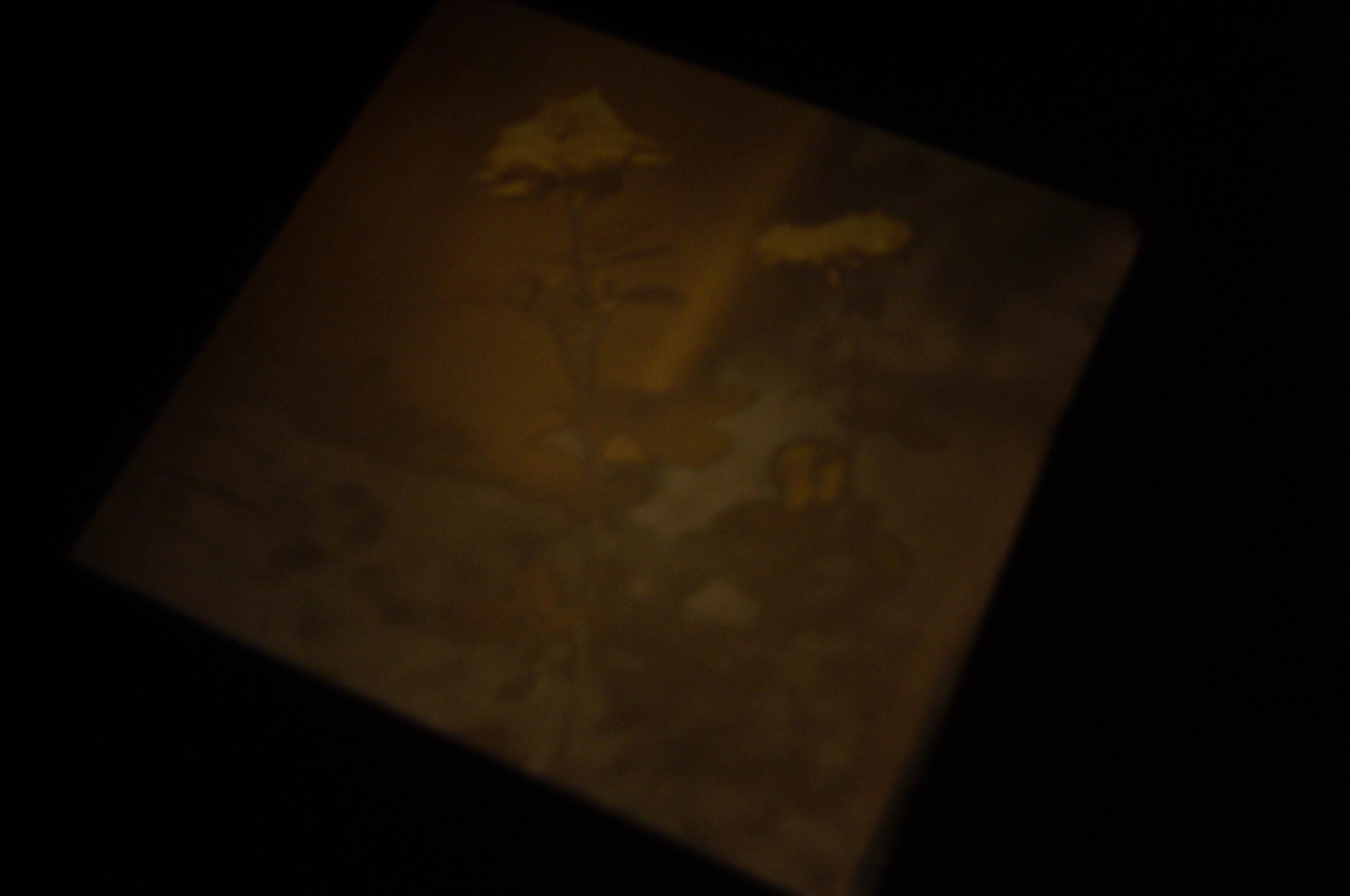

So I've been basement developing/printing for about a year now (and lurking in the shadows at apug for tips and tricks) and this is the first time I've ever had this issue, considering I have a fairly cheap Omega B600 condenser enlarger.
I'm trying to print 120mm negatives and keep getting the positive shown on the easel. It's frustrating. 35mm film negs show up fine as does an older roll of 120mm I'd shot a few months ago. The only thing I've done differently is developed with Rodinal. I've never used it before, so I couldn't decide if there's something in Rodinal that could be reflecting the light somehow? (I know that sounds like a stretch, but when the enlarger appears in working order, I had to factor in anything new to my process.)
The film is PanF+, and the negs look fantastic, but I just can't get them to print correctly. Has anyone ever had this issue?

Exactly right. So somehow the negative is being reversed and shown as a positive when I lay my easel and paper down, resulting in the exact opposite of what it should be doing. (It's strange to try to explain, I'm sorry) :/

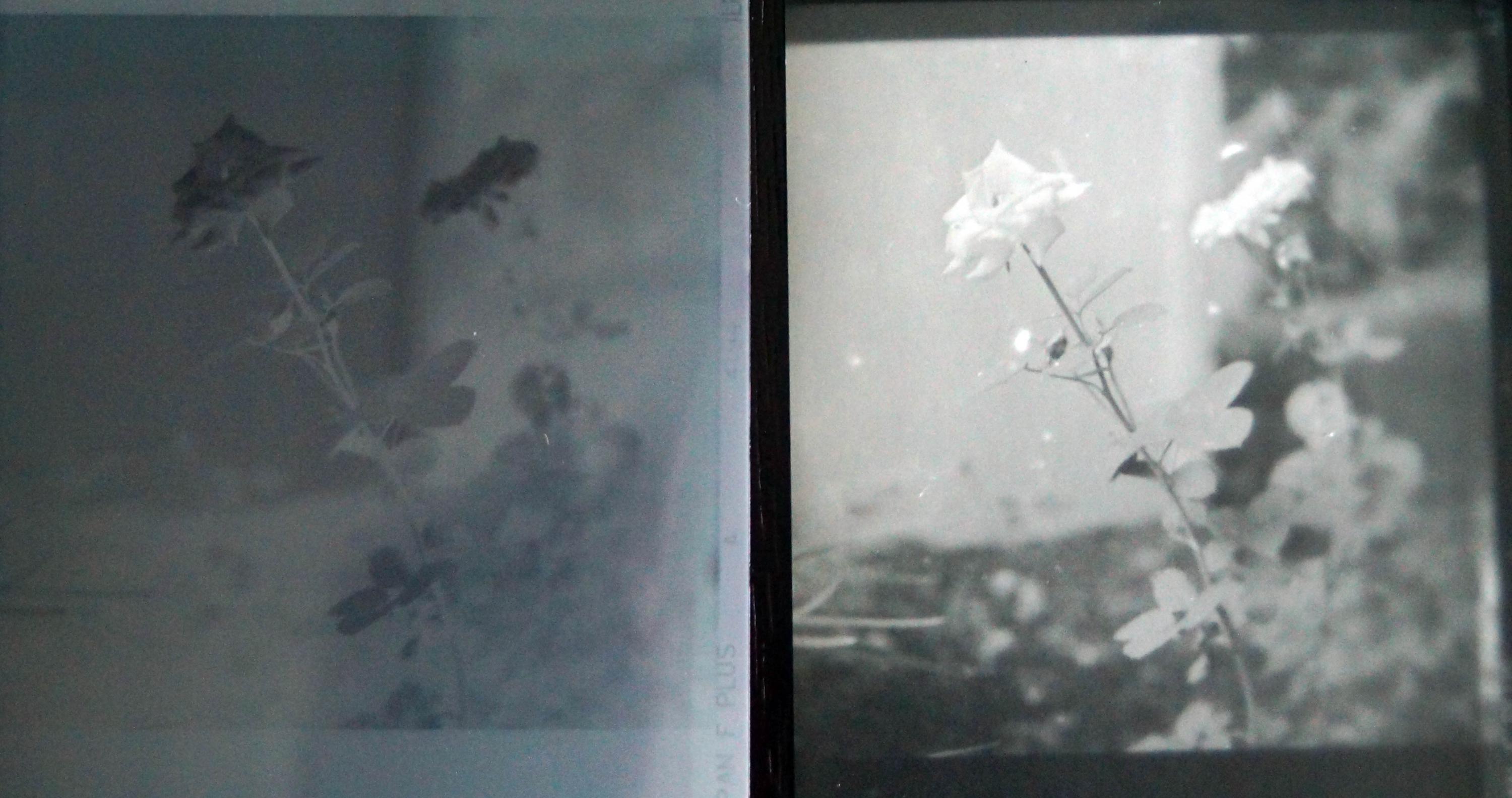

This might not be big enough to tell...The negative on the left (my reflection off the glass in the middle--sorry) and the contact print on the right. I guess if it were an exhausted fix, would I be able to tell in the negative? To me the negs look normal, though this one isn't great, I thought with the whiteness of the flower, I could at least be able to compare the negative to the positive of the contact print.
--After my darkroom session earlier, I dumped the fix just in case. Will make a new one next chance I get to develop.

So..the photo on the left is the negative, and on the right is a print? If this is correct, you have no problem. The negative does appear to be a bit cloudy though. No offense intended here, but you need to clean up your act and develop some proper methods and good house keeping. I can't stress enough how important cleanliness and a solid method is when "darkrooming". The only place where I am "OCD" is my darkroom.

The one on the right is from the contact print. When lying down on the sheet of paper, the negative is fine and creates a positive for the contact sheet. When the negative is placed in the negative holder and placed in my enlarger, the negative then creates a positive resulting in a negative full sized print. So, instead of having the negative image on my easel for the enlargement print, it shows the positive, allowing the light to expose opposite of what it should be doing for a regular print.

I've never experienced the problem you are having, but do you have a scan of the "negative" print that you made? That might help us out in helping you out. Your neg looks like a neg so I don't think it's the fixer. In any event, it's an interesting riddle.

hi, thanks for the uploads !
hmmm
you might put your film in fresh fix and agitate and rewash them.
it looks ( maybe i am misreading your film ? ) like your negatives might
not be completely cleared .. if that is the case re-fixing and rewashing might help you ...
not sure how you monitor your fixer to see if it is still fresh, or what "brand" of fix you use
or if you mix your own tsp of thiosulfate and water ... or the dilution ...
but a good indicator can be the age old "clip test"
matt explains it here ... (there was a url link here which no longer exists)
also, not sure if you agitate your film in your fixer or let it sit ... but you are supposed to agitate it the same way you agitate in developer ...

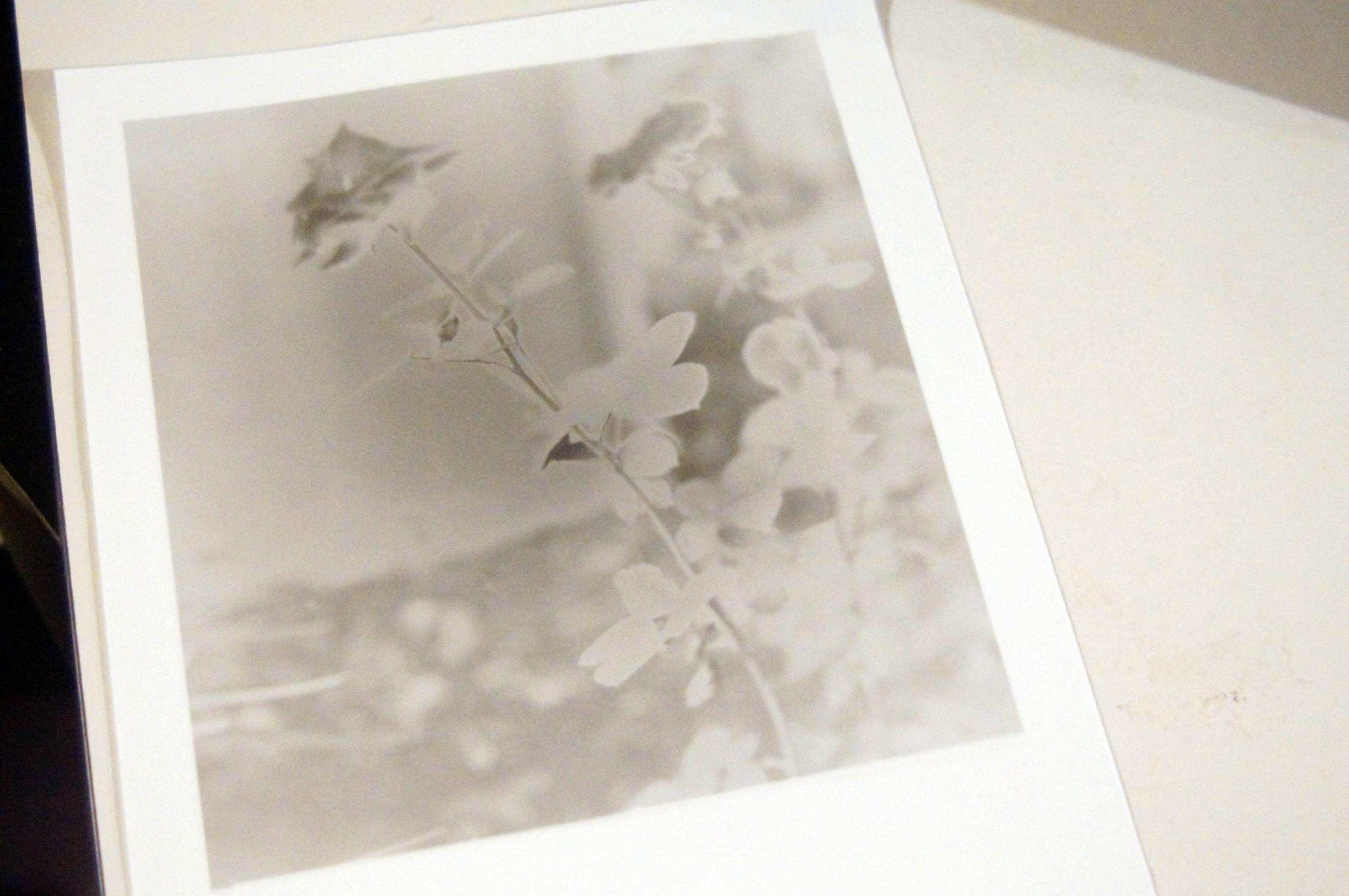

attachment.php
attachment.php
So, on the left is the print I get when placing the negative in the holder and into the enlarger (earlier I had posted a photo of just the contact print of that negative, which would lie on the paper with glass on top; this look fine). The right is my attempt at trying to show how the negative is in fact a positive through the light of the enlarger. Both aren't the best :smile: but the negative was posted previously and appears to be okay, but here is what I get when placed in the enlarger. It's a condenser head with two condensers just bellow the lamp. It's the Omega B600. It makes me wonder if I'm supposed to be adjusting the condensers, but I feel I'd have light issues around the corners of the 6x6 neg, which I haven't. *I also would have found any instructions in the manual, but it never mentions adjusting condensers.
I use a 75mm lens as well, which, again, covers the medium format negative.
I've gone through my methods, and actually just put through a roll of 120mm film developed months ago that appeared fine through the enlarger.
The two rolls of film that give a positive through the enlarger are PanF+ and FP4+, both developed in Rodinal (which I used for the first time when developing these rolls).
There must be something I'm missing...

Thanks, John! I think I'll do as you suggest and re-fix and wash. I do agitate fix just as I do developer, so I'm thinking the fix has been exhausted (as am I after spending my day off with this problem) :smile:

In the picture of the image on the enlarging easel, it looks coloured ... is that an artefact of the digital photograph or are you trying to enlarge a colour negative onto b&w paper?

@Trask and @John, verdict is in, just re-fixed and washed a bit of the roll in new fresh fix and the image is back to normal in the enlarger! Thank you for the help! I can't believe that using exhausted fix would actually cause the image in invert...what a strange day it has been.

--Pdeeh, I believe it's from the digital image. I also used no filters so it would be a little more clear.

I can't believe that using exhausted fix would actually cause the image in invert)
well, if you give it a bit of thought, fixer removes the remaining unexposed silver halides in a film. If your fixer is "exhausted" it won;t do that properly, so some of the remaining latent image will be there, and may have fogged over time. Hence you could end up with a partially reversed image.

Thanks, pdeeh! I understood fixer's main goal, but just couldn't process how it'd give me the positive image that it did through the enlarger. It does make sense now that I've had the issue and really had to think it through :smile: usually my mistakes are easy fixes, or at least easy to figure out. :smile: I think film as hobby means patience, practice, and learning at all times!
