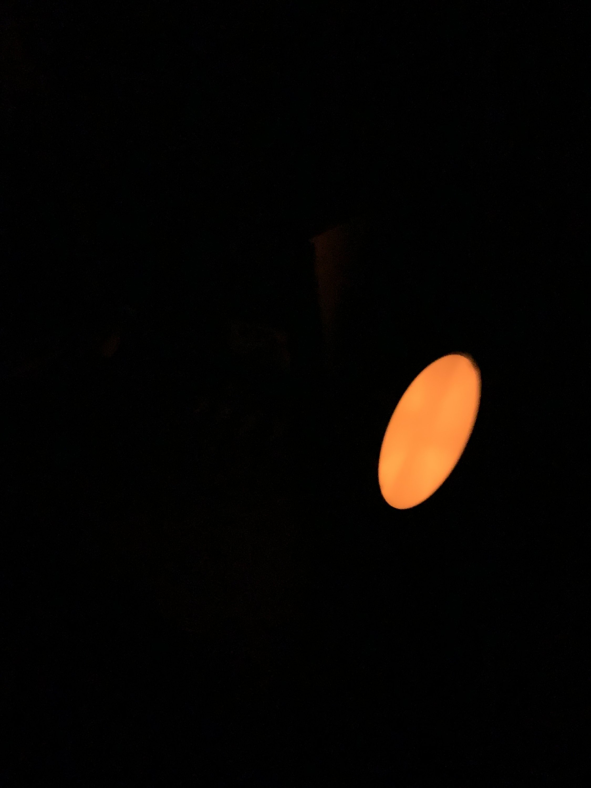

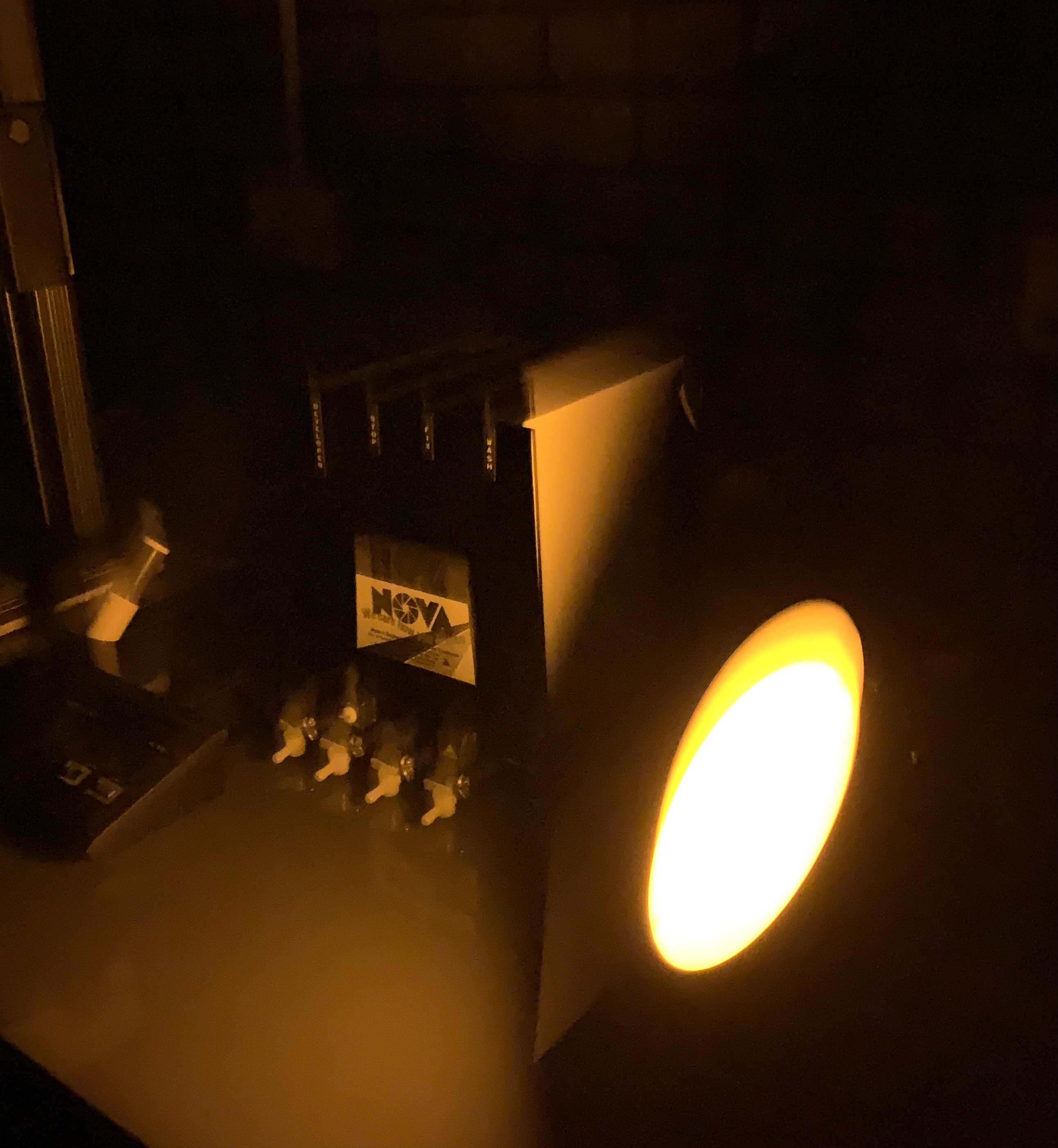

Update. So I have my duka 10 and heres 2 images of it in my dark room. First is at 0 on the dial and the second is max 35 (next comment)

Robbie
Mar 8, 2022
81
Glasgow
Maximum

The trick is to use your Duka at the lowest setting at which you can see to get around and process a print. I'd try a setting of between 5 and 10 initially and wait a few minutes before starting the print process. It is amazing how much the eyes get used to a low setting once they have adapted over a few minutes. Here I am talking about RA4 colour prints. It is possible to print b&w at much higher settings

So the higher settings, is that okay for black and white? I’ll try between 5-10 for colour. Yeah I definitely noticed my eyes adapting to the dark so that little bit of light definitely helps

Well I need to add a caveat which is that I only used the DUKA on a couple of occasions for b&W prints in the distant past but I have certainly seem other users of the DUKA say that full illumination or close to full is OK. Maybe one of those users of a DUKA for b&w will confirm my statement.
The reason why I decided to stop using the DUKA for b&w is that it may be "wasting " the sodium bulb unnecessarily. I think that other than buying another DUKA each time a bulb goes there is little chance of finding replacement bulbs these days unless someone here know differently.

Yeah you're totally right. I think, for that reason, I'll get a dedicated b&w safelight.
