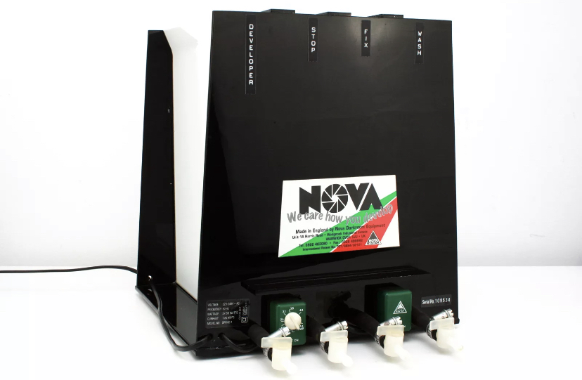

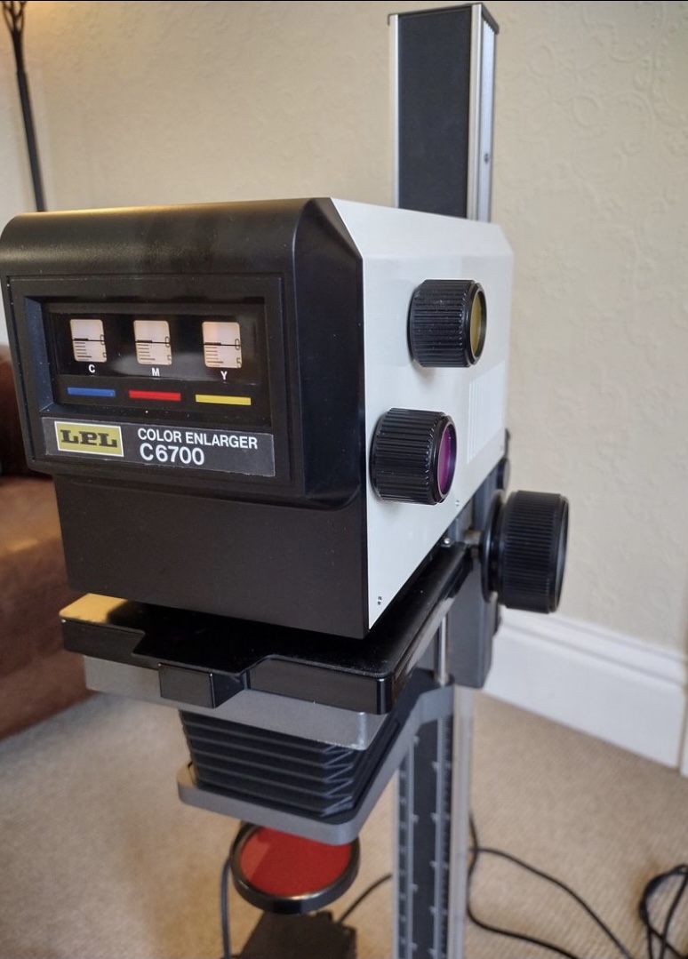

Hi, I’m still new to photography (started last year at the age of 37 and since left my job to study it). I learned on film because I didn’t have a laptop and could afford a dslr. I now shoot 6x7 medium format and I’m about to move house and will have space for a dedicated darkroom because I’m dying to learn how to print. I have got myself an LPL colour enlarger and a NOVA quad stand processor as well as a couple other bits. I have a friend who’s going to teach me the enlarger side because they’ve done that working in london but they use processing machines that they done have to worry about the chemicals so he’s clueless on that front. I’ve just got myself a Bellini RA4 kit, that comes with developer, blix and stabiliser, will that be enough or do I need a stop bath too? Also, are there any colour safe lights that work, I’m pretty sure I’ll trip over something in 100% darkness. Any help/advice is massively appreciated.

I never tried a slot processor, but I do RA4 in unheated trays and it works fine. So I don't doubt you can make the Nova work as well.
Stop bath is a good idea; simple cleaning vinegar diluted 1+5 or so with tap water is just fine for this. Get the unscented kind that is the cheapest.
As to safe lights, I have recently started to use 600nm led strips at a very dim setting and this seems to work quite well. Previously I worked in a pitch dark room and it's surprisingly easy; I never tripped, hurt myself or knocked anything over. You can use small glow in the dark stickers (pointed away from any spot where they might face the paper!) as 'beacons' to mark e.g. the corner of a table etc.
Good luck, and don't overthink it; this is easier than you may think.
