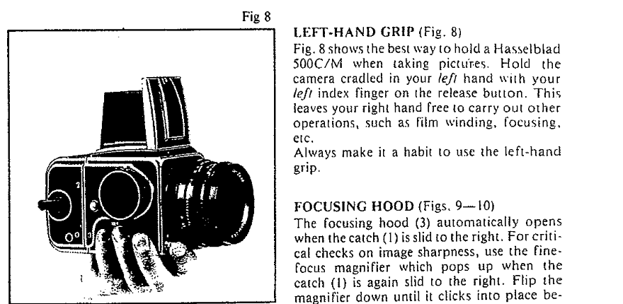

My mistake. I meant righ-handed/right-eye dominant.
But don't we simply hold the Blad in our right hand and the left hand has to "pull the trigger"? I'm left-handed, right-eye dominant, and I love the Blad, for many reasons, but this one, too.
Sounds awkward to me. If I hold the camera in my right hand, I would have to cross the other hand over to fire the shutter. I usually use my right hand to hold any camera and trip the shutter, using my left hand to focus and steady the camera. I am left handed and left-eye dominant.
I'm wrong! I don't do it that way. I follow directions. Lefty all the way.
I am left handed but that does not make a difference with the Hasselblad. I hold the camera in my left hand and focus and adjust with my right hand.
Plainly super awkward way to do it, but Hasselblad knows a fix for every person out there, no matter how unnatural it may be to many of them. With shown hold, right hand moves over left hand in order to focus ... only on a moon this is best. Makes me wonder if Hasselblad actually handled own cameras and came up with that. Or was it on TikTok first.
