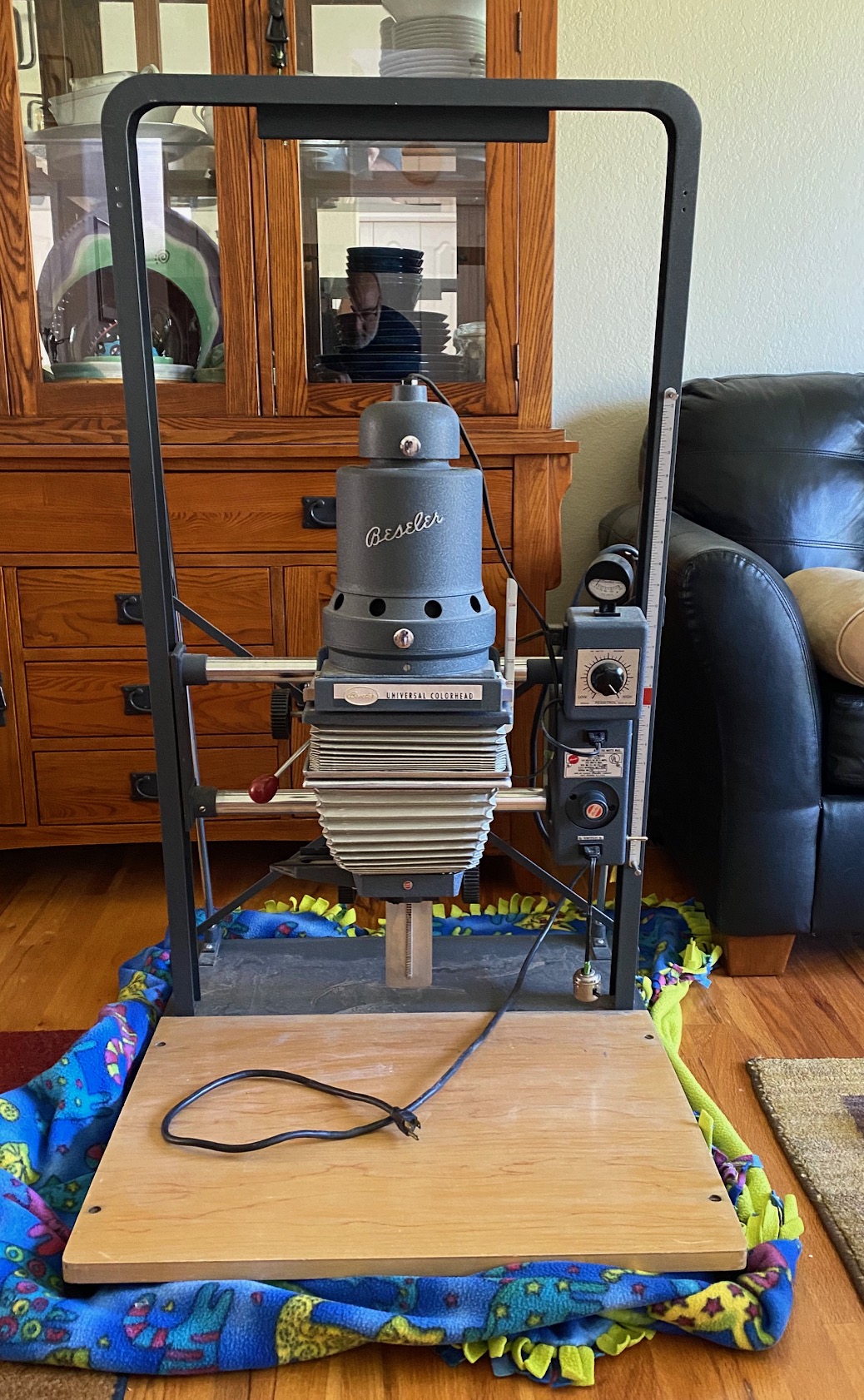

Just picked this up as a freebie. It appears to have all the accessories, except for the 6x9cm carrier. Unfortunately, no lenses. It has two sets of Ilford Multigrade filters (6x6" and 3.5x3.5") and several lens boards. It would fit in my darkroom, but I'd have to take out my 67C XL and I'm not sure I want to do that because I use the color head for diffusion and MG filtration. The baseboard is 31" deep so it would protrude 9" over the counter top. The only lens I really need to find is 135mm that covers 4x5", but I also need to get a 50mm because I appear to have lost my f/2.8 El Nikkor during the move into my new home a couple years ago.

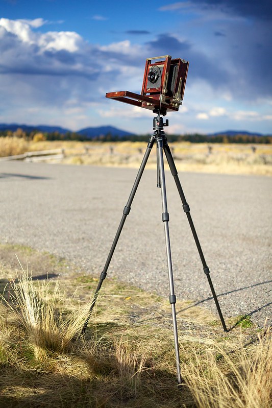

I have a Korona 4x5 field camera (c. 1890-1915) that I use with modern lenses. Until now, I've scanned the negatives and transparencies on an Epson V700 (and will continue to scan color). I suspect I'll keep the 45MCRX in a room next to my darkroom and set it up when I want to do 4x5 printing. Otherwise, I'll keep the 67C XL for the majority of my B&W printing. It's really a great enlarger.

I bought one like that in 1974, in the hip Beseler blue. I sold the original but I have 4 somewhat newer (no better). There's absolutely nothing wrong with the condenser head. You would need to use lower numbered contrast filters.
Theres two filter drawers on that beast. The one in the "Universal Colorhead" that you will need to cut the 6x6 filters to fit the round part, the smaller and very handy drawer is right above the lens that is usually used for a dark red not so safe safelight filter to check focus. Beseler, used to sell years ago, polycontrast filters, in a set. If you are happy with your nice 6x7 setup that's fine. But don't get rid of the 4x5.
The carriers are common but a lot have been recycled. I have a Zone VI VC light source and an (absolutely essential with any coldlight) compensating timer, mine is a Metrolux II. I found the head for less than 200, a steal. You can look for a Beseler dichro head but they have issues, they can ge fixed. The only thing for absolutely sure is that good old condenser head, and just putting a round piece of ground or frosted glass will make it diffuse.
I have an older MCRX too with a Zone VI cold light with Zone VI voltage stabilizer. I find it easier to use variable contrast filters under the lens myself especially if your split grade printing.
Congrats on your acquisition...its a great enlarger. If I still had the condenser version, I would still use under the lens filters...I don't notice any degradation. Also you have the rheostat to control light output...that will help with today's fast paper speeds. You do need to use that short corded on/off switch in order to use it...don't misplace it.

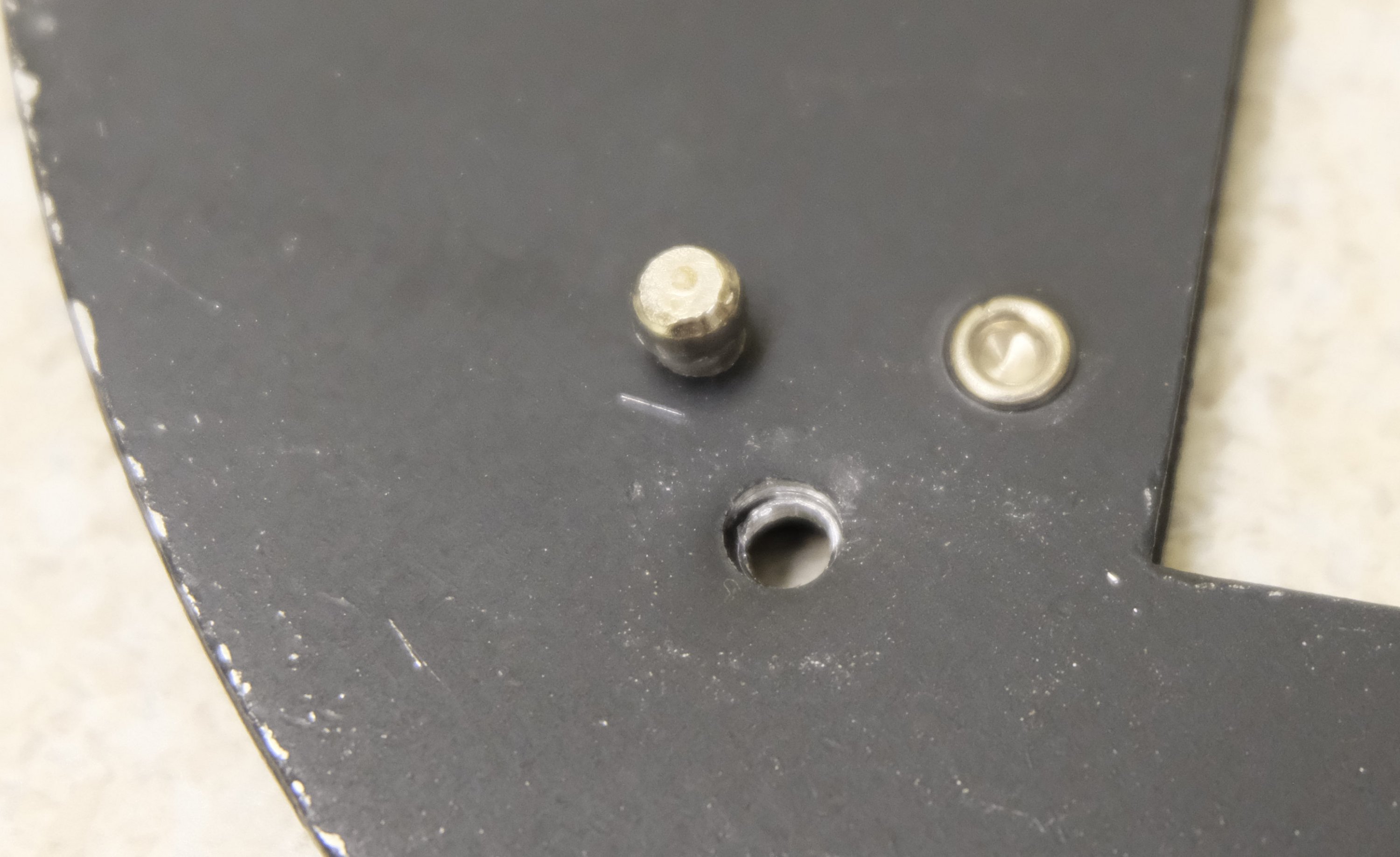

OK, I'm learning a bit about this enlarger. The first carrier I tried was the 4x5 and it turns out the pins that lock it in the stage are flattened so it won't self-center in the enlarger. I thought I could use my countersink punch to gently move them down, but sure enough the first one I tried promptly ended up on the floor. Fortunately, I found it, but now the question is, how do I get these 4 pins back to where they belong? Is there a good way of securing them in the carrier (e.g. epoxy)? Luckily, the other 4 carriers do not have this problem.

Regarding the pins: If the pins are flattened (vertically compressed), you might try filing down their sides some with a flat jeweller's file.

flat head screw of proper diameter & length threaded into place.

And thanks for the tip on the screw. I'll take the carrier to my local hardware store and identify 4 suitable machine screws to get it back in good working order.
There's 4 pins that center the carrier, and 4 pins that center the negative when you open the carrier. The 4 pins for the negative are flush. I would find one that was intact, you can center the carrier without the pins.

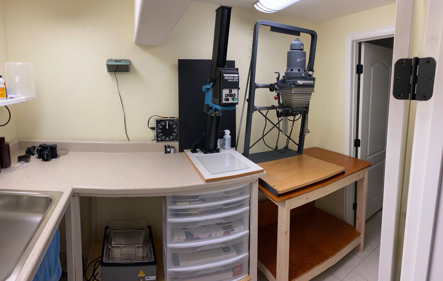

OK, table built, enlarger installed! It is now super cramped in my darkroom. I need to run a 110V line but for now it's functional.

So, I've started making some prints with this beast and I have to say, taming the contrast is quite a bit more challenging then with my 67C-XL with dichroic diffuser head.
