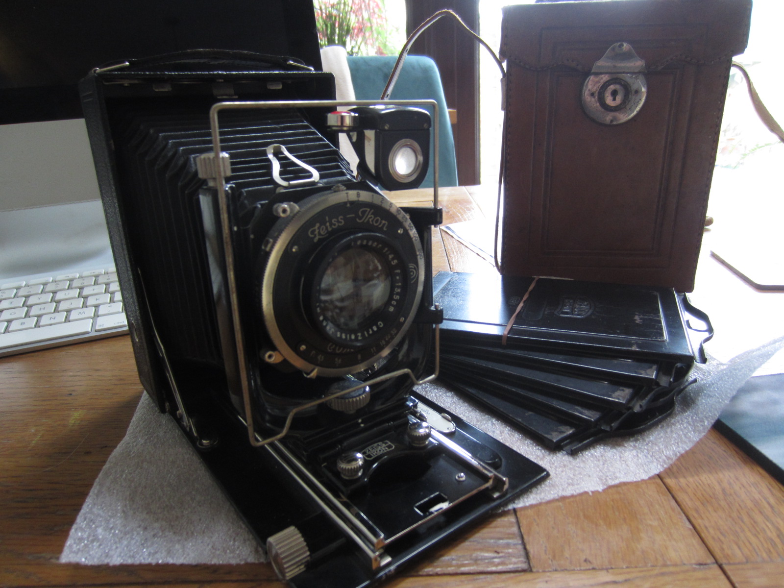

I've recently acquired a ZI Donata 227/7 that came with 665/7 plate holders.
Based on serial numbers (lens & shutter) I age it at 1930. The overall condition is pretty good really.
The shutter appears to operate correctly. Pleasingly the slowest speeds have no deviations, working at a uniform speed until complete.
The self-timer is a bit iffy, operating erratically and often failing to operate.
The lens is free from fungus, hazing, bits etc. But would benefit a clean.
Shutter/apeture blades overall good.
The ground glass is intact and looks OK. I've given it a gentle clean, which took some muck off.
The viewing hood is in good condition. Internally as new, no damage and ground-glass image is bright enough.
I have seen a guy selling fresnel lenses on ebay for 9x12. Is it worth fitting one of these as an upgrade?
I don't think the camera has been worked hard in it's approx 95 years of age.

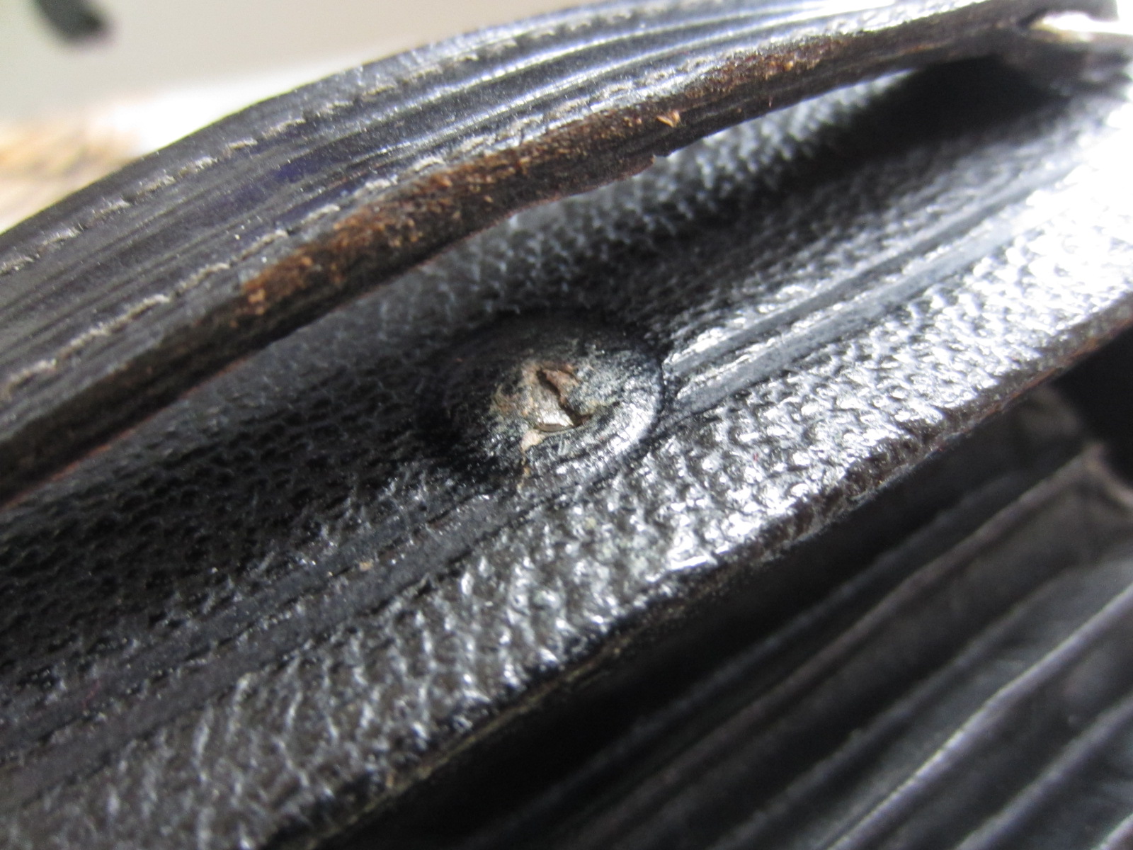

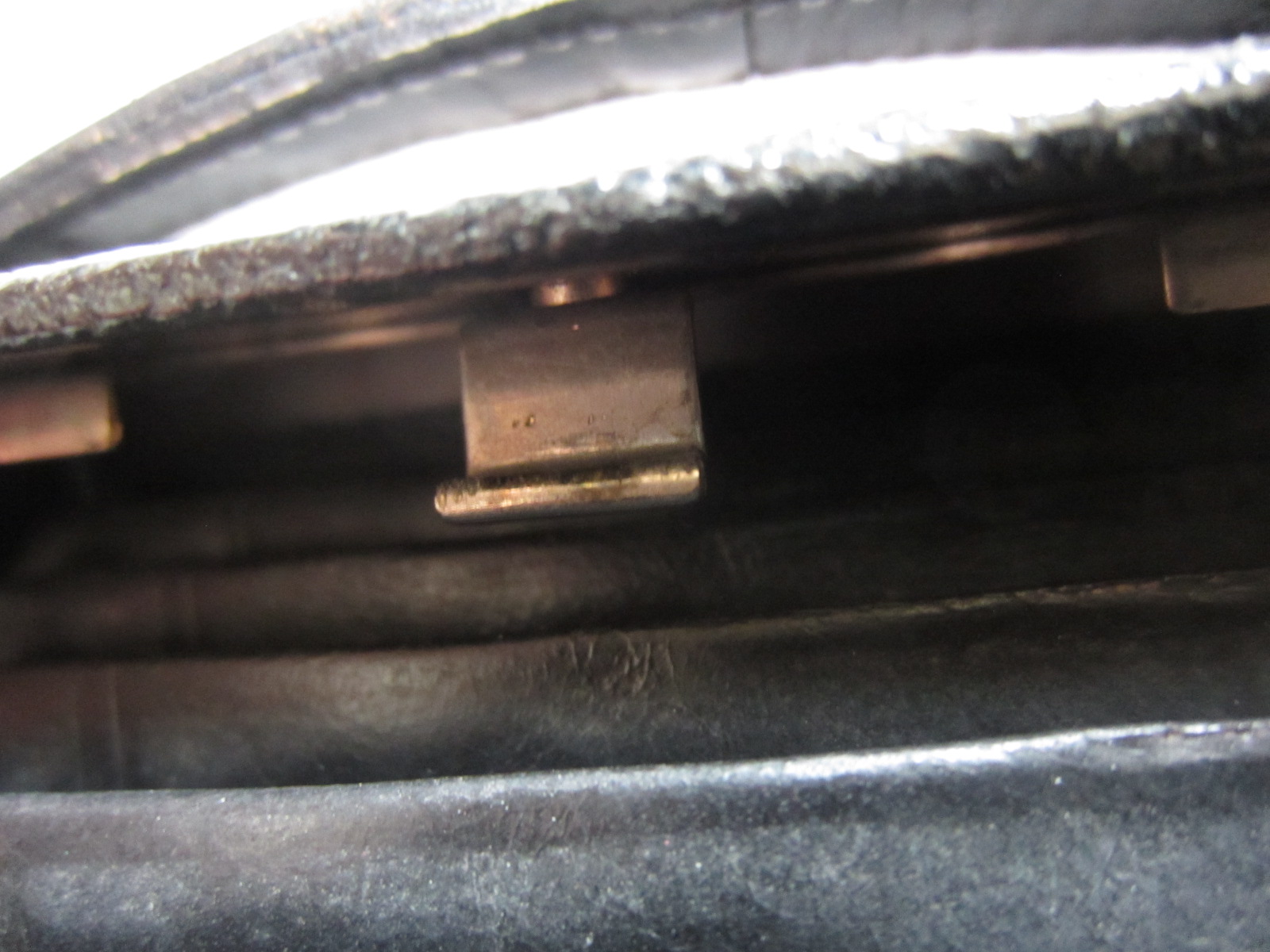

Worst part of the camera is the release button. The leather is damaged around it.
what appears to have happened is that over the years, possibly the bed has been retracted too far?
Leading to the sprung-catch being forced lower, beyond it's capabilty to return properly.
Over time this has 'lowered' the button, necessitating having to press it lower to release. Exacerbating the whole affair?
I suspect something has been used other than a finger tip to open: A pen-nib, a key, something 'pointy'.
I can minimise the 'latching', by reducing how much the bed is geared-back allowing finger operation, just about.
But this results in the bed on ocassion popping open on it's own.
Latched properly, I need to use a pointed implement to open the camera. It can't be done with a finger, not mine anyway?
That sprung-catch should sit flush against the inner-top. So the button protrudes enough for finger-opening.
I susepct this is a common problem with these?
This may have contributed to it's limited use?
I'm thinking how I can recitfy this? I don't want to attempt to strip back the camera to allow the catch to be removed and corrected?
I'll likely ruin the camera trying that, it'd never be the same?
What I'm thinking is carefully cut out the circle of leather around the button-opening, exposing it all. And the hole the button sits in.
machine a small stainless steel ferrule, to act as a collar around the opening, tidying it up. Then machine a small stainless button and silicon it to the top of the existing button.
Effectively 'extending' it, to allow finger operation and hopefully make it look like somehting that could have come from the factory?

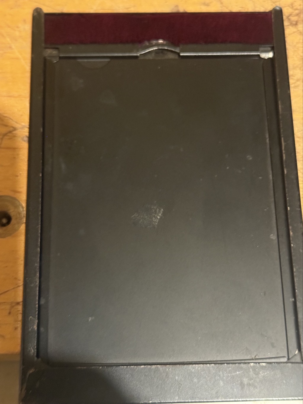

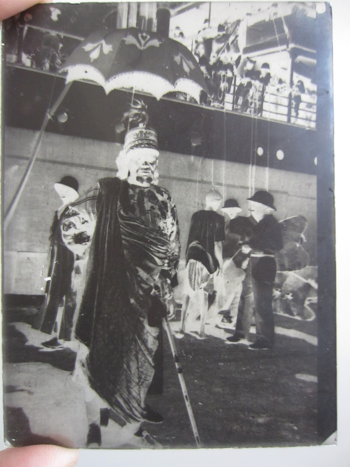

Unfortunately the plate-holders didn't come with any septums, but three of them had plates in them.
One of which had been developed with an intriguing image of a flamboyant gentleman alongside a ship. A world tour maybe?
Looks North African?
I'll give it a scan, get a better look?

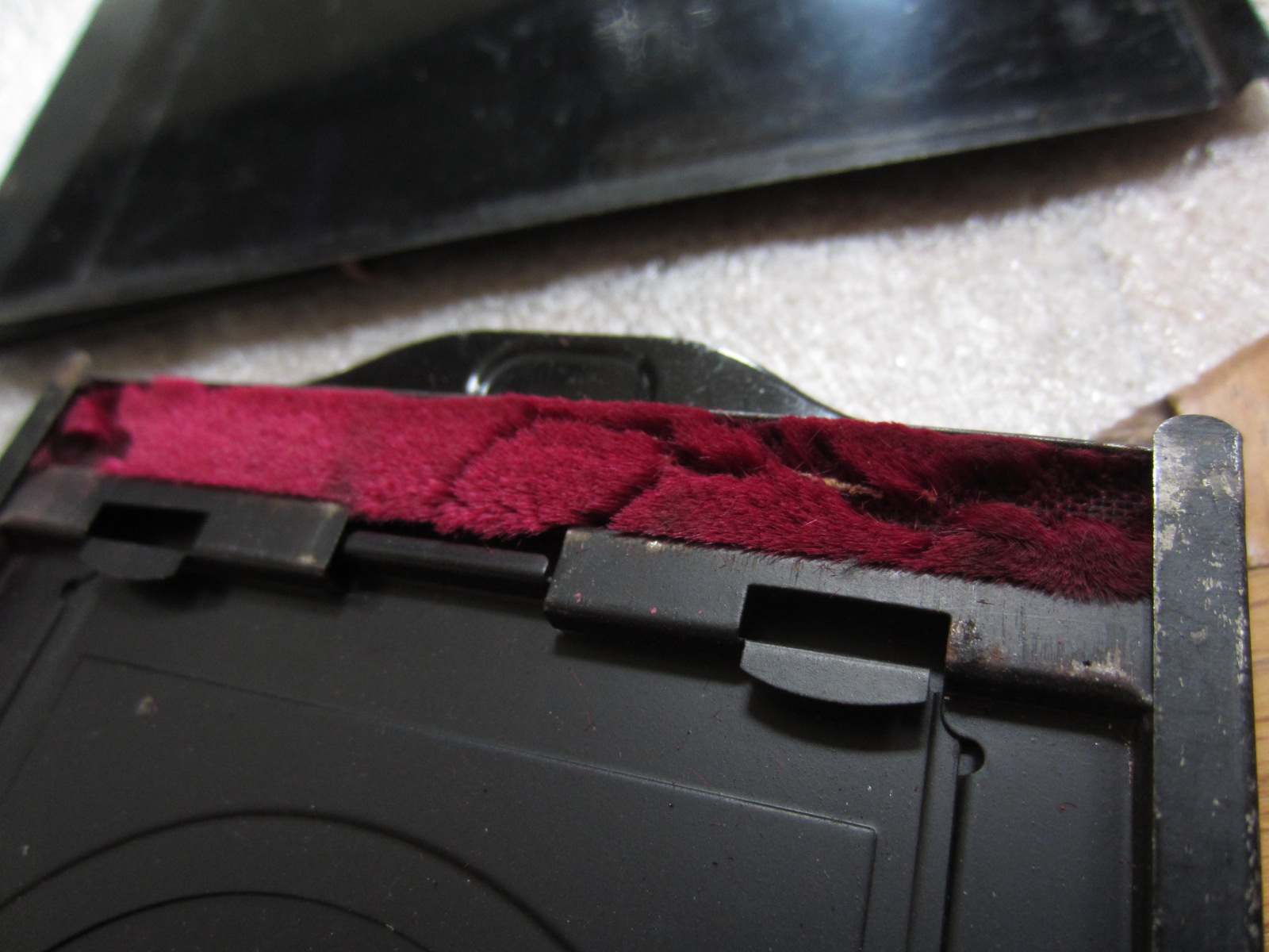

Some of the velvet/sealing on the plate holders has disintegrated.
What is best used to replace this?
Does someone supply proper replacement material, rather than using velvet/felt or whatever?

-opening button: If you unscrew the shutter from the front standard, the bellows usually will be separated from the front
standard. If you now push the bellows into the housing you should be able to access the screws holding the sprung-
catch. You may have to slide the front standard off its rail, but this usually is possible. If you now can unscrew the
sprung-catch you can try to re-bend it, making the opening button accessible again without extension or pen.

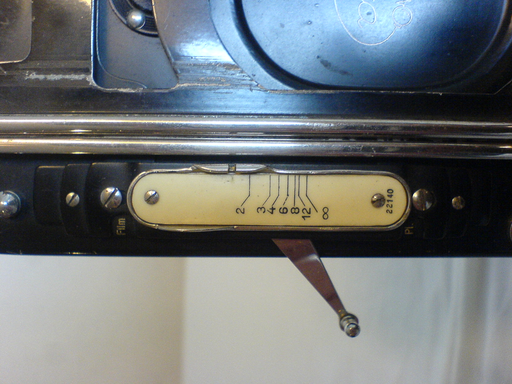

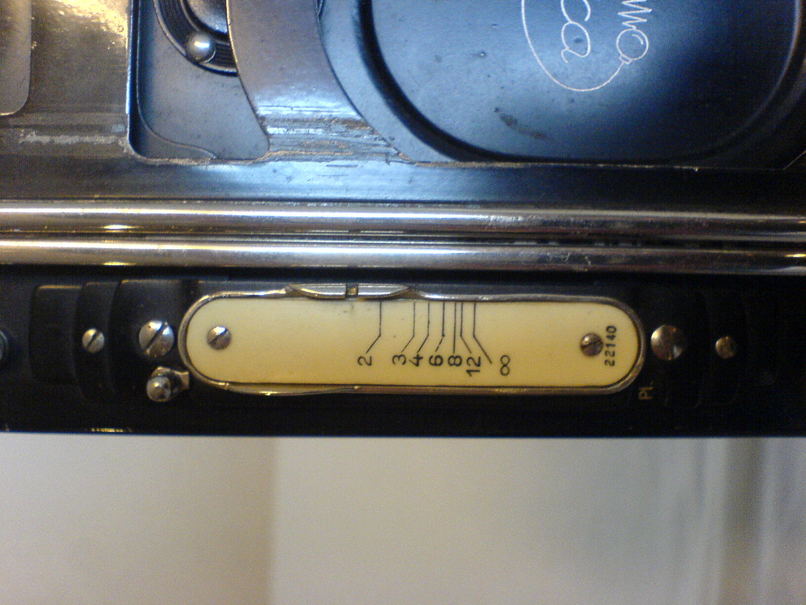

-seals on holders: Well, velvet actually works pretty well if new. Aged velvet does disintegrate after decades, but new velvet does not, so you can just use velvet of proper thickness. Brush after gluing the velvet in to remove loose hairs on the new velvet - after glue has dried.
-septums: Price for the septums should be ok. I doubt you`ll get them cheaper in same condition elsewhere - but when
using septums focusing on the ground glass will be a little problematic: With a septum the emulsion is a little greater
distance to the lens than with a glass plate. Ground glasses on such old cameras often are adjusted for plates, so if
you put sheet film into a septum you may have to compensate for that. On the good cameras there is a little lever on
the distance scale near the rails for the standard. If you swing this lever the scale will move a little front or back and
there should be an engraving for glass plates or sheet film near the lever or scale.
But this only works for the distance scale, when focusing on the ground glass you`ll have to compensate for not using
plates but film.

Regarding the sprung-catch, what you say is what I hoped to be able to do.
But the 'heads' visible holding that sprung-plate on are not screws, not conventional anyway? They have a smooth, slightly domed head. No slot, as a screw would have? I concluded they were rivets, assembled prior to having the leatherette fitted?
Maybe those 'heads' seen from inside are screwed 'into' from the outside, under the leatherette? If this is the case, then I may be able to grip and undo, if the screw does not turn from the other side? Failing that I'd have to cut out the leatherette around that fastener to access it to deal with it and make repair least visible. It's all gettingn complicated and messy? Hence the button extension idea?
If anyone has stripped one of these; right back, leatherette off etc or has a scrap one to identify the fastening of those screws/rivets for the sprung-catch. I'd love to know?
I'll look into sourcing velvet for the seals. The seals on the rear or the camera body are really good. No deterioration.

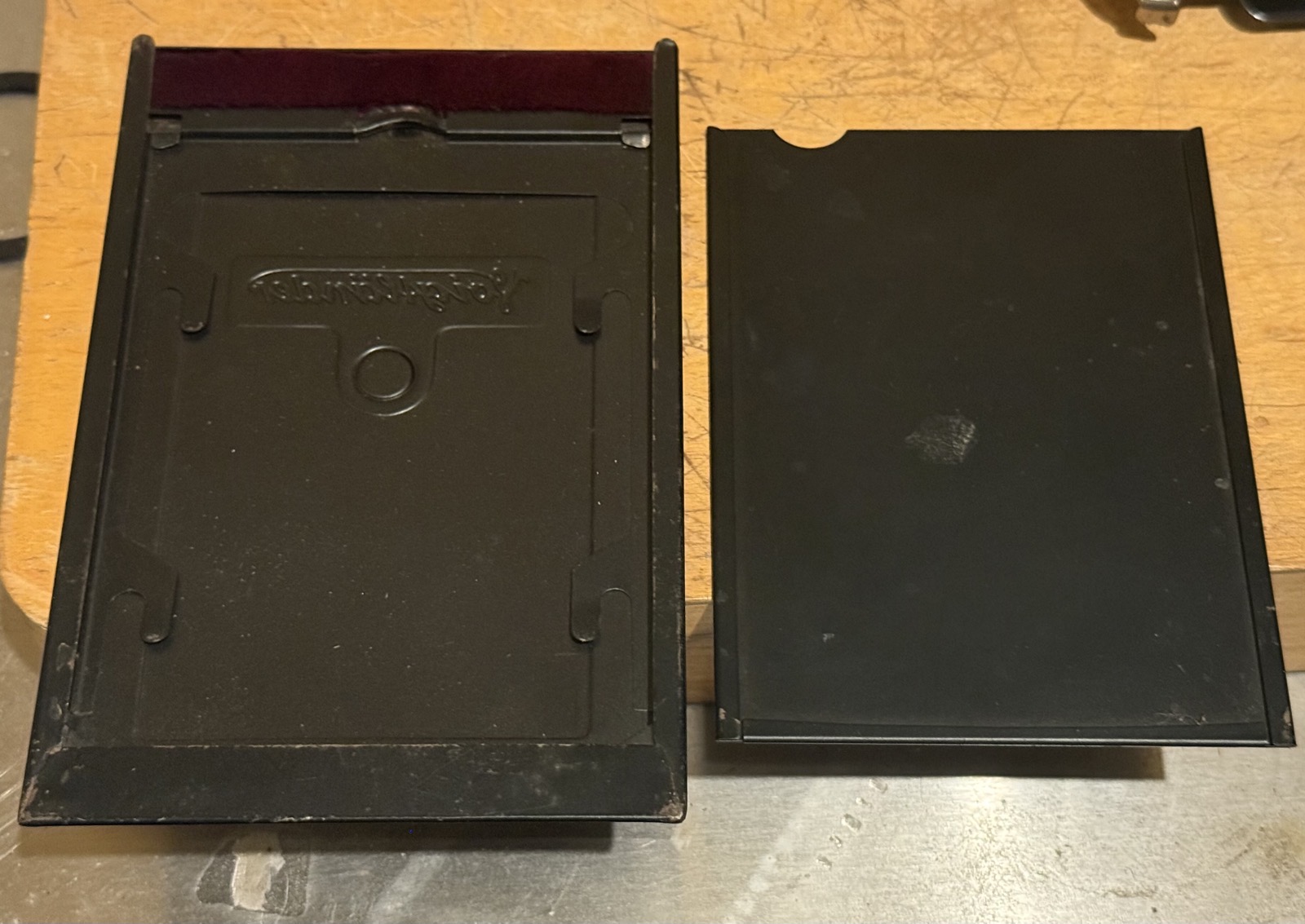

I don't know how those septums/film sheats would work in the Zeiss Ikon holders, but I suspect the film would be held in a slightly slanted position due to the folded edges not being cut in the bottom corners. But the septums can probably be modified.
This is an illustration of the type of septums/film sheats I use in the Voigtländer holders. The blue illustrates the parts of the Voigtländer holder the film is pressed against.

I see regarding the sprung-catch. It wasn`t clearly visible on your picture, so i assumed it to be screwed from the inside, but seems more like its riveted. Then you probably have to do what you`ve already planned.

The point of a septum is making it possible to use film with an old plate holder. Trade-off is that the film won`t match the plane of the ground glass. Yes, the difference is the thickness of the metal the septum is made of, but this already is enough to make a difference (on infinity, with old lenses at least).
Of course it does depend on how critical you are, but on the good cameras there was a lever to adjust the distance scale for either plate or film.
The plate holders have springs that press the plate or sheet film in its septum against the same "frame" in the holder, so the plane of focus is exactly the same. You are probably thinking of the roll film cameras that can optionally use plates, like this ICA/Zeiss Ikon Halloh: https://www.pacificrimcamera.com/pp/zihalloh.htm
No, as ntenny correctly stated, if you put a septum in a plass plate holder the rim of the septum will contact the frame of the holder - but not the emulsion of the film, in contrary to the emulsion of a glass plate.
The septums sold by the company in the link will, yes, but not the AGFA/ORWO septums I use in my Voigtländer holders (see post #6).
An example of the type I use, but this is for 10x15: https://www.ebay.com/itm/114651520410
Notice how the folded rim is cut to allow the film to be in contact with the frame of the holder.
I took a close look at the fit of a septum in one of my Voigtländer holders, and now I think the deviation from the original focus plane is less than I originally thought. See the attached images; the “top” of the septum (towards the handle of the darkslide) goes directly under two little clips that would hold a plate in the same plane, and along the long edges, the rim of the septum sits (very close to) flush with the rim of the holder.
At the bottom of this septum, the corners of the septum do slot under the corners of the holder, so at that point there’s an offset roughly equal to the thickness of the sheet metal, and I guess this means the film plane with the holder isn’t perfectly flat. I can’t say I’ve ever noticed a focus effect from this imperfection, though.

I`m not much into old folders, so i assumed this shiftable distance scales to be more common, but apparently it is rare - i couldn`t find pictures on the net, so i had to take some of my ICA. It`s a 9x12 with a 1:4,5 Tessar... cannot find a type designation:
As you can see there is indication for "film" and "Pl." being "Plates" and when you switch the lever the distance scale including infinity stop does move. It`s not much, maybe half a millimeter, and you may not be able to see on these handheld pictures, but it does move back, towards the ground glass, if switching from plates to film.
Set on "film" the infinity stop is closer to the ground glass than when set on "plates".
Apparently this is rare, maybe this could be had as an "upgrade", but plane of film vs. plates was taken into consideration back then... by one manufacturer at least.
Thank you for the photos. Very interesting. I looked in an old ICA catalog and found that this feature is for the ICA Ideal Rollfilmkassette and not for using sheet film:
"The image is focused either using the focusing screen*) or using a special scale mounted on the camera's base.
*) Upon request, we can supply a special focusing screen to compensate for the focus difference."

You`re welcome. I think these focusing scales were for fast, handheld shooting. If you want to take a picture of a landscape you don`t have to focus with the ground glass if the camera has a stop for infinity - and all the cameras i have seen have an infinity stop. If you want shoot a subject being closer you can guess the distance or use a rangefinder - which would be faster than to put on the ground glass, open the hood, open the shutter, open the aperture...
And maybe also for using a flash. When using a flash you need to know the distance to the subject to set correct aperture on the lens, if you focus on the ground glass the distance scale will tell you the distance to your subject.
Yes, we`ve been digressing a little but not too far i think - as the OP mentioned he wanted to use this lens wide open and then you really need to have the ground glass on the same plane as the film.

Hi, I have loitered on here recently and before as APUG forum, but not really that active.
I just casually mess about with vintage/classic cameras. I got into 'folders' some years ago with a couple of ikontas, i can't recall the exact models a late coupled 6x6 and a uncoupled 6x9.
My only other folder now is a Bessa II. I had a brief relationship with a Cosina Bessa III, but I moved it on, I couldn't be relaxed using it.
During my research into septums I came across this guy.
I see him already linked in other post, I'll get a set of him, or at least one and see how it works out before buying more.
it seems more practical than wating for them to turn up used on ebay or whatever?
Any experience on here of these septums from APS?
