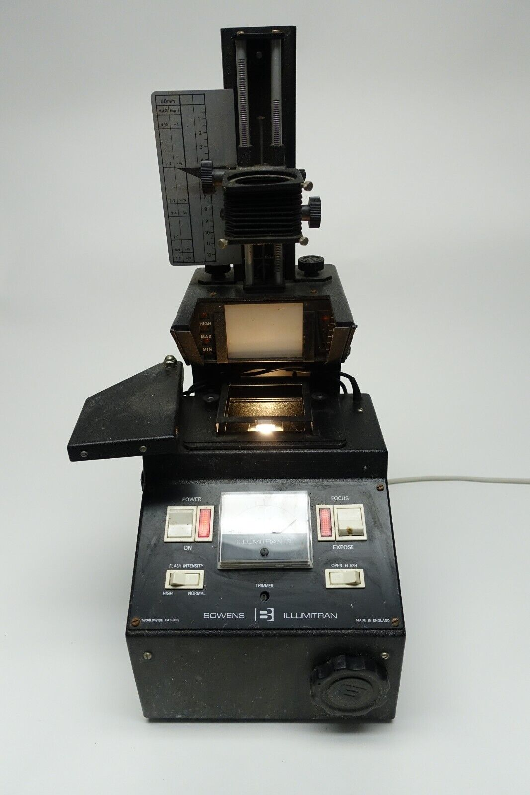

Has anyone ever seen a color slide copy stand available in the 80's? Such copy stand uses a tungsten and an electronic flash (sync'd by the copying camera) light source. And it has a set of dichroic filters built-in for color correction. Its copying area is only of the size of medium format slides (including up to 6X7). This machine is ideal for DSLR scanning if not the best. It wasn't cheap back in the 80's though. I have seen one in the shop in Palo Alto California called Keeble & Shuchat. I somehow came across one in the 90's but I have never used it. I plan to dig it out and give it a try for DSLR scanning. If I do dig it out I will upload a few pics here.
Bowens Illumitran?
From an Ebay listing.
The camera mounts were sized for older film bodies, and sometimes interfere with modern digital bodies with incorporated grips. And they are best suited to use with cameras with larger sensors, as it can be challenging to match them with shorter focal length flat field lenses.
The Beseler and the Bowens units competed for the same market.
Found one on the internet. It's sold long time ago though:
The metal box on top of the film window is an attachment for something. It doesn't belong there. It can be put aside. Mounting a digital camera takes some effort as Matt said. This one has the same challenge but it should be easy DIY to achieve a good mounting of a camera. The great thing about this slide duplicator is it is equipped with dichroic filters and an electronic flash light source. I am wondering how well (or bad) it will do if I mount my Canon 5D-iii on it.
