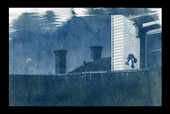

I've only made one, but it was fun.. I made the image around 10 o'clock at night and submitted it on the kinkos/fed-ex-office store website. Next morning at 8AM got an email saying it was ready to pick up at the store near my house. Less than $2. I used it to try to make a VDB on glass... which looked absolutely awesome until I washed it....
I inverted, de-saturated, and then colorized ....
I used these instructions, something like C=0, M=50, Y=50, K = 0...
http://www.alternativephotography.com/digital-negatives-gimp/
I almost think it's worth doing just so you can see how cool the image printed onto a transparency looks....
