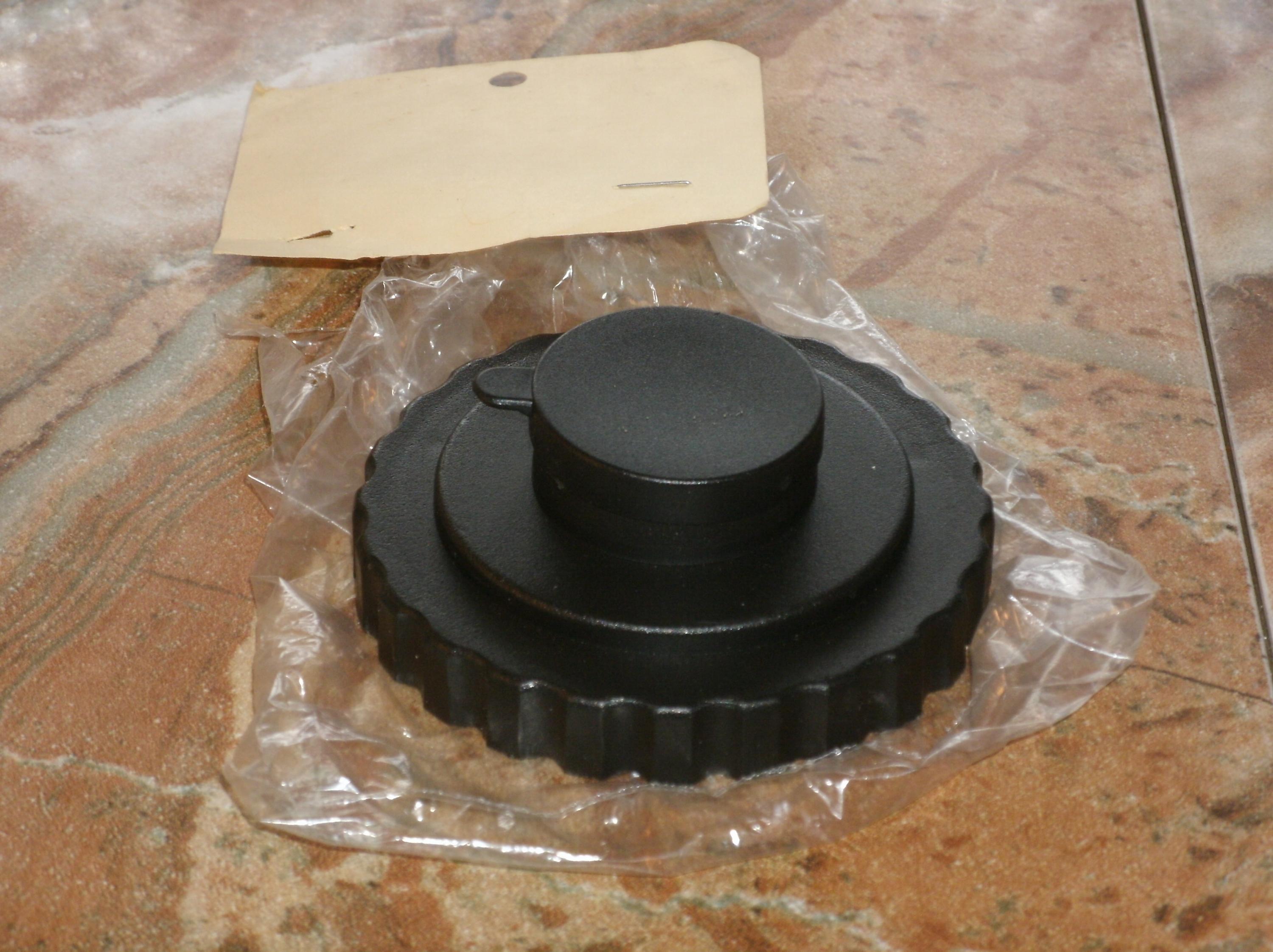

Thanks David! Do you know where can one buy new kinderman lid?
Vania
I have a brand new one I'll sell you. I have tanks and reels, some used, some NOS.
