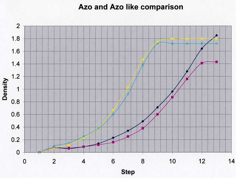

The Lupex formula has been published. It could have been used for Lodima and this new paper. The Azo formula is not published, but I know enough of it to say that all 3 papers came from the same general source = chemistry. Silver Chloride, handled in a certain way gives a certain result. If you get that result, you are handling the Silver Chloride that way. These papers all show similar properties and thus they all share a very common parent. They don't need to be done in the same factory.
I have made this type of paper myself and it matches the Azo curve almost exactly. See attached.
This is Azo, my emulsion and my emulsion at a higher contrast. So, grades 2 and 3.
PE

So PE you are talking about Agfa then.
Photo Engineer
Apr 19, 2005
29,018
Rochester, NY
Lupex was an Agfa trade name for many years, competing with Kodak Azo paper. This new paper is named Lupex and serves the same market. What I showed in my last post was a paper made using the Lupex and Azo formula information that I had simply to show that it could be done and to teach others. I have no idea of any relationship between this current Lupex and the original formula nor did I say anything about that.
