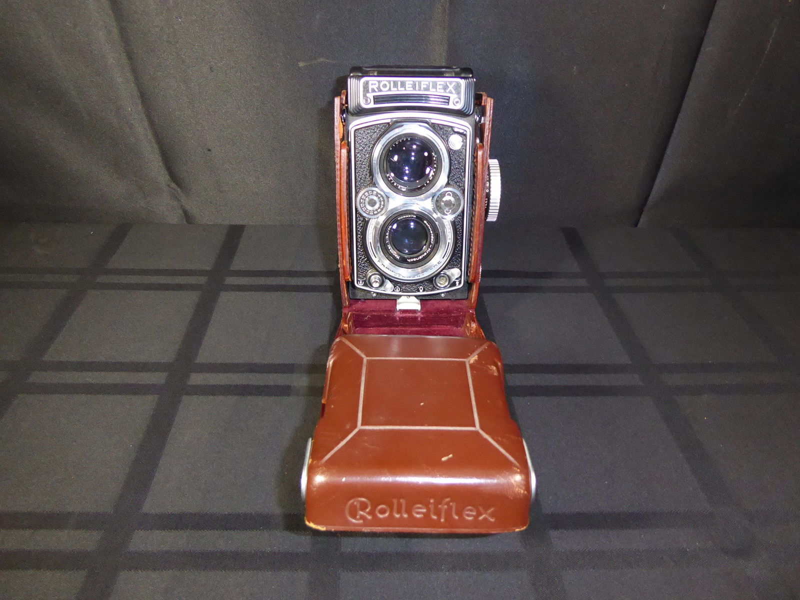

Hello All...
New here and to the world of MF/Rolleiflex. Haven't shot film for 22 years but have always wanted to try my hand at MF. I have the time and wanted to get started so I just bought the cleanest 3.5E with Xenotar that I could find for the money that did NOT have a meter. Hopefully I didn't over pay: https://tinyurl.com/mb5hs4o
They said everything is in working order and that the lenses were clean and clear. Figure it was worth a shot but a bit concerned b/c I don't quite peg Salvation Army as camera pros. I plan on a CLA with Harry Flennor if all seems well and first roll turns out ok. I found his book on Rolleis to be well worth the $10 for anyone getting into Rolleiflex.

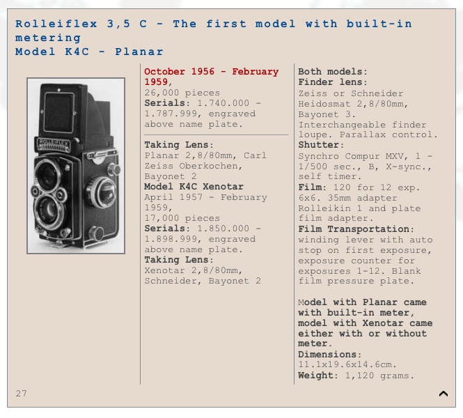

On to my questions... It's model number 1864148. From what I can tell it's a 3.5E type 2 aka K4C. It seems conflicting bc some call it 3.5C. From what I understand it was made after the 3.5F was introduced for those who didn't want a meter. A little confused b/c some call it 3.5C and going by Harry's guide the C's had plastic shutter release locks and sync connector locks which break easily and can't be replaced... so not sure if I avoided a unit with this potential issue or ended up with the plastic bits here since it's referenced as two different model numbers.

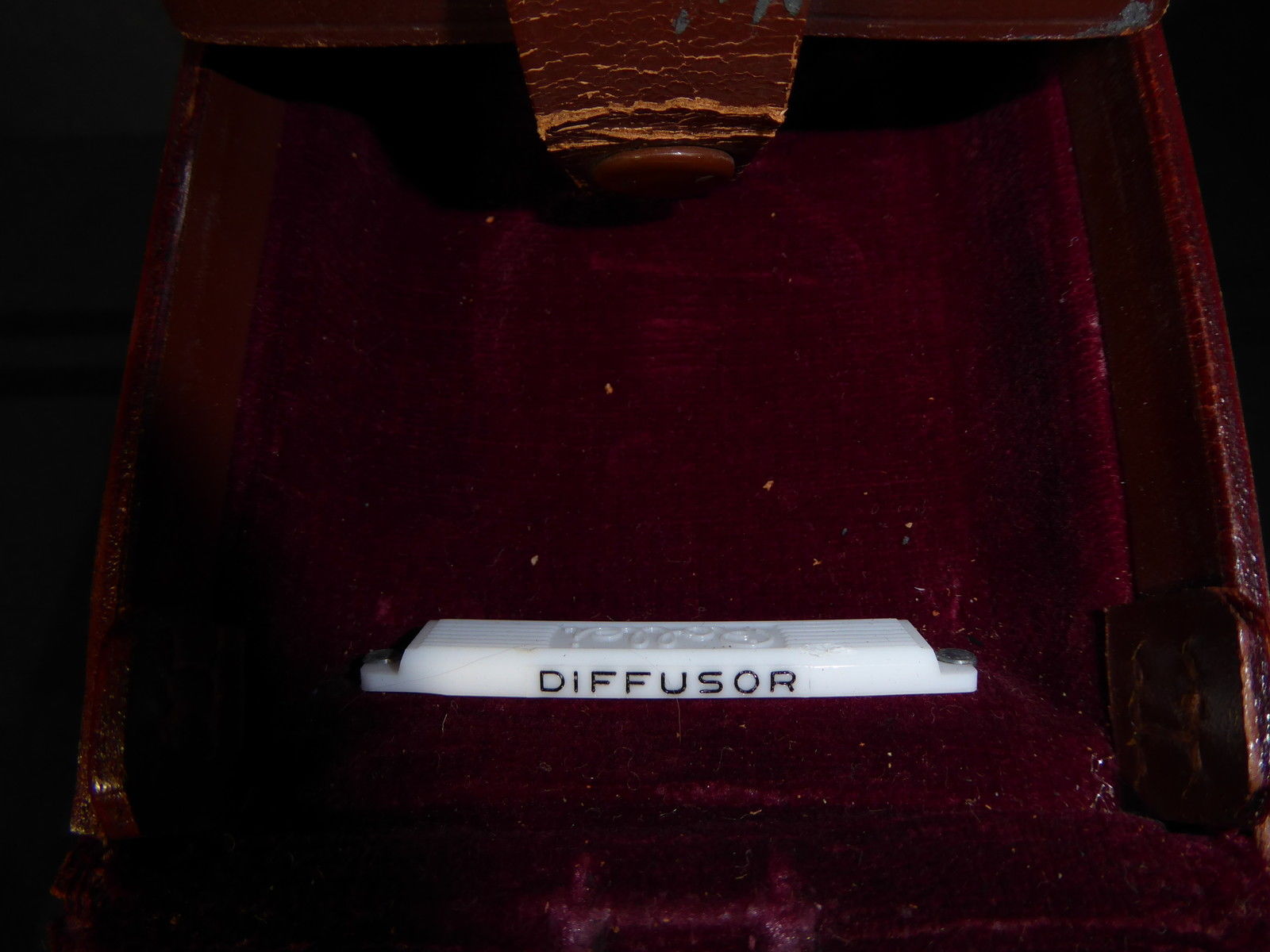

Second thing... in the ad there is a diffuser in the case... this confuses me b/c this gal doesn't have a meter. Not sure what I'm missing here. Pics attached and more at link above from eBay auction.
Lastly... I see references to this model number being Bay II mounts and I see one reference that says the taking lens is Bay II and that the viewing lens is Bay III (see attached screen shot). Are any Rolleis made with mismatched Bays like this or is the info just incorrect? Can anyone confirm if it's Bay II? I've already sourced pars from all over the globe for Bay II so hoping and praying I didn't screw that up.
Appreciate any light shed onto these questions. It arrives tomorrow. Can't sleep tonight. Thanks again!

Congratulations!
About the diffuser: rejoice you have one!
It probably came with the case and it isn't needed for your camera.
About the bayonet, have a look here: (there was a url link here which no longer exists)
BTW, between the 2 lenses, do you know what those numbers on the left wheel are? And the mechanism ofn the other wheel, do you know how it works?

You're correct that this is the 3.5E Type 2 (K4C). My reference book "The Classic Rollei" by Phillips does mention that this model was also referred to as the 3.5C in some reports published by a former Francke & Heidecke senior employee a few decades ago, but doesn't indicate if there were any mechanical or cosmetic differences. If anyone knows for sure, it would be Harry Fleenor. I'm not sure about any plastic parts, but most any Rollei (including 'Cords) from this era are made to the highest quality standards.
This model could easily be upgraded with a meter after purchase, as many of the required internal components are built-in. The factory would replace the nameplate components and swap the focusing knob's film-reminder dial with a meter assembly. My guide states that both lenses are Bay II, so it appears you are good to go.

It was sold as 3,5C in Europe and 3.5E in the Americas. It was the several years older 2,8C that had plastic locks for the shutter and flash contact. The only plastic parts on the 3,5C/E would be the lightmeter window and cover for its needle. The production of this model was stopped when the F models were introduced, but then there were the E2 and E3 models with removable viewing hoods.The E2 was based on the C/E and the E3 on the F bodies.
Don't bother with adding the lightmeter. Even if you can find one it would be several decades old, and the one for this model wouldn't be coupled to the shutter and aperture wheels. Expensive, slow to use and may fail to work. Use a hand-held meter instead.
Yes, the lenses take Bay II accessories. The Diffusor may come from another camera, or maybe this one once had a meter.

As others have stated, this is an E series, not the earlier 2.8C.
Cases are often not original. People swap cases, find another case that fits and put it on for sale, etc. Your camera has the black plastic slug in the meter window. For fun put the diffusor on and post photos on the net saying that you were told this was a UV meter system developed by French police. Stand back and watch people argue....
Bay II. You are fine.
If the lens is clean and the camera works you didn't overpay. Use it for a bit before sending it off to see if it does need an overhaul.

Rollei diffusers are sought after. Someone I know recently bought one on Ebay for A$90! Mine cost me A$20 at a swap meet and is merely an ornament to my E2, as the meter long ago passed away Some years ago I had an offer by a Melbourne camera repair shop to replace it, with one from circa 1960, but decided to pass on it, largely because of the cost ($160) and due to reliability issues. Apparently they were never that reliable for metering anyway.

I bought my Rollei 2.8F in the late 1960s. Almost immediately I lost the diffuser! After all these years my meter remains extremely accurate while the diffuser has never been missed. My repairman, a former Rollei mechanic in Germany, did make an adjustment to a cam to set the 1/500 setting because cameras sometimes left factory with this setting not optimally adjusted. And quiet! Very good for really close up candies...no need to lift camera up to eye. No audible "click“.
