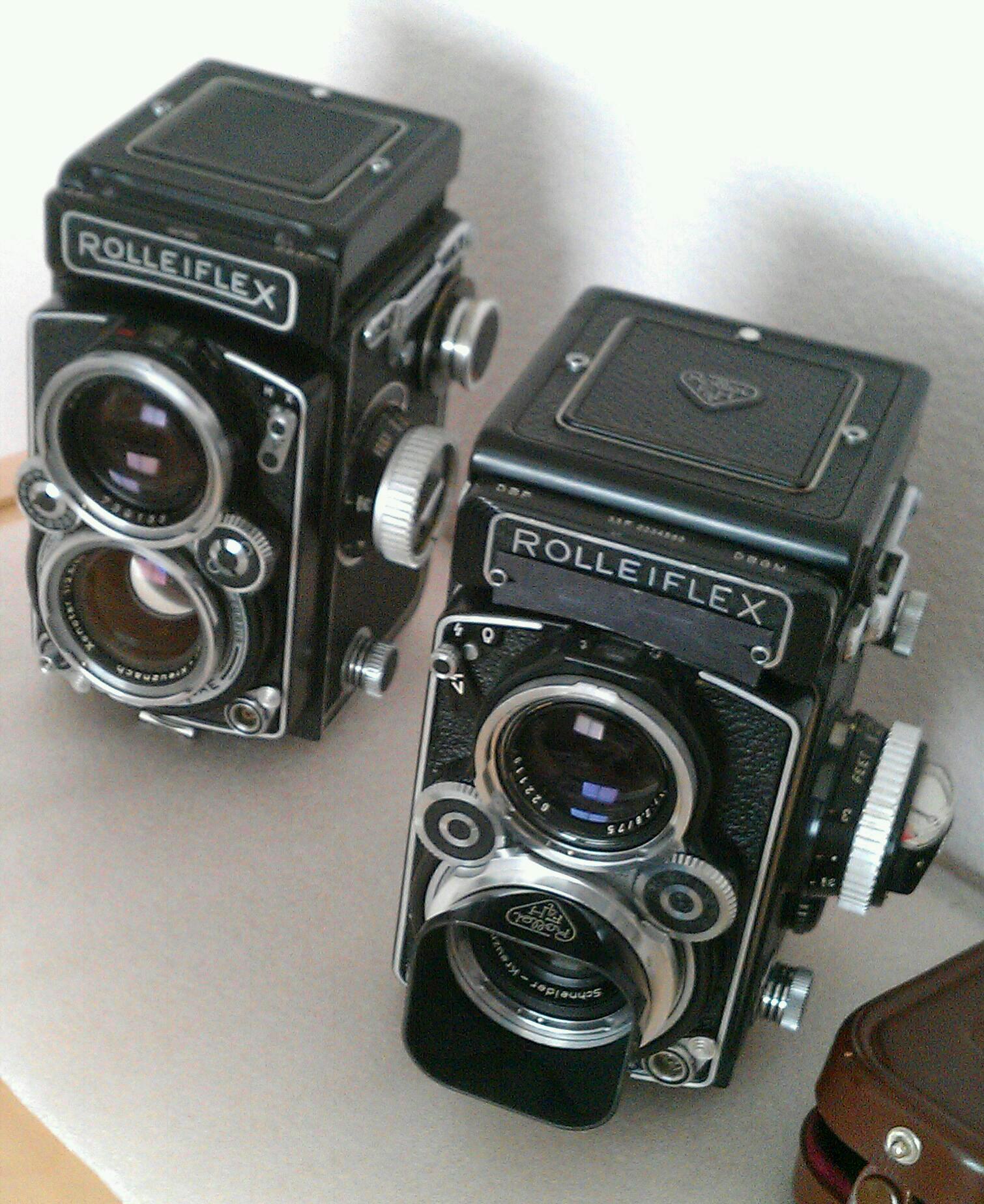

That's what I've heard as well and is the reason I've made little covers for my cameras' meters when they're not being used, ugly as they may be:
(2.8D [K7D] and 3.5F type 2 [K4E] with homemade meter cover)

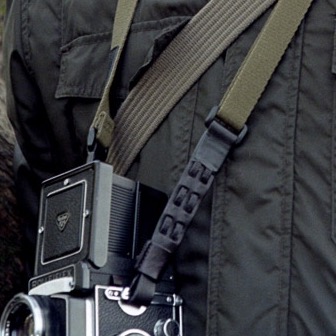

I don't trust the aligator-lugs for two reasons: Original straps are brittle and old and may snap from a good word and the system just seems flimsy in general.
I have one of these on my 2.8F these days, can't get more secure than this (and it looks cool too):
