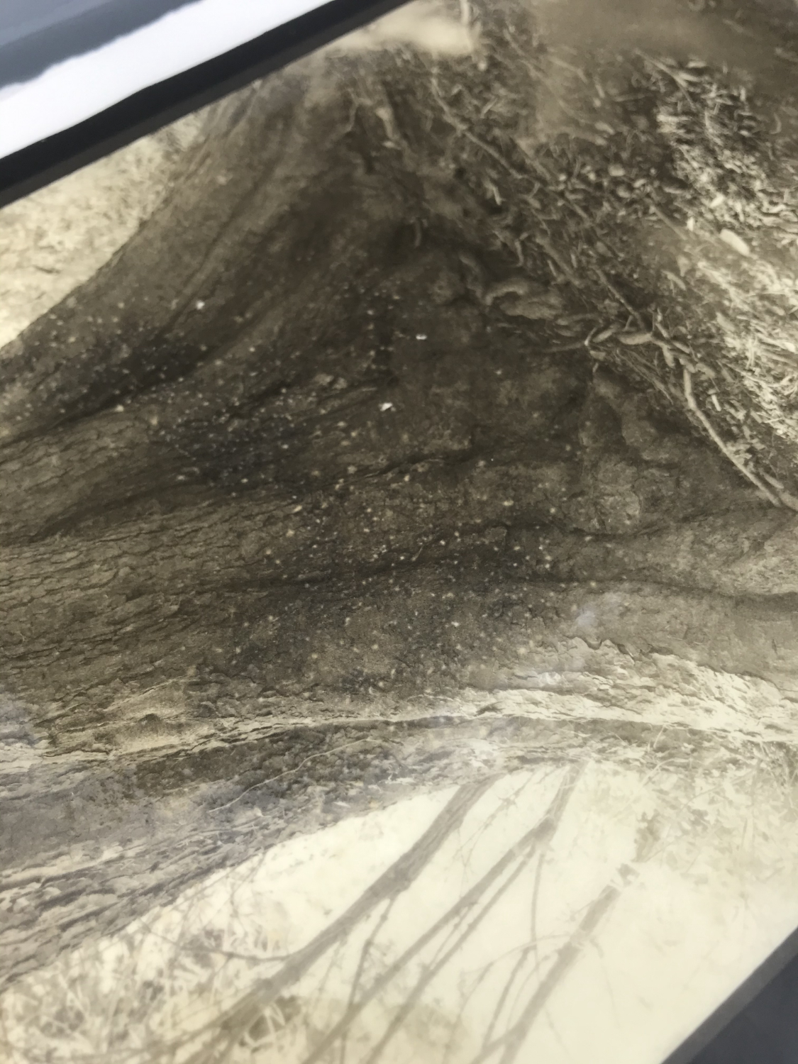

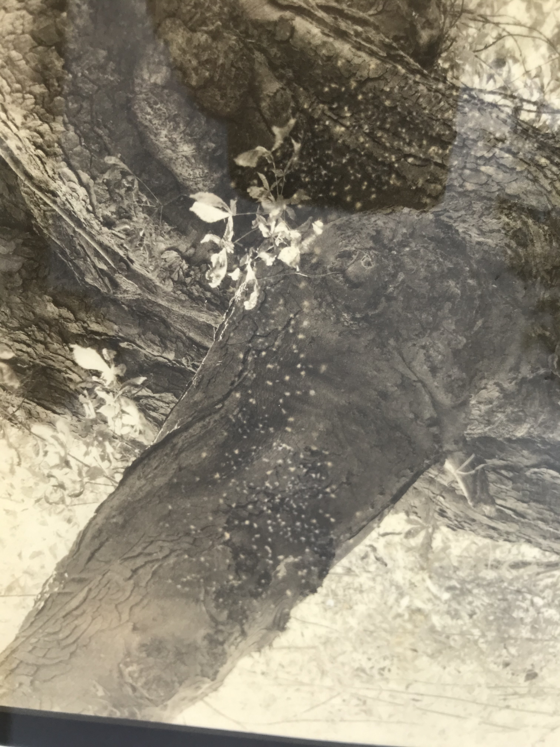

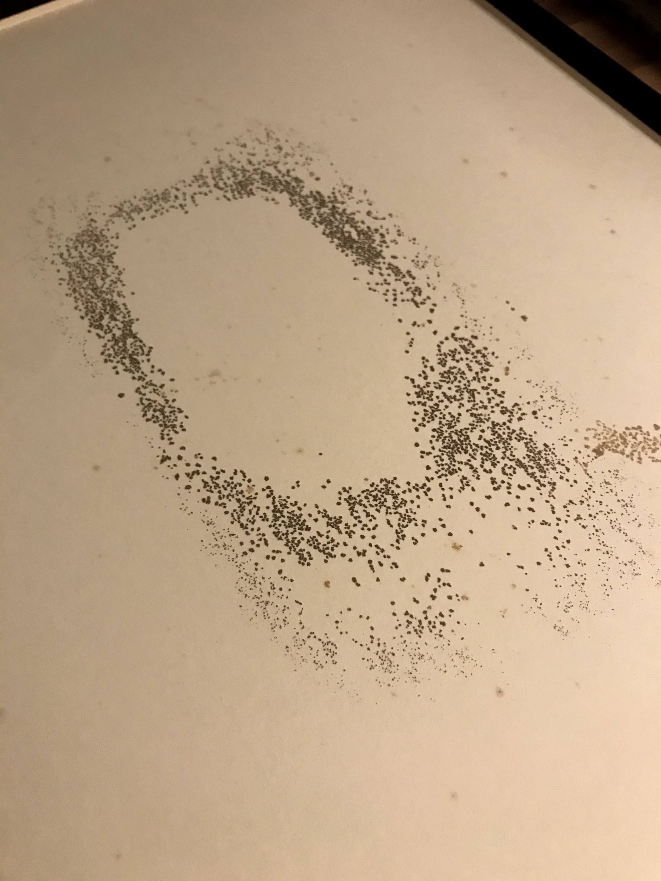

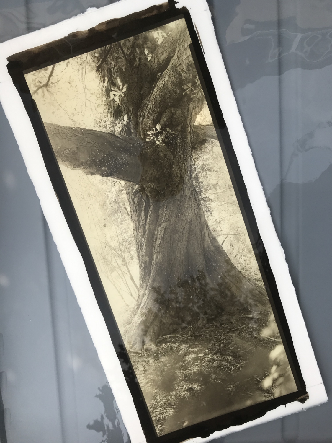

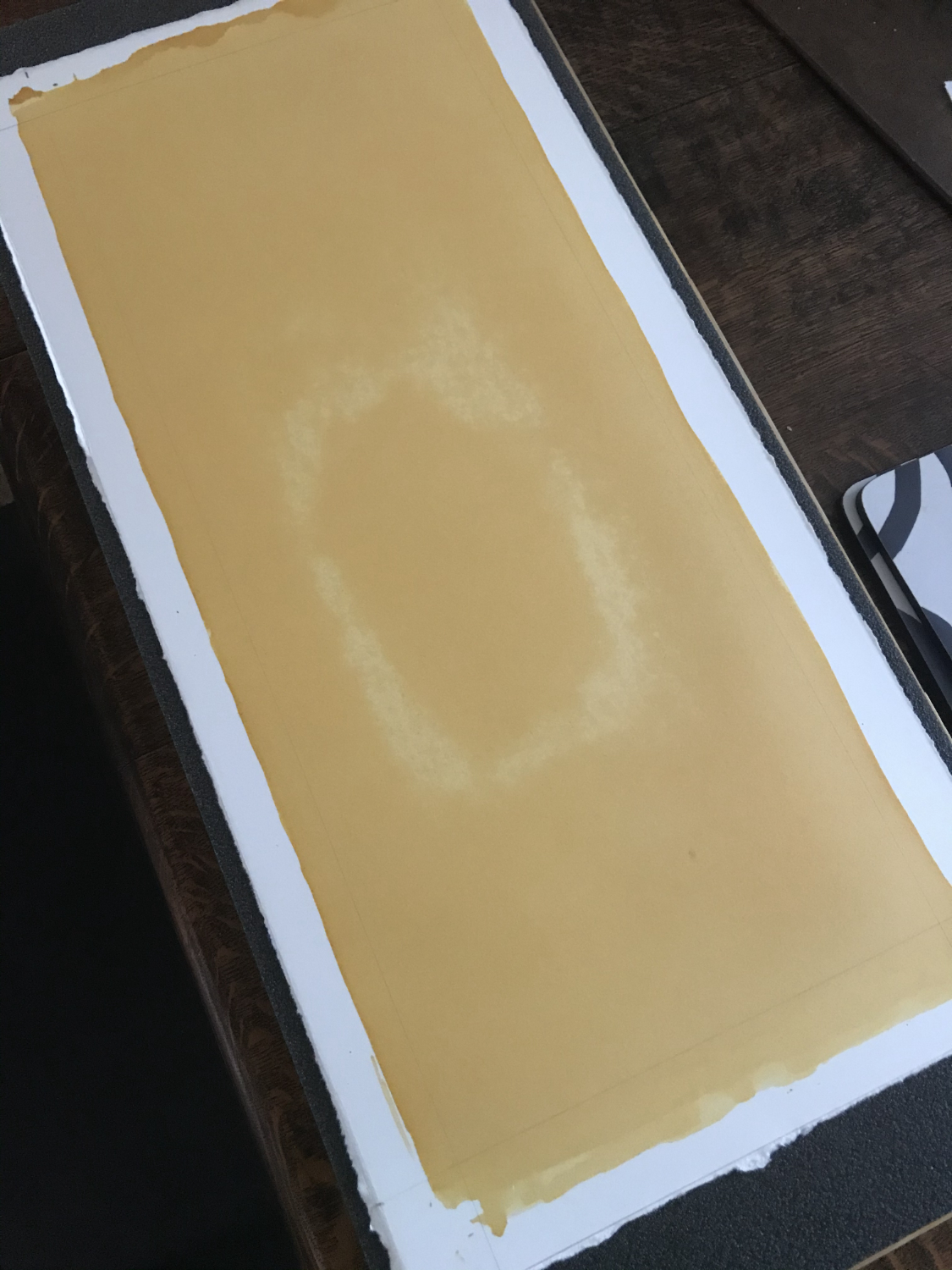

Hey, I rod coated a 7x17 Pt/Pd print with 24+24+6 drops which seemed to cover really well. After drying for a short while in a dark box this pattern appeared. I heat dried it and printed it anyway and the white spots/mottling appeared. I'm assuming too much emulsion and the paper got too wet, maybe too many passes as I had excess liquid and this dragged/damaged the fibres. Any other suggestions? Thanks in advance.

You've got a near perfect rectangle in the middle of that paper where the emulsion didn't adhere. Do they all look like this? Because that's weird. Usually, coating problems from glass rods show up as long streaks. The shape of that makes me think there's something else going on. Perhaps there's something wrong with the paper, or the surface below the paper. Or it could be just a fluke. It's hard to say if it just happened once. But I have never experienced a problem while coating paper with a rod that looked anything like that.

Yeah the symmetry is really odd. It is possible it’s the paper. It’s Arches Platine that’s been sitting around for 12 years. I haven’t had any similar issues with other sheets from the same stash. I think maybe too much liquid and too much pushing and just a fluke with the shake. ‍♂️ Thanks.

I did find out what caused the issue I described in the initial post. I use a shallow print box (as it's the only one I have big enough) to store the paper whilst it's drying. With the curl induced by coating it touched the underside of the lid thus losing emulsion... Nothing wrong with my coating, nothing wrong with the paper. Just dumb stupid user error...
