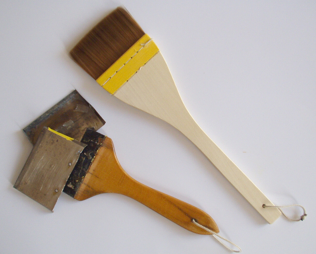

Hopefully my photo attaches. It shows what happens to my old Da Vinci Brushes. I have gone through 5 of them now. I wonder what I can do to not have that happen to my new Richeson. It seems to have a higher quality ferrule. Does anyone or everyone coat the ferrule?

Is that a coating you put on the ferrule?
Yes I have always coated the Da Vinci. One of those pictured is coated with fingernail polish and the other is an experiment with Rubber Cement.
Actually the Da Vinci brushes still work fine but they are so ugly!!
thanks Dennis
I've coated the ferrules of my Da Vinci brushes with brushed on Plasti-Dip (http://www.plastidip.com/home_solutions/Plasti_Dip). I tend not to with the Richesons.
But whichever brush I use, after coating I rinse it with distilled water and immediately dry it with a paper shop towel.

I have heard about dipping the brush in two component epoxy but have no yet had the courage to try it. The ferule on the Richeson brush will eventaully also start to show some rust if not prepped. Great brush though.

I use the DaVinci brushes for pt/pd and have never had problems with rusting or corrosion after hundreds of prints. Are you dipping the whole brush including the ferrule into the solution? Or soaking the brush in water up to the handle? No offense, but you need to take better care of them...

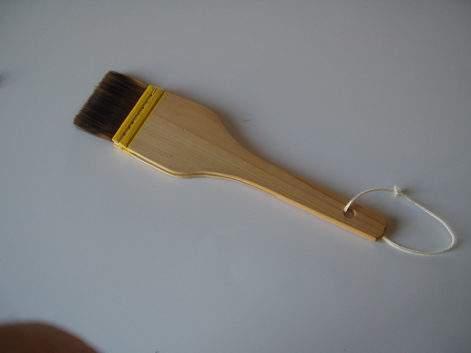

I mount my Richeson brush with a japanese brush handle like that no metal at all and brush is much lighter.

Same for me, I have 5 Da Vinci brushes averaging 5 years of extensive using. Except one which the red paint on the handle blistered here and there - because I left it wet! They're almost in a like-new condition.
The "secret" is:
- Never leave the brushes with emulsion on the bristles, rinse immediately after coating!
- Never leave the brushes wet, dry them (bristles, ferrule and handle) with a paper towel immediately after rinsing!
- Never leave the brushes to dry bristles up, because some water remaining in the bristles may (or "will" if you like) emigrate to the ferrule and maybe to the hande, causing the ferrule retaining rivet to rust - as I experienced with my very first brush. (Can still use it for pt/pd, it's safe as long as you don't wet the rusty rivet...) Leave the brush in horizontal position or hang it from the handle (from the hole in the handle or using a clothes peg) instead, in order to let them dry completely.
Working clean is the key here... (EDIT: I mean you don't really need to coat the ferrule with something - unless you really need the comfort of extra safety. I didn't coat the ferrule of mines with something.)
Hope this helps,
Loris.
P.S. Moisten the brush with (distilled - depending on process) water before coating; you won't have too much emulsion sucked in the bristles that way - we need the emulsion on paper, not in the brush... And, hold the brush perpendicular to the paper while coating, just touch the paper with the tip of the brush; same reason as above...

Some more picture with my 3" Richeson brush to get what I call an "Improved Richeson Magic Brush"

I love that idea payral. It seems to me it would be very difficult to do perfectly though. Also interesting to note that your brush had a natural wood handle. Is the "magic" brush different than what I just got?
As to the clean working methods. Ok clearly my method causes my problem. I don't like coating with a brush full of water or washed and squeezed. I find it much better to coat with a brush that has sensitizer already in it.. In fact I start my printing sessions by first washing the brush.. even though I did wash it after the last printing session, and squeezing as much water out as possible and then putting 5 drops each of FO and Palladium mixed on a paper and soaking the end of my brush in it. Then I generally print whole days at a time and I only wash my brush if I am going to stop long enough for it to dry out. When I wash my brush I wash from the ferrule down (brush fibers only) with steaming hot water. I do it this way because it works best for me. My brushes last me generally about 4 years. The ones in my picture are at least that old. I realize that coating the outside of the ferrule does not stop the inside from corroding so it is probably a waste of time. The brushes in my picture still work fine as do the others in my cast off box. They are just ugly to look at. But from what I read here the corrosion clearly comes from the brush keeping sensitizer in it for hours on end. Even so that is worth it to me because I like the way it coats better than one just washed and squeezed. So I guess I look forward to the same thing happening to my new Richeson unless I get payral to re do it for me...
Dennis
No it's the same but when I got them (more than ten years ago) I removed original paint and coat handles with some strong varnish. After that I used to paint metal part with Plasti-Dip and few months ago I changed original handle for a Japanese one.
It's not very difficult to do.

When you take off the original ferrule, do you find the brush fibers are held together with glue or something? Or do you have some way of clamping them tight so they don't become miss arranged when out of the ferrule? Is it only the thread of the split hake brush that keeps the fibers aligned? I hate to ruin a good brush by experimenting.
Dennis
Brush fibers are glued together. I didn't change anything to that. The thread is just to fix the "pack" to the handle.
I modified two Richeson brushes, a 2" and a 3". Both were made the same way.
Loris I didn't want to improve my technique, just improve my tools
