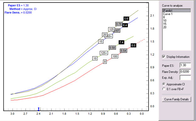

craigclu
Sep 8, 2002
1,324
Rice Lake, Wisconsin
I finally got a few minutes to run some MC and got slightly odd results and will rerun when I can to see if I introduced some "operator error" factor. My Macbeth TD-902 showed a FB of 0.41 and my blue channel Wallner-Labex showed a 0.31. I'm accustomed to the opposite reactions on tanned negatives. I also had lower numbers throughout the range on the blue channel. I recalibrated both units and a repeat got the same results. I also found a longer, flatter toe than I had seen with PyroCat-HD. I exposed HP5+ 35mm at 200 and ran 1:1:100 for 13 minutes with 1 minute intervals on 2 gentle inversions. This is very preliminary and I was interrupted during the processing and reminded of a commitment that rushed me through the final stages of rinsing, alkaline fixing and washing so it is quite possible I've sent something amiss... This chart is from my "not ready for public appearances" spreadsheet that I use for quick plots of my tests. The magenta line is the Macbeth @200 numbers, the orange is the Macbeth @100 numbers and the broken blue line is the Wallner-Labex blue channel @200. The dotted line across at 1.32 is simply a baseline for my enlarging equipment that keeps highlights controlled at Zone VIII on #2 materials.

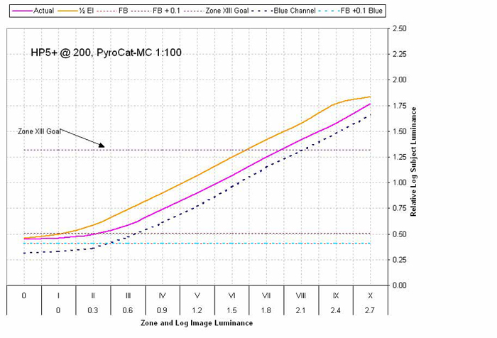

sanking
Mar 26, 2003
5,437
Greenville,
Craig,
Not sure what is going on with your curves but they is different from what I see. I am attaching a family of curves based on Blue mode analysis of FP4+ film. It is not very different from that of Pyrocat-HD. The stain density is definitely greater in Blue than in Visual, and much greater in UV than in in Blue. For example, Step 1 density at 8, 10, 15 and 20 minutes is as follows.
8 minutes, V(1.28), B(1.50), UV(1.97)
10 minutes V(1.48, B(1.73), UV(2.23)
15 minutes V(1.78), B(2.09, UV(2.72)
20 minutes V(1.92, B(2.24, UV(2.94)
BTW, for those not used to reading BTZS charts, the numbers on each curve represent 1) time, 2) effective film speed, 3) approximate CI, and 4) SBR. The setting are based on an ES of 1.30, which would be appropriate for printing on VC silver papers, and a flare factor of 0.02 was added. The film is fairly old and has a minimum B+F of about 0.12, thus the rather significant increase in general stain with the 15 minute and 20 minute negatives.
Sandy
