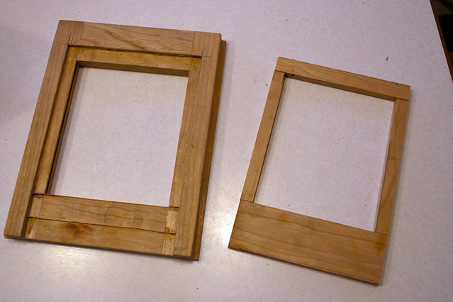

This morning, I fit the film holder to the back.
IMG_1176 by Scott --, on Flickr
Next, I'll start on the ground glass holder.
Now that now looks very like the Roll film adaptor I made for my Quarter plate, and is close to my next step with my Houghtons Duchess.
Essentially I'm about to make almost the same except that it'll just hold the 5x4 DDS (UK term for cut film holder) in the same register as the current glass focus screen, which will save a lot of work.

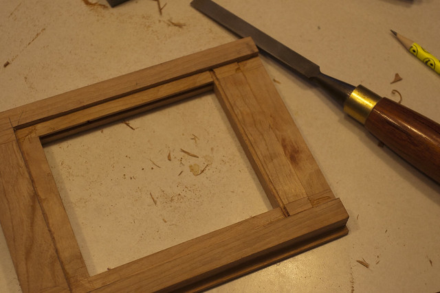

Yeah, Ian, the focus screen part is next. Started planing cherry this afternoon, but I need to (accurately) measure the distance to the film plane, add in the thickness of the glass, and have at it. Figuring half-laps at the corners, stopped rabbets for the glass. And I found a scrap of ground glass from the last 8x10 screen I made, so that's done!

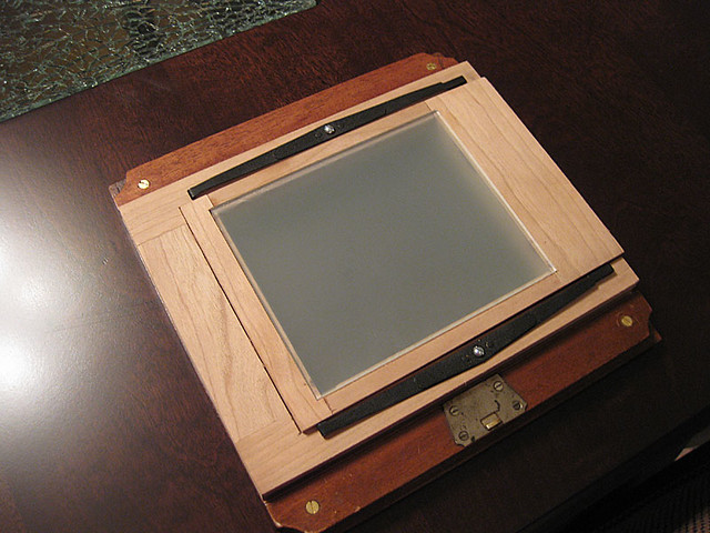

Ground and cut the glass and installed the springs today:
Getting closer... by Scott --, on Flickr
Starting to look like something. Will order Tansu corners tomorrow, and install the mounting pins on the ground glass holder...

Well, installed the pins in the ground glass frame this morning. With the springs surface mounted, and no recess cut for the bends on the ends, there's just too much downward pressure on the frame. So, I have the Dremel set to cut recesses for those spring ends.
Drat. Will need to remount the pins after this, too...

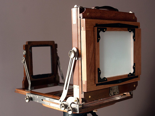

Thanks, Jonny. :smile:
Waiting on clips... by Scott --, on Flickr
The oil and lacquer are dry, and the insert is reassembled. All it needs now are the ground glass retainer clips, which are coming UPS today. Once they're installed, I'll touch up the paint on the springs, paint the screw heads, and move on to the tripod mount. Overall, I'm happy with how this is turning out...

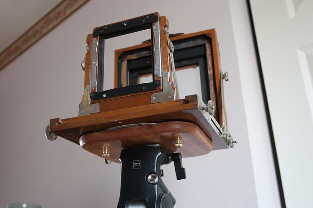

I have the same dilemma, in my case the original brass tripod ring is missing, a previous owner had fitted a plate to the bottom which had been removed again before I bought the camera, and didn't come with it.
My best option is to make an aluminium plate as this will be the least obtrusive and add little noticeable thickness to the base, I can use existing screw holes. This will leave the camera as original as possible so if I find another tripod ring and matching legs it can be restored back to the original tripod configuration.
