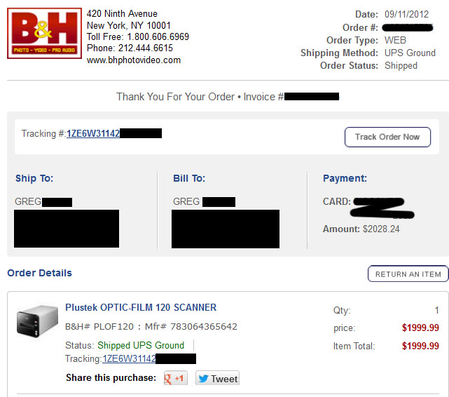

Mine has shipped!!!
Scheduled to arrive next Friday (01 Feb 2013).
Proof:
850d1359132917-new-plustek-opticfilm-120-scanner-surfaces-sort-120-jpg
--Greg

Naturally, we expect a reasonable production value unboxing video and extensive testing reports ASAP...

I'll post what I can, but I'm gonna be buried in work this week. Definitely no unboxing video.
--Greg
