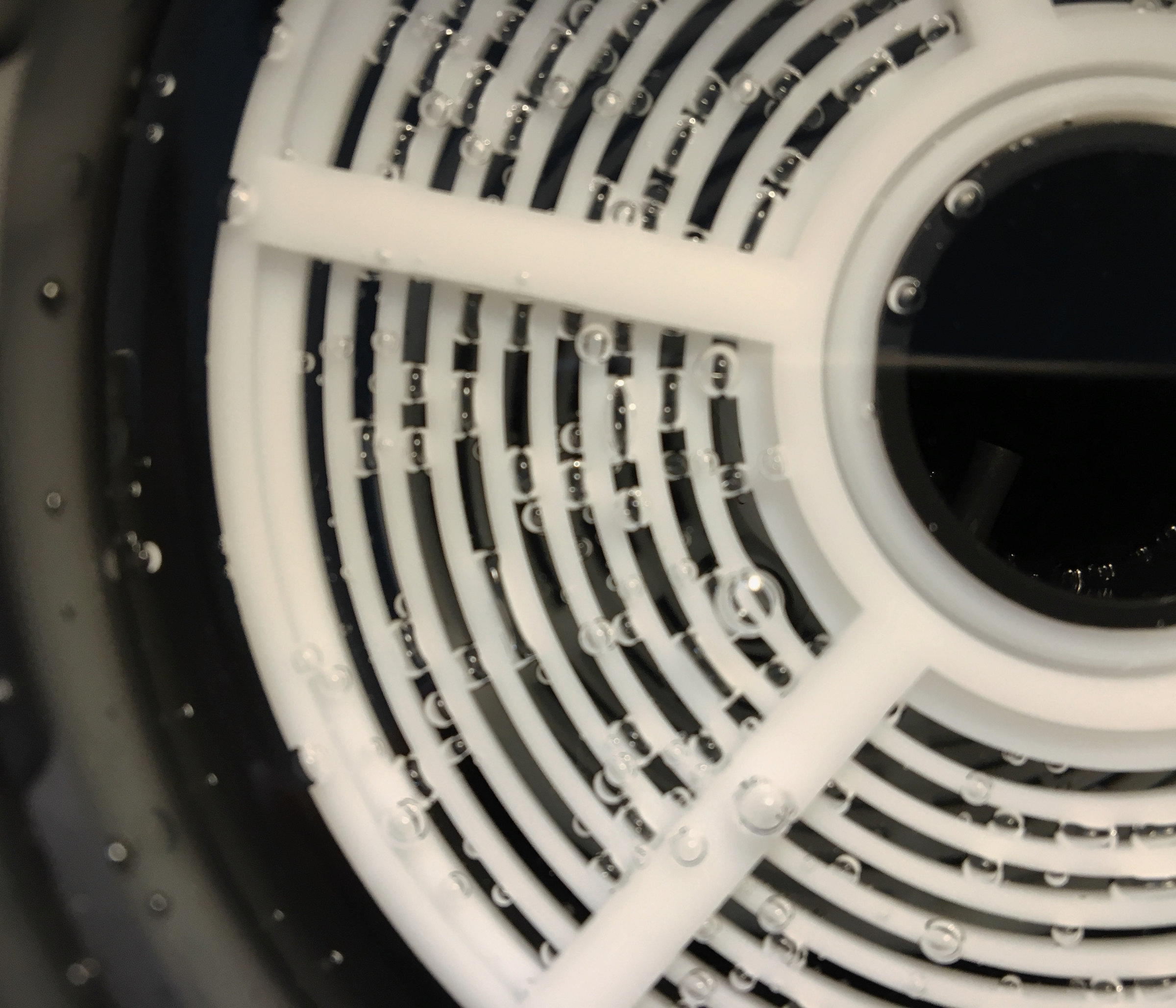

I am trying to solve a problem with air bubbles sticking to my new Paterson reels, see image
The water is store bought demineralized water (like for car batteries, steam irons etc.) so it should be soft – maybe not soft enough?
The peculiar thing is, that I have 2 old (40+ years) Paterson reels, where this problem do not occur. Is it the new plastic, which needs "breaking in"?
Anyone have any suggestions?
Thank you in advance.
Michael

Maybe there are some residues of some kind of detegrent in the new parts. Have you tried rinsing with hot water for some time?

Quite the puzzle. Are you getting air bells on your negatives or are the bubbles affecting the negative in any other way? Do you only see the bubbles after a final rinse? Do you see the bubbles at the end of fixing? I would never notice such a thing with my reels as I don't open the tanks until after a bath of Photo-flo and there is just a mass of foam.

As Neal says, one wouldn't usually notice any bubbles at all until the end of the fixer cycle or wetting agent cycle.
But isn't banging the bottom of the tank after each inversion every 30 to 60 seconds supposed to get rid of any bubbles like this? I do presume that you are doing this simple procedure?
And also as Neal asks, 'Are you getting air bells on your negatives...?'

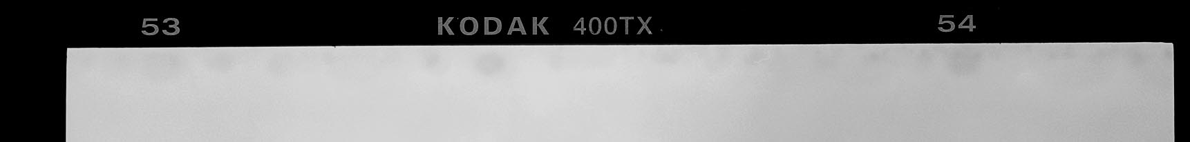

Yes, got these markings along the top of the film (when mounted in the reel/tank), which is why I started to investigate (a fancy word for wasting my time, I believe ;o) )
I got the markings, searched the internet, and learned a lot about marks from foam (much more brutal) and the bubbles on the reel. So I tested various agitations/twisting etc. to see where the bubbles where, and they where in the pre-soak and developer. So I stopped the process there, and deduced that the problem most likely also is in stop/fix/blix/stab/what-have-you-not, depending on the process.
Yes, banging, by now so hard my downstairs neighbour is wondering what is going on... tapping it hard on the table, smacking my hand against the bottom, striking the side of the tank with a plastik spatula. Nothing seems to loosen a large part of the bubbles with the new reels. My old ones, not a single problem...

Try some tap water instead.

I'll keep working the problems, just tested a friends Paterson reel with tap water, just a single air bubble no matter how hard I tried to invert or shake the tank.

The "reel" question (pun intended) is not whether you have bubbles, but rather whether the bubbles move when you agitate.
I would recommend the Kodak agitation scheme (5 seconds every 30 seconds) or continuous rotary agitation if you are having problems with bubbles.

The problem is that I can't get the bubbles to dislodge. My older reels, and also a friends Paterson reels don't have this problem.
The Kodak scheme is this (?): "Provide initial agitation of 5 to 7 inversion cycles in 5 seconds; i.e., extend your arm and vigorously twist your wrist 180 degrees. Then repeat this agitation procedure at 30-second intervals for the rest of the development time." If yes, the I don't think that will dislodge the bubbles after each interval.

Perhaps you need a bit more water in the tank. The bubbles want to go to the surface and if your film is sitting right at the surface, that's where they're going to coalesce.

Have you tried gently taping the reels against the bottom of the tank to dislodge them?

Yes, actually more forcefull than gently. The some bubbles dislodges, but far from every one like the older reels. I forgot to mention that in the original post, sorry for that.
The reels are covered with the required 1 liter of liquid (tank size), and there is almost no room left for more liquid. Also my older reels and a friends reel doesn't show this problem with the same amount of liquid.

I remember years ago, Patterson made a faucet attachment that when to the center tube of the reel for washing film. Maybe running water down the middle might help? There's less turbulence if water went one direction entering from the center and exiting radially outward.

Yes they still make that and it is still available. I have one. It is called a "force film washer"
http://www.patersonphotographic.com/patersondarkroom-details3.htm#ss4-developing-tanks (scroll down page)
I also noticed more bubbles on some brand new reels as compared to my older reels. The actual plastic and construction seems exactly the same. I did not seem to do any harm and I kept using a firm few taps on the bench after inversions. Scientifically I did wonder what was happening; I speculated that the new reels were rougher and providing nucleation points for dissolved gasses to come out of solution (this may be completely wrong). With use of the new reels the problem seems to go away, possibly the microscopic roughness is abraded by passage of films or the surface becomes coated in some way.

A few years ago I had air bell issues with processing the photo of my test with a Paterson tank and reel looked almost identical. I added drops of wetting agent, and I mean a drop at a time until there was sufficient to cure the air bells, too much and you'll get foaming.
Surfactants are added to film emulsions so to aid coating, some suffer less than others. My water in Turkey is extremely hard, from a bore hole and we are on the coast so I add a few drops of wetting agent to my developer when I mix a new batch (from raw chemicals), that solved the problem.
It's not just water hardness it's dissolve gases and de-ionised or even distilled water re-absorbs Oxygen and Carbon Dioxide and a few other things depending on how stored.
