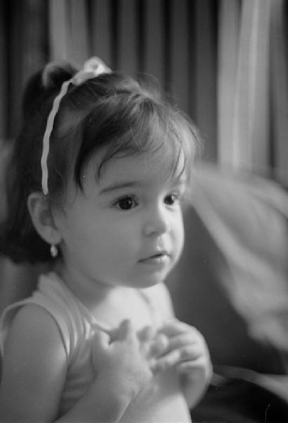

I'm not sure I get it....
is this good bad or ugly bouquet?
and why?
I like to use bokeh to refer to the characteristics of the lens, not the picture. To me, a picture has a good or bad background and a lens has good or bad background rendering, or bokeh.
That picture looks like it was shot with a lens with neutral to bad bokeh. It's still a good background to a nice image.

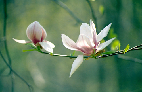

This is a scan from a neg that was taken with a lens that got an eight on that list.
I don't know how much the scan and JPEG artifacts screw it up. Maybe it is an invalid illustration.

psvensson said:
A lot of Rolleiflex images from that era show spectacularly bad bokeh, .
can I see some examples ? Most are tessar type lenses which have neutral to good bokeh....dont know about the Planar's....
