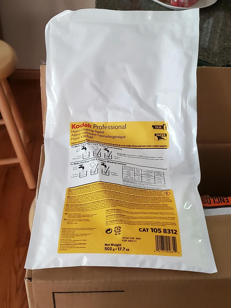

Just bought a new package of D76 from my local camera store, past few years have been using clones, the price was nice, better than Freestyle or Ultrafine, no shipping, but boy it is a big sack, 3 times larger than needed, I hope they used nitrogen other wise will oxidize much sooner. They hypo clearing also seems to be in over size package.

Probably because buying one size of bag stock (before printing) saves money over a bunch of specialized sizes. They sell Dektol in 5 gal packages, so they save (a penny a bag, maybe) if they package all their other dry chemical mixtures in the same size bag that fits a 5 gal Dektol.
Could be wrong, might be some other reason, but money is usually it.
Bags are made from a hose that is printed on in apt format, and cut and sealed only at the filling machine.
Thus there should not be too big bags.
Unlesss the printing was designed too big and the filling machine encloses air/inert gas. Oŕ if the bag was designed for very flat packing but instead was filled compact with included air/gas.
Hazmat/SDS notification requirements, which change every few years (changed in 2016, IIRC) and apply to any newly designed packaging. They have to have a hazmat panel with text of a certain size, including ingredients above a certain percentage and hazard level. The panel has to fit on the final consumer package.
If one needs a certain size of printing, one still can fill the bag in two ways, without adding air or inert gas, as I explained above.
The OP though indicated that uneccessary part of the volume is just air/gas.
(What he considers a problem to him.)
I have some metol (the most oxidation-prone component of D-76) that's been in an opened jar for at least twenty years, and the only change has been that it's straw colored instead of bright white like a newer sample I have. Even if there's humidity trapped in the bag, there won't be enough water there to cause clumping or accelerate oxidation with the tiny amount of trapped oxygen.
The bags have to be filled in a vertical, open-upward position, so they can't readily be "flat packed" as you describe. Attempting to do so would cost more, and unless there was a specific reason to need to exclude air, there's no reason to spend that money.

Everything in oversize bags. Like I said, they bought one bag size (big enough for a 5 gal Dektol) and packaged and labeled everything in that size, at least for a moment.
If it's in date and still airtight, I wouldn't worry about it. Probably aren't any of these past date yet.
