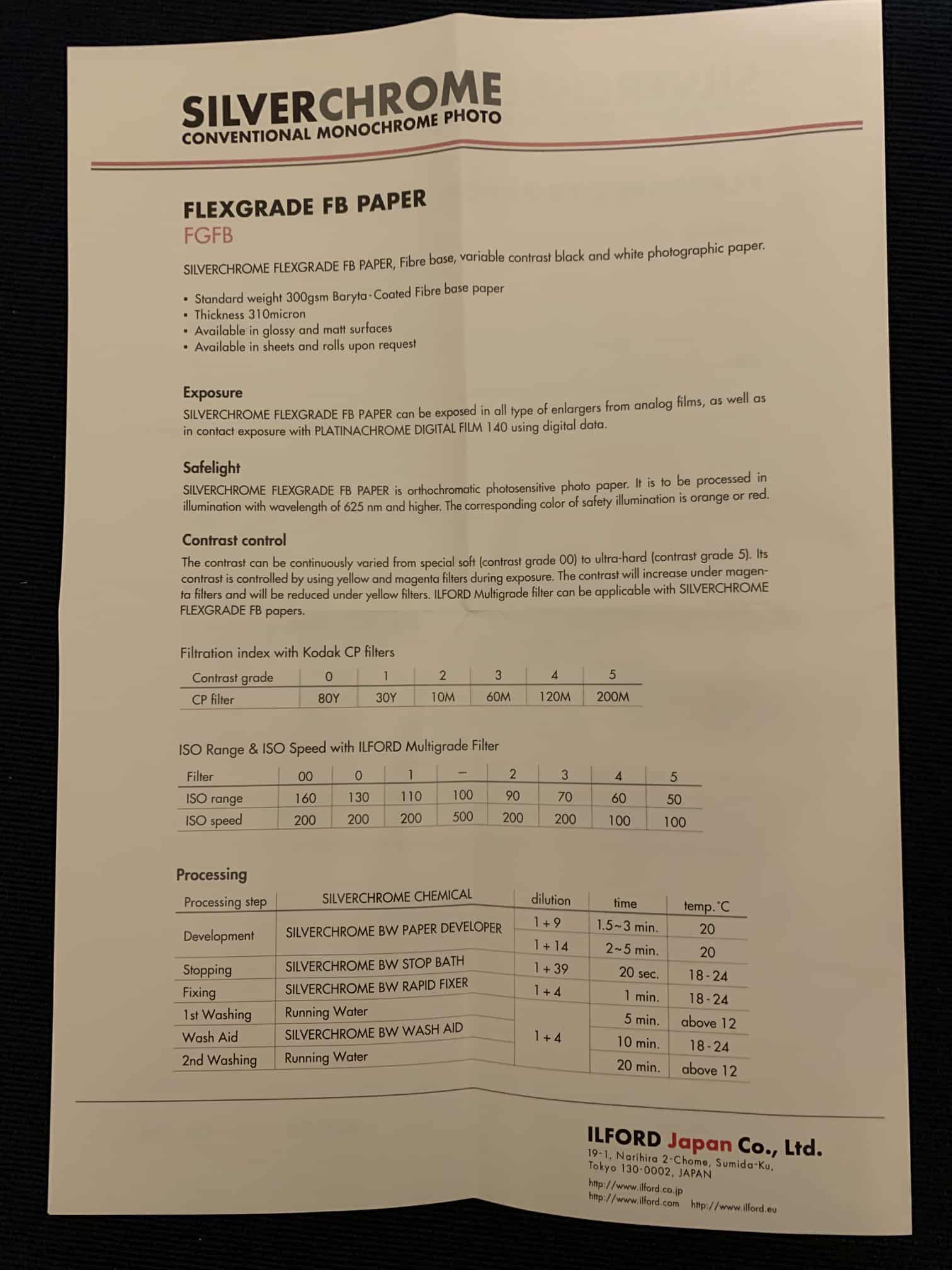

Thanks for the update Rachelle. Does the supplier / vendor offer any kind of data sheet for the paper?
Let me check when I get back home. I've got a few boxes of the Silverchrome and I don't think I've thrown the data sheets away (tbh, I never look at them).
Here's what was in the box. Interestingly, it's in both English and Japanese, something I'm not used to with Japanese papers (as most are for the Japanese market only). It also included a small digital negative with an explanation on the second page, I'm including that here as well.

@mooseontheloose thank you, most interesting, ISO range and ISO speeds are identical to those of the Ilford Multigrade FB IV paper.
