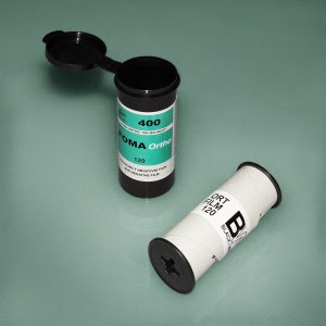

According to this Kosmofoto post, the Czech Republic film producer Foma Bohemia has announced a few orthochromatic medium-format black-and-white film which is being released this summer.
Foma Ortho 400 will only be available in 120 and Foma Bohemia told Kosmo Foto the film will start being stocked by distributors from June.
I see that it is not yet listed on their website but is available in their online shop.

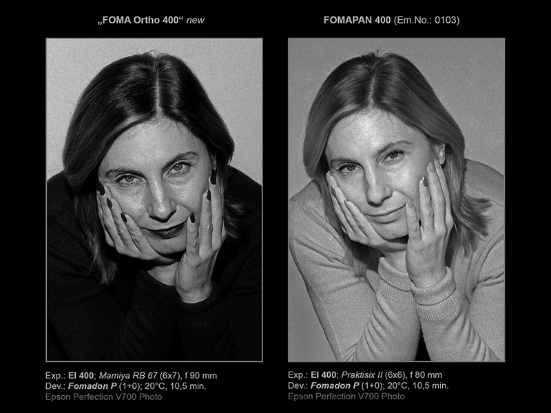

From the Foma online shop, showing the difference between Foma Ortho 400 and Fomapan 400.

Thanks that a very striking change. I presume her hair and jumper are both quite a bright red. Just a pity that all detail in the jumper has disappeared compared to the non ortho picture
Am I safe in presuming that detail in anything red should not be lost per se simply because it is ortho?
Thanks
pentaxuser
Don_ih
Jan 24, 2021
7,400
Ontario
Depends on the red. If the red is purplish, some of that blue will register on the ortho film. But genuine red won't. It'll essentially be the same as black. In other words, red turns into the darkest shadow region of the scene when you use ortho film, and any detail you get out of it will be because of what amount of not-red is in that apparent red colour.
Get a genuine blue filter and look at something red through it to see what detail you'd get.

Thanks Don. What I was thinking of is that with a panchro film any folds in a black(the red equivalent) sweater normally show up if the development is correct so I had thought the same would apply here. OK I accept there is a tendency for a black garment not to show detail in the likes of folds and development might be more critical

I see lots of grain in the examples posted by Foma, and let's remember it's in medium format. Lots of grain in medium format?
They're likely to have been heavily cropped. Foma 400 in 120 in Fomadon P stock is close to grainless in my workflow.

Thanks the Ortho shot here looks considerably better than the top close up shot
