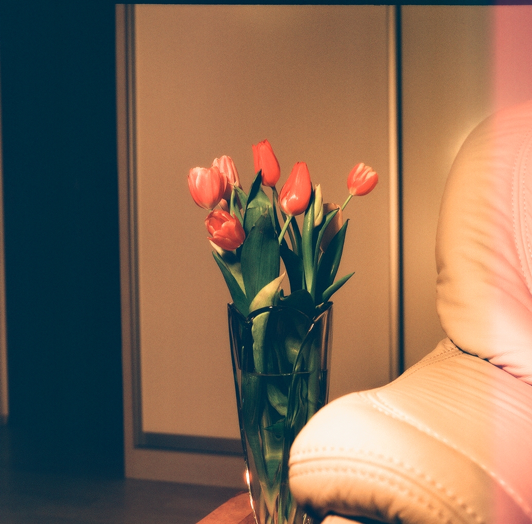

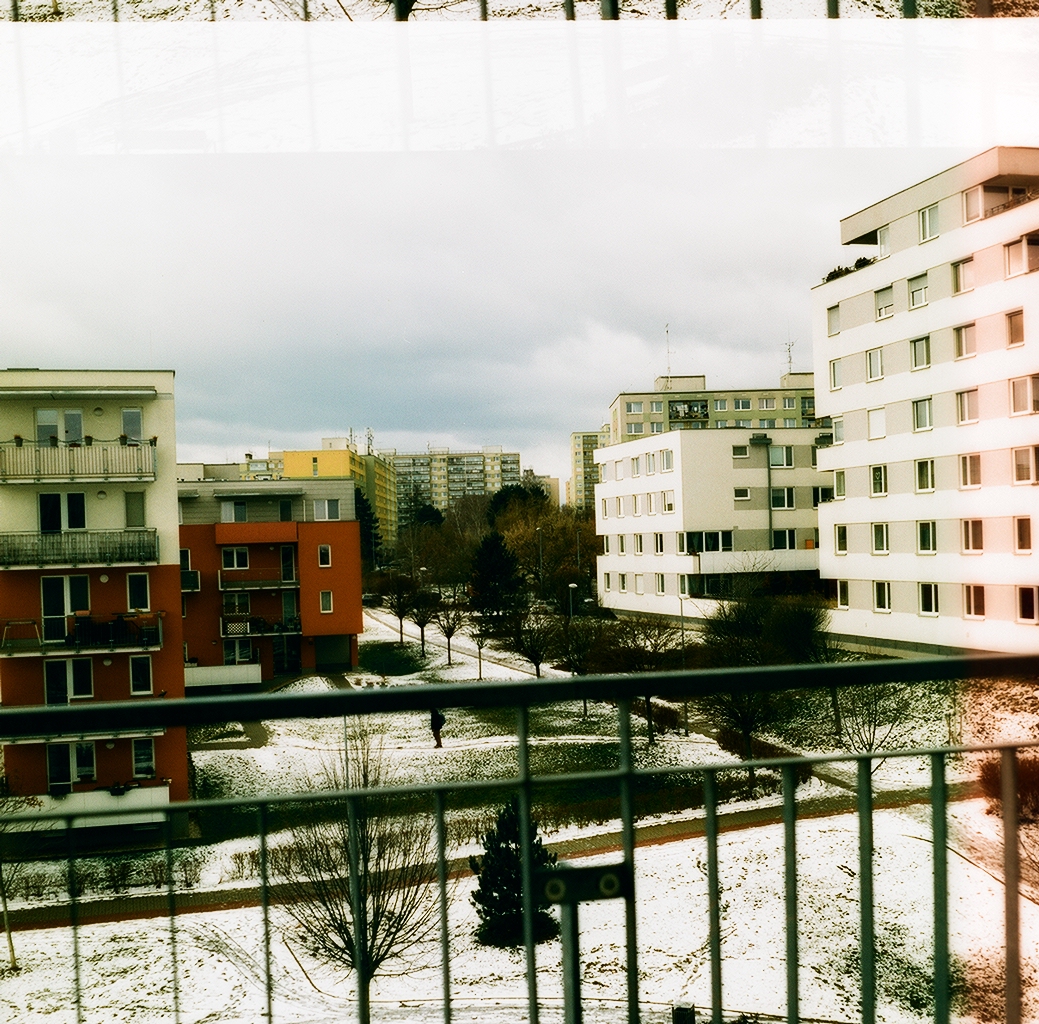

Hi Guys,
I bought a few TLRs online both listed in Like New condition. One of them really is, the other one, hmmm, nah.
Here are a couple of shots from a Rolleicord Vb that has some kind of problem with film advance and is back in the shop. These are scans from the shop that developed the film, I don't have any of that kind of gear here.
Film used was Harman Phoenix 200.
I can explain the color shift in the first shot. The sync jack on the camera didn't work so I resorted to the halogen modeling light on one of my strobes.
The second shot was out the balcony on a dreary day. I can't explain the color problem in that one but the level of overall exposure matches what I remember about the scene.
What bothers me about both is though the focus looks kinda ok, I can't tell if the lack of clarity of the courtyard shot is just due to film grain from insufficient light or if there might be something wrong with the taking lens. Or, it could be that the scans are just low-res, they did have better options but after the issues with the camera I didn't want to pay for fancy scans of a messed-up roll.
Would appreciate your analysis and especially if you know what Rolleicord shots should look like.

Looks like there's a light leak at the back of the camera; see the vertical bar on the right of both images.
The second image indicates a film transport issue due to the overlapping frame; you probably photographed the balcony scene twice (at least) and two of these images ended up partly overlapping (note top edge).
Frame #1 is also underexposed but that's a different issue; as you said, it's due to the lighting setup. Don't worry about that for now.
Mostly scanning (these are pretty poor scans) and film choice (Phoenix is rather grainy). Most of it is the poor scans though.
There are likely issues with this camera that need sorting out.
Thank you, I noticed that after I posted the pictures. I sent a copy of both the scans to the service department a few minutes ago, so hopefully they will resolve that along with the other issues.
Yes, I couldn't get the film to advance, it jammed on half the roll, and I was only able to get it to work by enabling multiple exposure mode. I had the camera on a tripod.

The film transport and counter on the Vb is fairly basic and uses a spring-loaded friction roller for the counter. When that gets dirty/gummy things go wrong including difficulty winding the film, improper frame spacing, and one wrinkled edge (or even ripped) on the backing paper. There is also sometimes an interaction with specific backing papers, especially if they are thin and slick. Servicing the body is the cure.

It would be better to see a picture of the whole film including the rebate, the processed images have exposure compensated.
The magenta strip on the side looks more like a processing or film handling issue, it's too uniform to be an in-camera leak. looking at the rebate would help.
Focus looks reasonable, I always check with a properly inclined target shot at full aperture.
I'm sorry, I don't know what is meant by rebate. I didn't get the film back yet, I just downloaded the scans online from the shop.
I didn't know what to think of it. I'll make sure they give me some kind of answer and how they fixed it, thanks to both of you for mentioning it.
