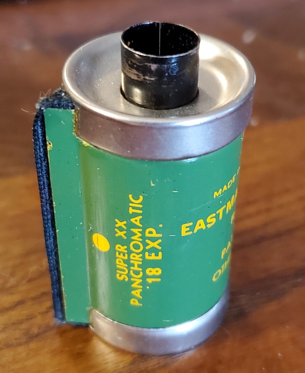

Here's the original, easy to pop open reusable Kodak cassette. Oh the good old days. c.1950

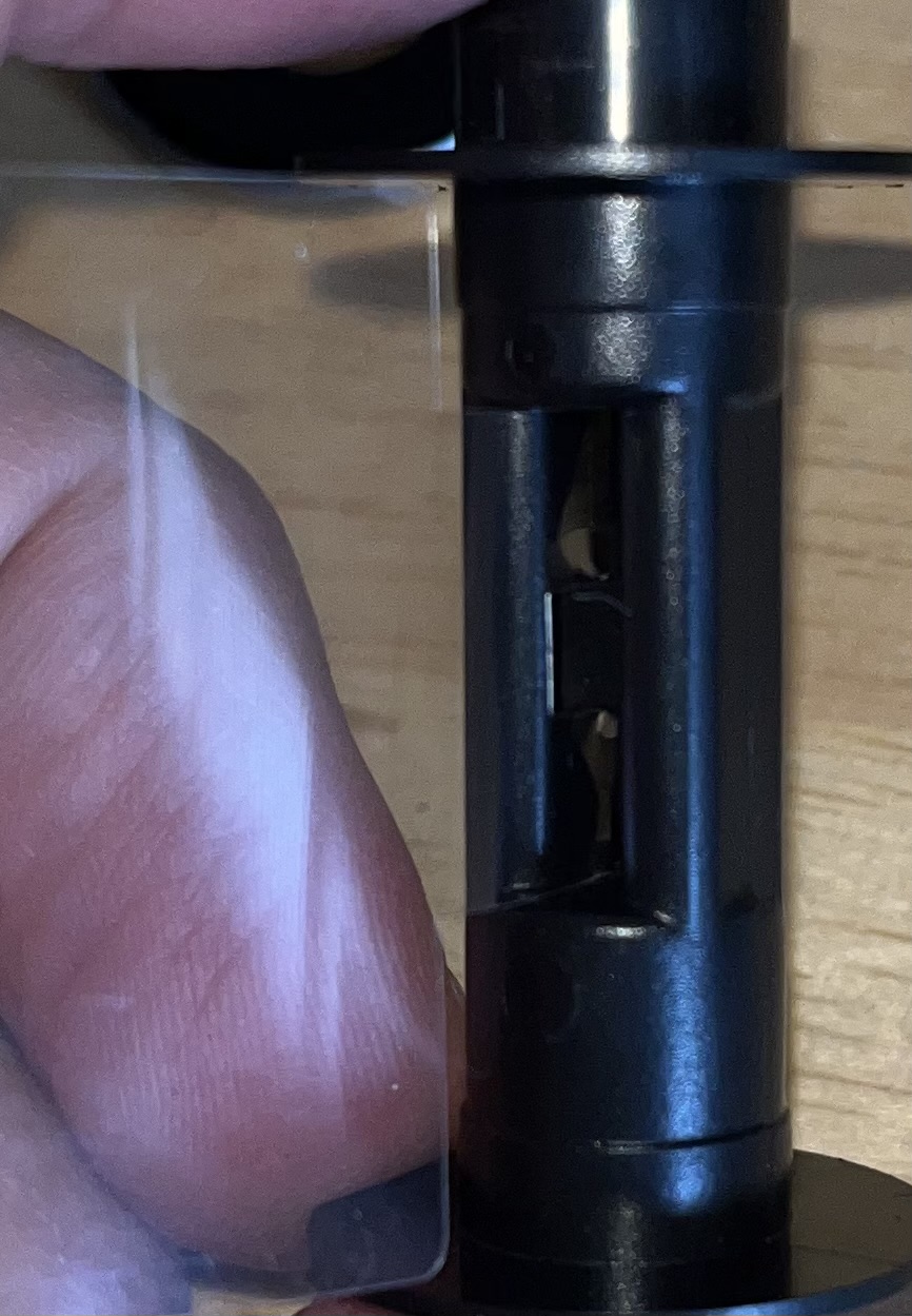

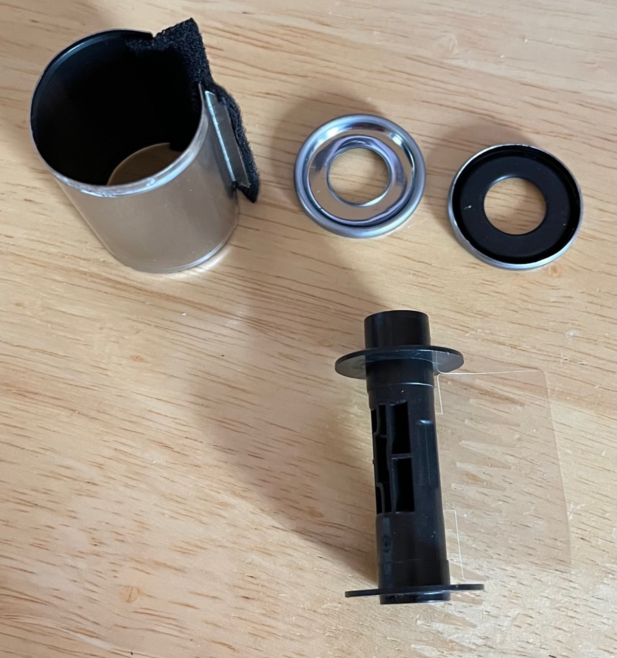

Just received mine. They seem quite solid compared to the Ukrainian ones I've been using. The caps to those look better because they overlap the canister a lot more, but they've got a ton of play. The ones on these don't budge at all.
The spool does have a little hook in the center to catch a hole cut in the end of your film, so I suppose if you feel like punching holes like that every time you load, it'd work out. They come with a little slip of plastic already attached, though, so theoretically you never actually have to take these apart if you want to do the tape-and-wind method (and therefore either never use these in a motorized camera or get handy with a leader retriever). The felt seems ok, but who knows. We'll see how they actually work out when I shoot a roll!

I purchased these items and the caps easily pop off. The plastic tongue is there to tape the film to but I cut it off and tape the film to the reel as I've always done it. Old dog and new tricks sort of thing. :smile:

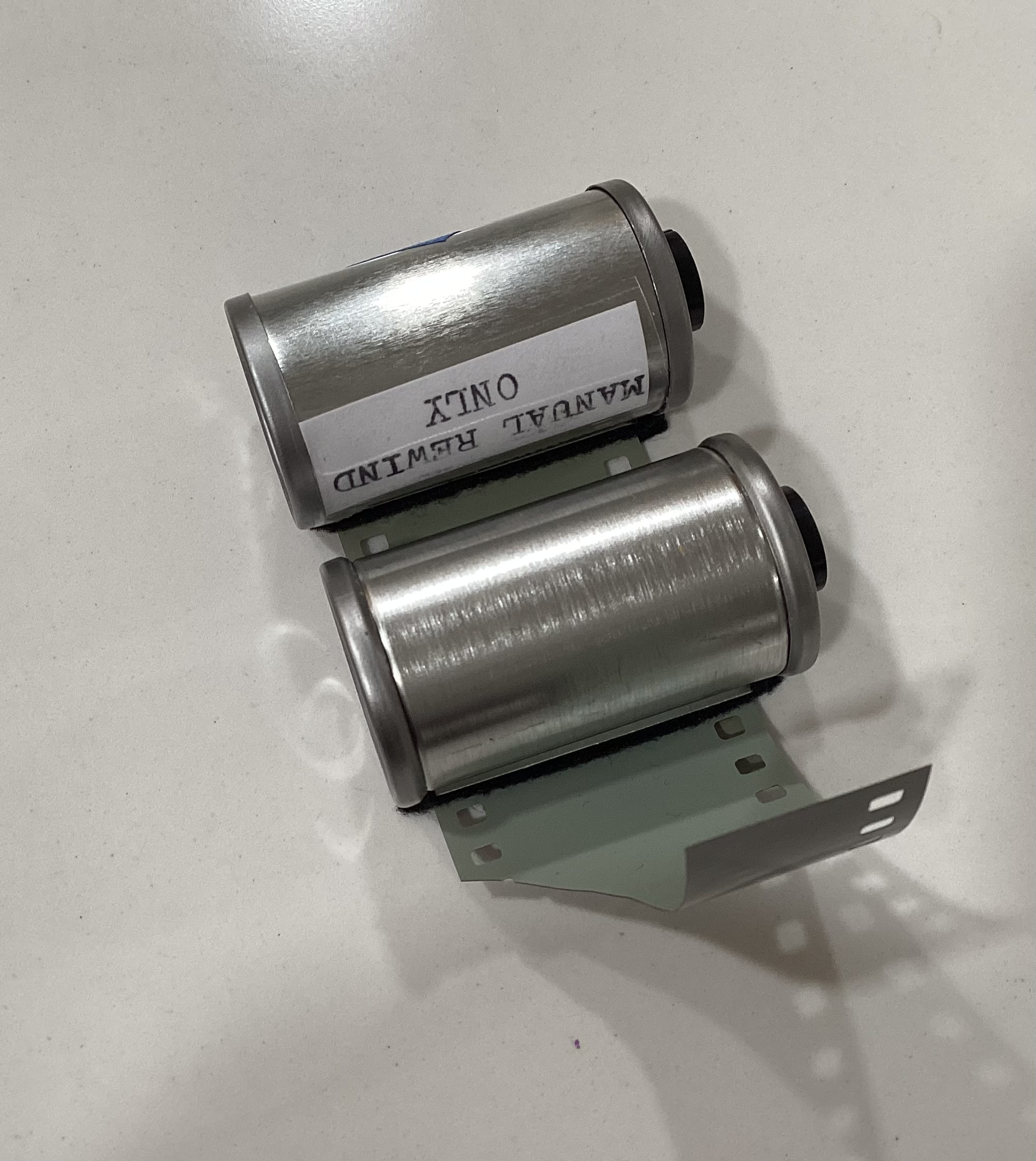

I was also shipped several without the tongue sticking out from the 2nd (and last) batch. They’re very sealed. Tried to cleanly remove the end caps but it’s like they’re soldered crimped on. I just tossed them. Happy with the 1st original Midwest Film Co. pop tops, been working without light fail issues. It’s tough to tell each batch from the other so I label the sealed versions w typed print “for manual rewind only”. Differences in appearance are distinct but minimal so easy to mistake one for the other. Bottom is original, top is sealed.
eli griggs
Nov 15, 2005
3,857
NC
When you tried to remove the cap, did you evenly put squeezing pressure on the cassette near the cap you are trying to remove?
The metal cassettes I use, look like these, but it takes put some pressure compressing the body near the 'locked' on cap to remove the lid, undamaged and ready for a new reload.
Give it a try and see if this works for your sealed cassettes.
