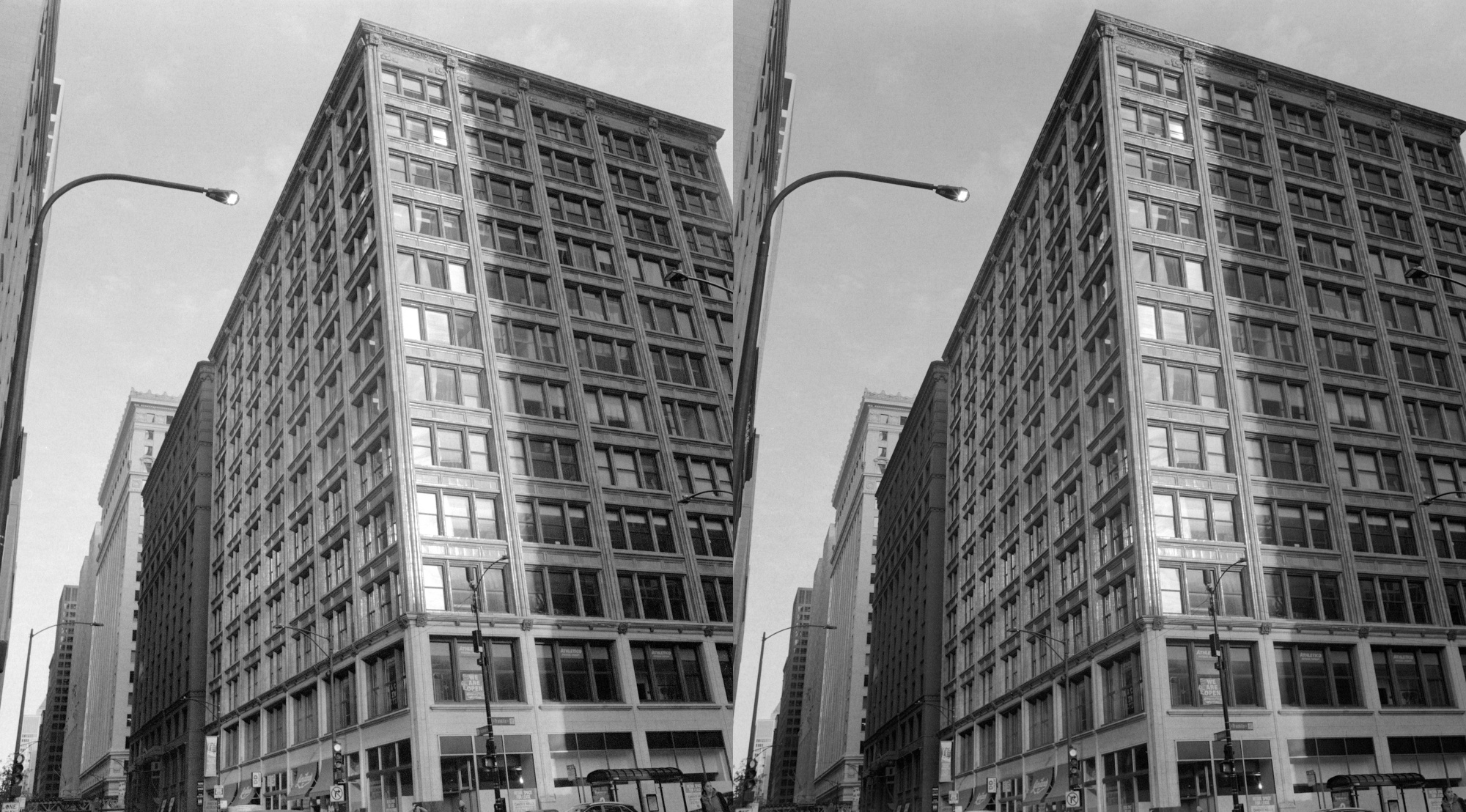

Also worth noting that the best software for assembling scanned negatives for viewing in various devices is the free Stereo Photo Maker Pro. It outputs standard SBS images like this:

Does the free Stereo Photo Maker Pro program convert normal single shot or scanned images to stereo or is it used when shooting two 3D pictures with a 3D camera? What are standard SBS images?
It converts the two views from a 3D camera into an aligned "stereo pair," as in the example I posted above. This is also called SBS format, for "side-by-side." It's the standard format for stereo photography.
