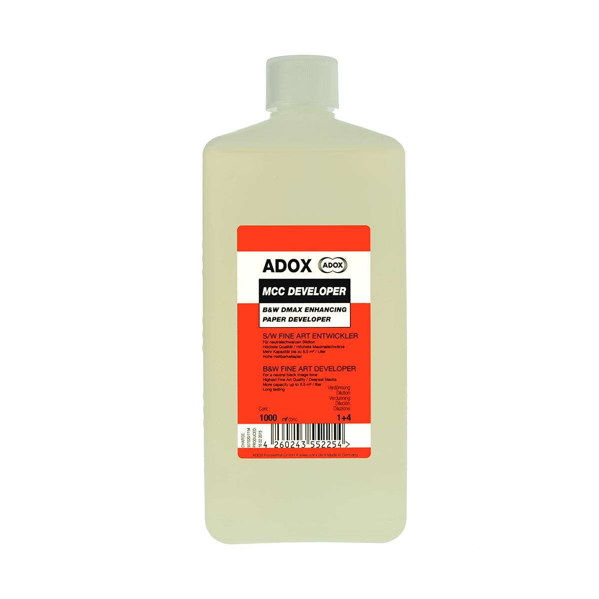

The best ADOX developer for neutral-black image tones.
From the heydays of analogue photography: Agfas* last big blast.
Especially formulated for MCC variable contrast photopaper yielding deepest blacks and extremely well separated midtones.
This developer is formulated for highest quality.
It allows a little bit more in all parameters: More capacity, a higher DMAX (about 5-10% ), less fogg and a straighter curve in the midtones.
The higher capacity almost evens out the price-difference again.
MCC developer features special additives to prevent silverslurry in developing machines and can be regenerated.
MCC developer yields neutral- black images tones with warmtone papers or a stadard image tone with coldtone papers.
Confectioning:
1000ml conc.
Dilution for machines working solution or as regenerator: 1+4 (regenerate 150ml/sqm)
Dilution in the tray: 1+4 until 1+6
