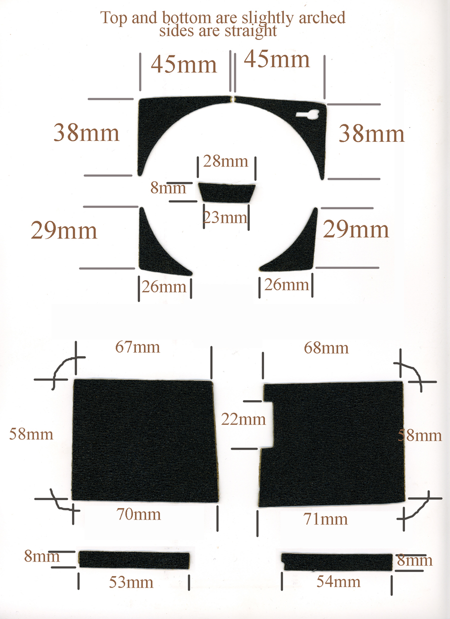

I would like to get some new leather for my Mamiya RB67 but it seems hard to find.
Anybody here who knows where to get it?
Or at least some templates to cut my own?

the textured leatherete can be bought in sheets from microtools.com. it comes in 2 or 3 textures from rough to fine gravel. use the old you peeled off as a template.

The thing is that the previous owner has changed the leather at some point and he cut them freehand so i can not use the old ones thats why I'm looking for som templates.

exactly which model do you have?
i may still have some tracings somewhere.

It's the Professional S.
It would be super if you could find them.

ive got a parts body i can peel n trace for you.
i can scan them and you can print it out? ill put measurements in so you can have a reference.
for future reference
[ATTtACH]152185[/ATTACH]
this is the peble side facing you
