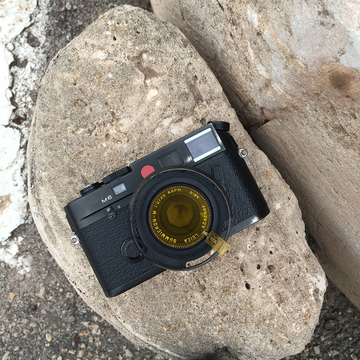

Mirko the filter looks to be an innovative design. The figure, I take it, is the lens size that it fits and if you place it into the lens thread the teeth "bite" into the lens' thread so you do not have to hold it by the tab while taking the picture. Once you have finished with the filter you simply twist the filter out of the lens's thread withe tab and it can be placed in a filter holder like the flat gelatin ones
So a set of filters can easily be carried and if you want to use a polariser then your filter fits inside that and avoids any possibility of vignetting that can occur with two normal filters

Correct. The filters have been released to the market earlier.
https://www.fotoimpex.com/cameras-accessories/filters/adox-snap-on-gel-filters/
We currently have an 85B for the Cinestillfilms, a yellow filter and the dark red/IR. We are working on "true IR", green and others.
