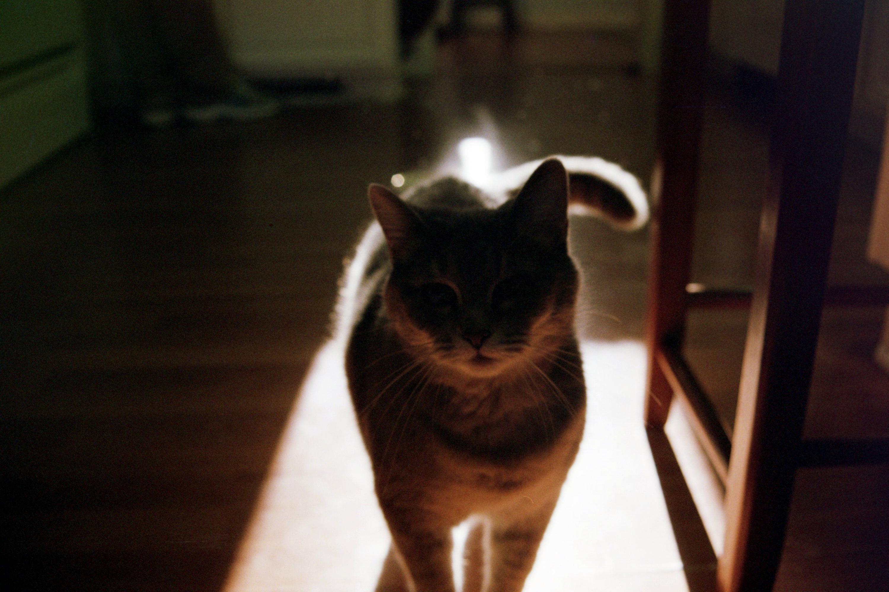

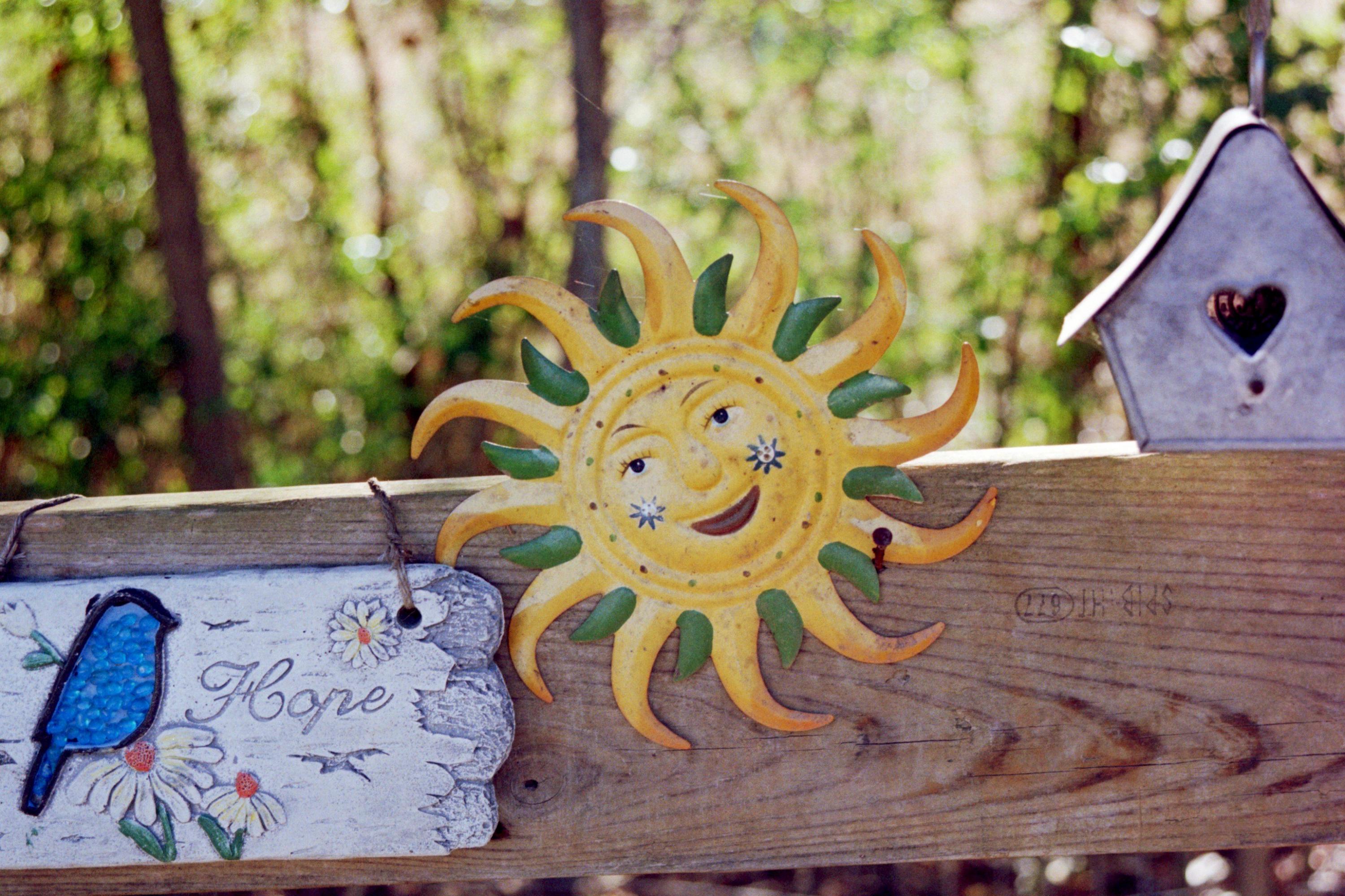

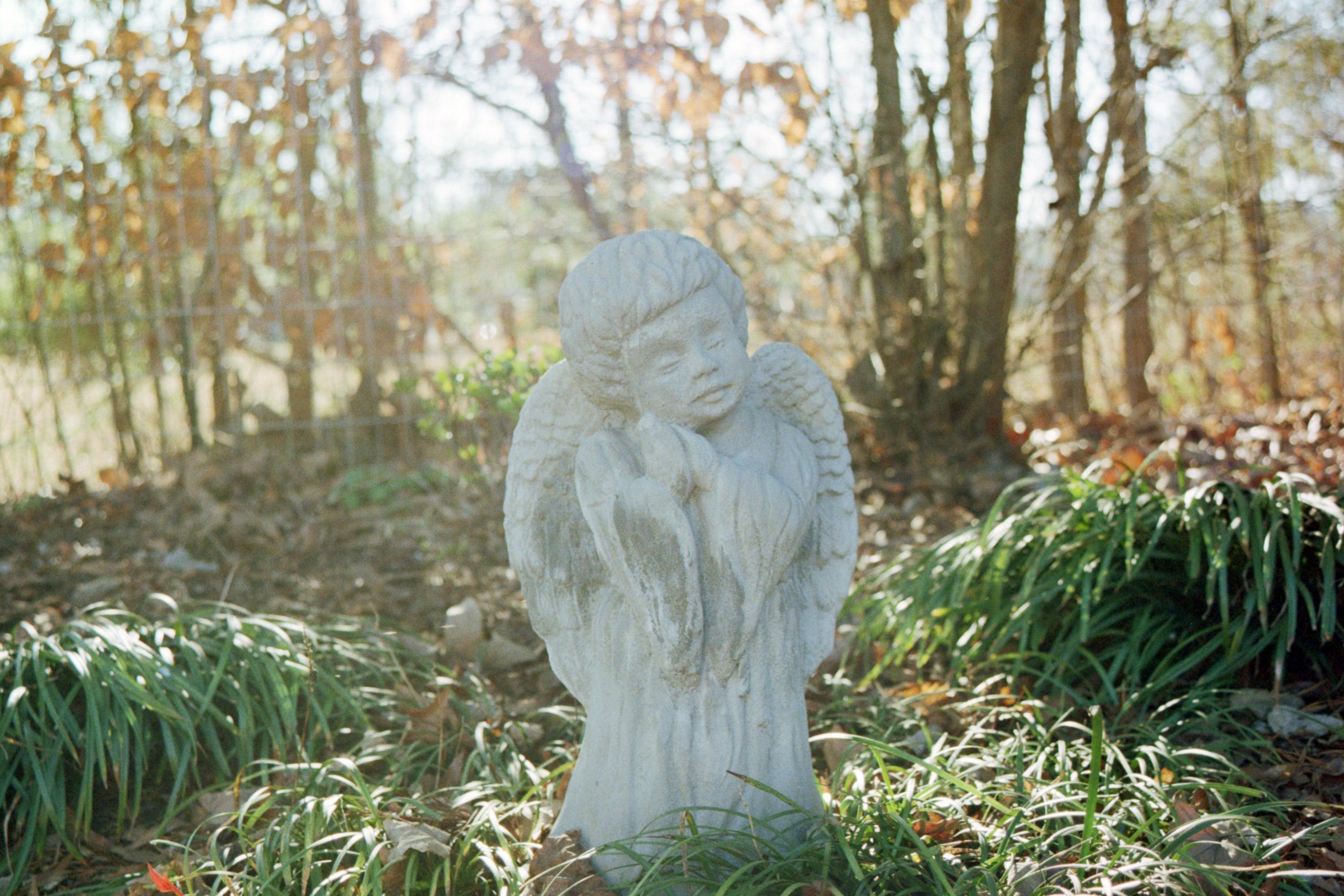

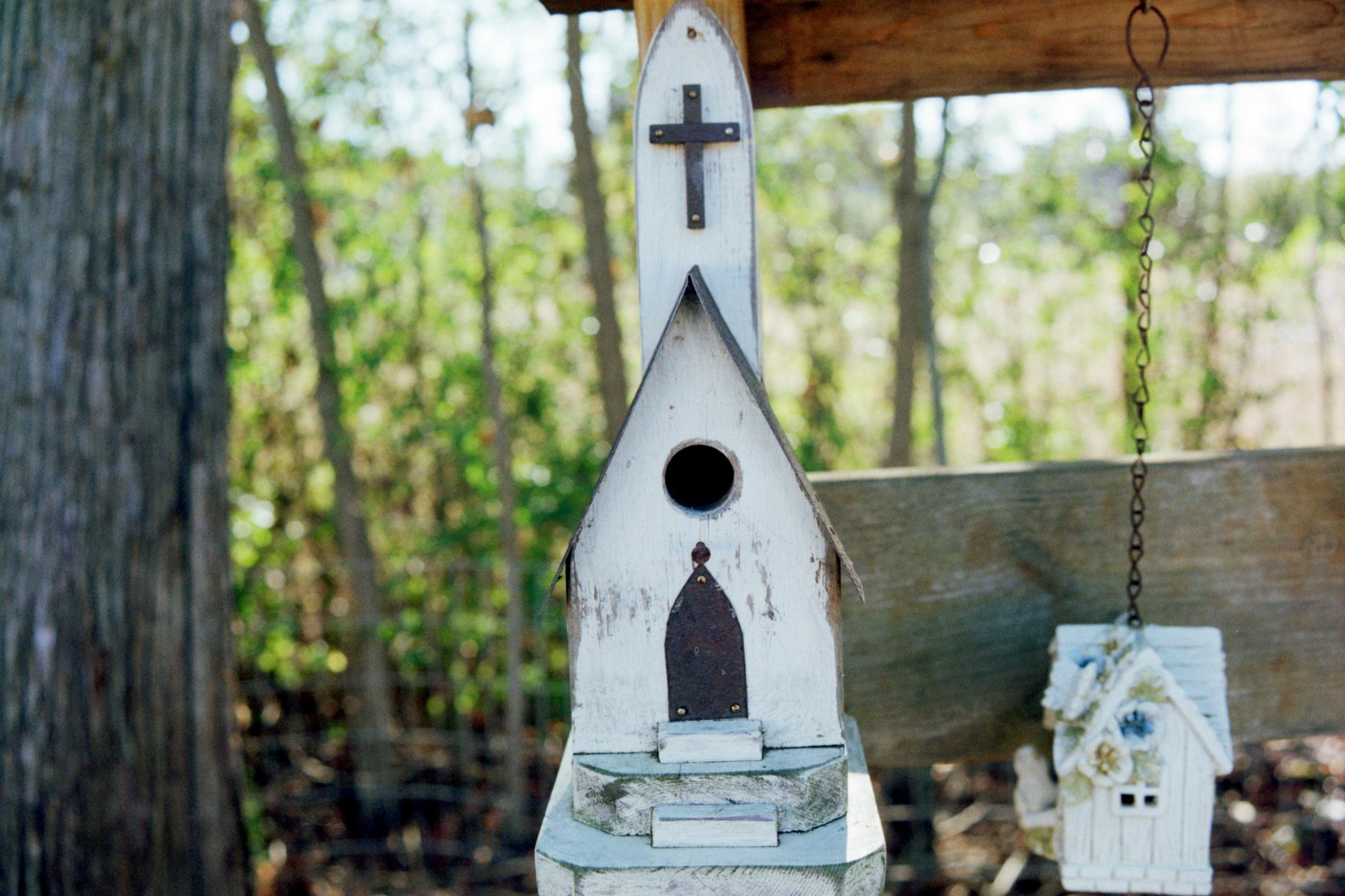

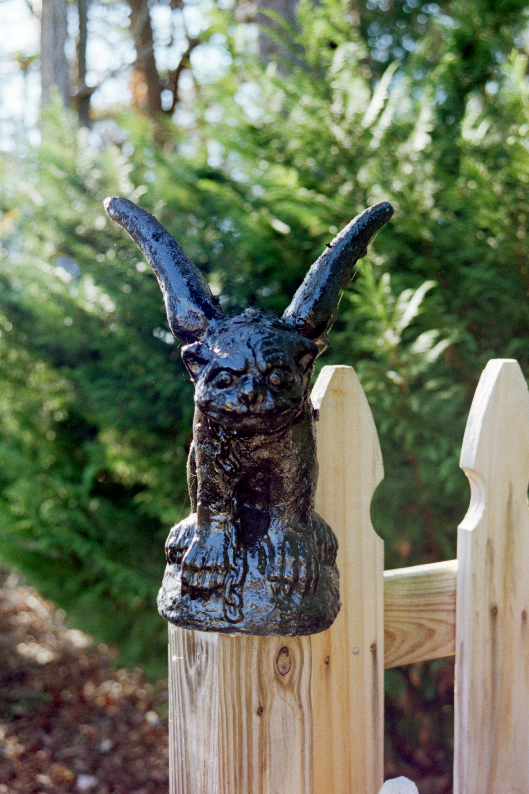

alright so i got my first two rolls back from walmart, and i have to say i have a huge problem with my silver camera(or the lens?) every photo is underexposed cause i had no idea what i was doing but on each side of the picture its yellow, i will upload a picture of it once i get them transfered but on another side, my black camera with foam problems and a 35-70 zoom lens works perfect! i got some decent first pictures to share and see how i did

When a side of the photo is yellow, that usually is an indication of a light leak. Check the negative.
If you purchase any camera that was made between the 1960s and 1980s, you almost certainly will need to replace your light seals.
Open the camera and run your finger along the back. If you get a black line or it feels sticky, replace those light seals.

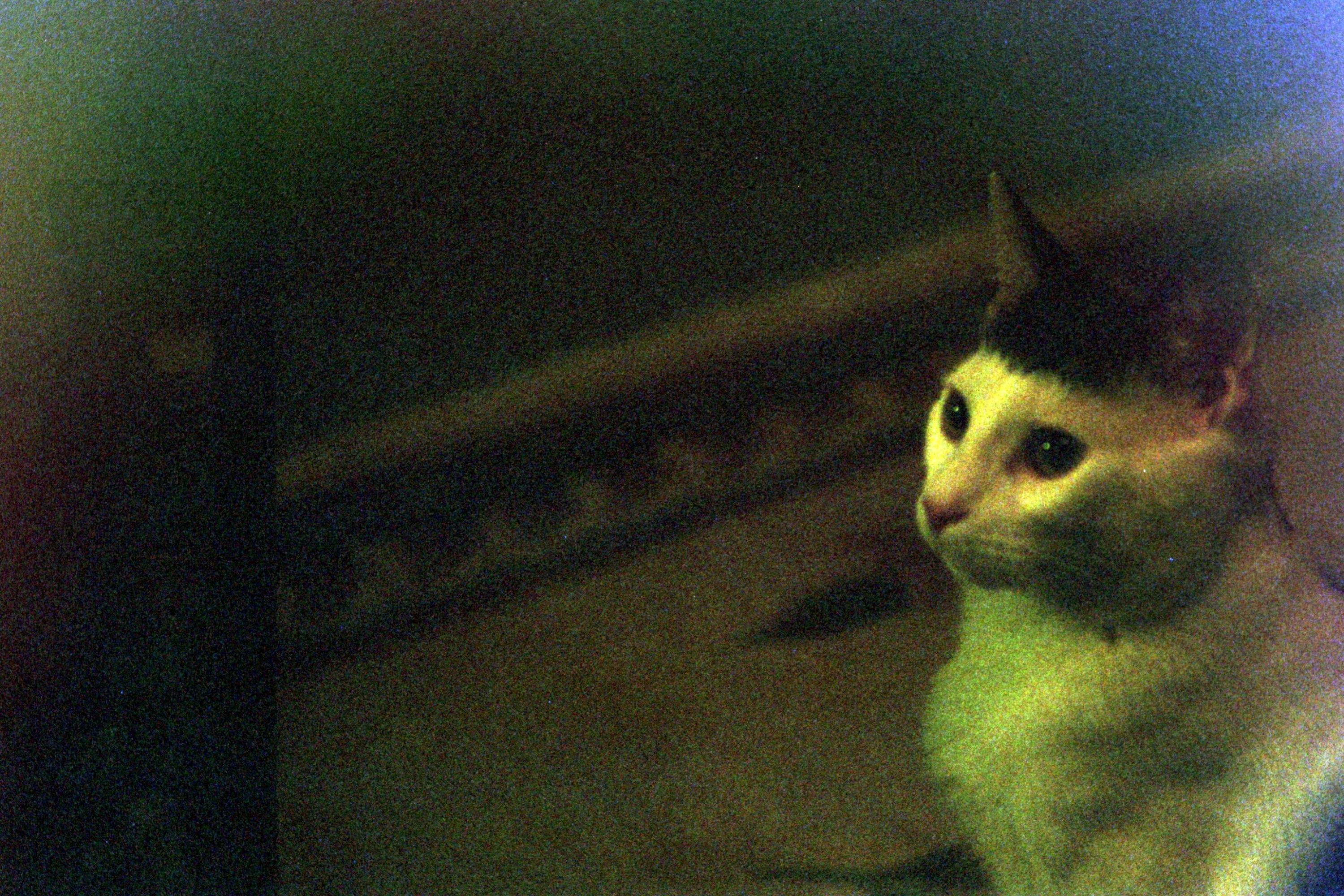

here is an embarrassing photo i took, ashamed it came out so bad but it gives an idea of how bad the silver camera is, i believe the black AE-1 is fine for the time being though so not all hope is lost

Well if you have light leaks most likely you just need the seals replaced.
As for the underexposure, take a meter reading with the silver camera and then take a reading of the exact same scene with the black camera. Your light meter in the silver camera could be bad.
