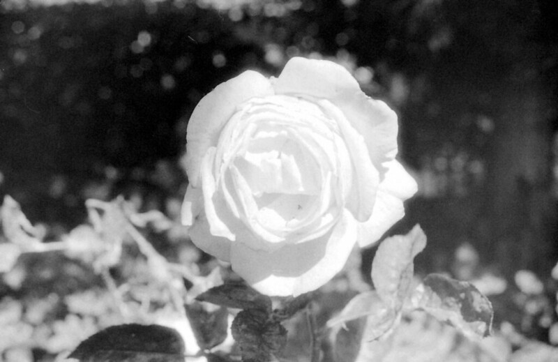

I have now developed 2 rolls of Retropan 320 together with one Fomapan 400 shot at EI320.
Link to Flickr album:
https://flic.kr/s/aHskeLkPsf
Here is a picture from a doll. Her hair is red.
Model doll in Retropan 320 by Ricardo Miranda, on Flickr
These films were all developed at the same time, on the same tank with Fomadon R09, 1+100 stand development for about 1 hour. 4 inversions at the start and 2 at the end.
Negatives were scanned by a low resolution (5MP) Ion "scanner". It is like a mini digi camera.
Looking at the negatives, there is a noticeable difference in the negatives from Retropan. They are lower contrast.
The scanner probably picked that up and pumped the contrast.
There is a shot a window dressing doll I took in 2 different days with R320 and F400, but it was the same object.
My personal opinion is that Retropan 320 is a very good film with a lot of tonal range and lower contrast.
I like it a lot.
Lower contrast is rather good. Foma films have the habit of building the contrast really fast.
Is it me or is Retropan a bit grainier than fomapan 400 it also appears less sharp but that could be caused by the lower contrast. The skin tones seem very nice though and have a certain glow about them. Thanks for info and link. Will try the film.
these are very high contrast images , you cant expect different from 1:100 hour developed film and nikon lens , I remain with tri x or apx or fp 4.
First, I'd like to thank the OP for the images, I think I'll give 320 a whirl one of these days.
High contrast?! Most definitely NOT high contrast.... Imagine using a 5 filter on these images... then I could imagine these being high contrast. Also, keep in mind that the OP stated that the scanner might have boosted contrast...
Also while development and lens have an impact on the final image . It by no means dictates the whole picture, there are other variables which affect it, especially the relationship between film/contrast.

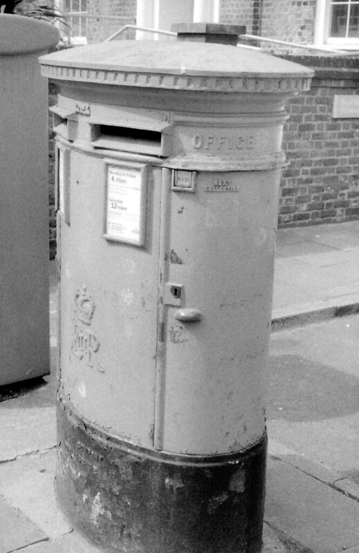

I have to admit to a sin when I developed this last batch of Retropan 320 in the Retro Special developer: I didn't check the temperature, so I know it was over 20C as the tank felt warmer. That's when I realised i hadn't check the temp.
Sorry!
Here is one more. I think many people would know how red these Post Office boxes are:
6-24-2015_004 by Ricardo Miranda, on Flickr
