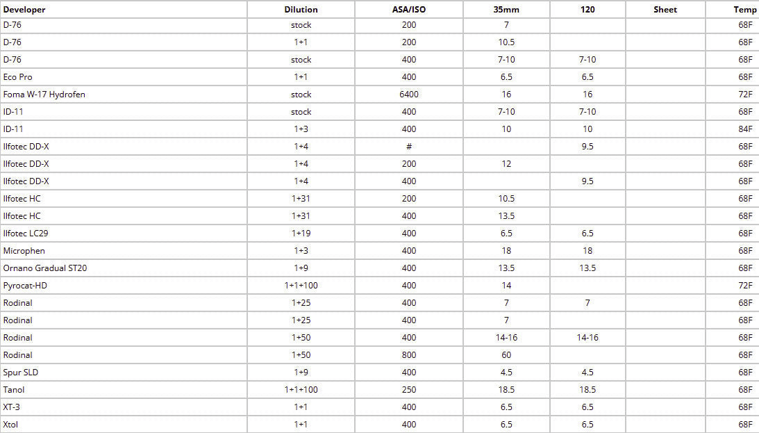

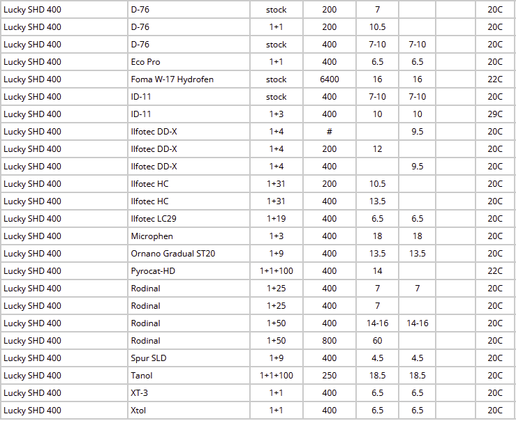

The times listed on the sales page are those for Lucky SHD400. Compare:
To:

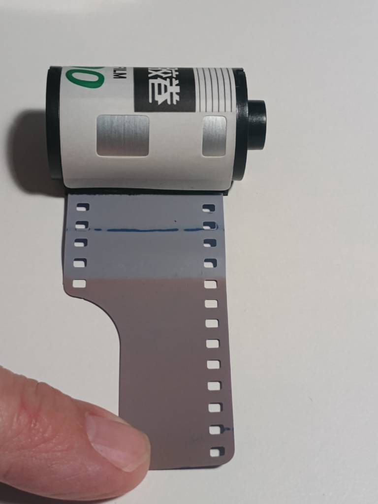

The blue base color reminds me of the Lucky SHD 400 and its original type Lucky Aerial Film 1023(real ISO 160). If the film is very thin and has some smell, it can be confirmed.

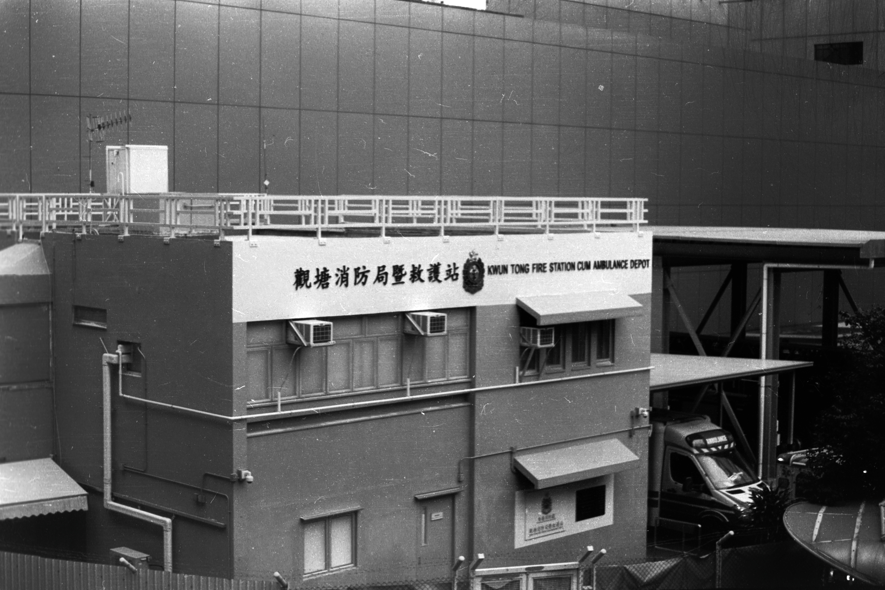

SHD 400 is one of the cheapest B/W films available in China, but it doesn't have good reputation as Foma. Personally, I haven't experienced serious issues with it (as shown in the attached image, the scratches were caused by my scanning, not from flim). However, many users have reported various quality problems, including scratches, defects, and even mold. These issues might be due to older stock film source that wasn't newly produced, which may also result in lower actual ISO.

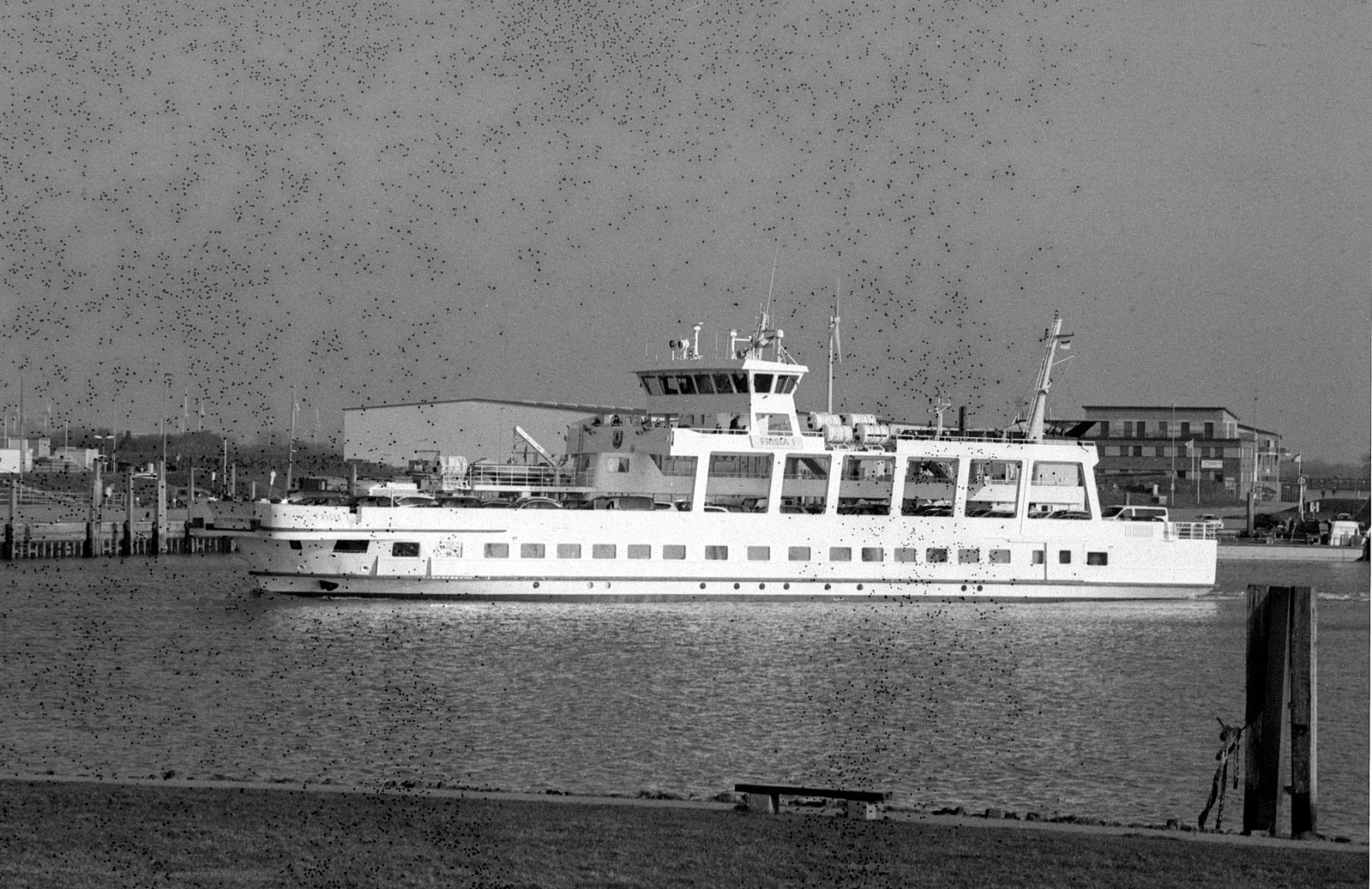

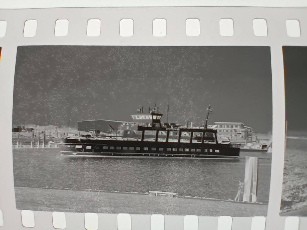

My Lucky SHD400 came out as follows. I was not lucky at all. Scrap.

Back to the topic. The development time for Xtol/XT-3 is way too short! With 6.5 Min. at ISO 400 you may end up with very thin negatives and empty shadows.
I had Lucky SHD400 in XT-3, 1+2, 18 Min. with good density at ISO 200. With 1+1 I would expect 12:00 Min.
Maybe you will be more lucky with a different charge of the material. My defective sample had the expiry date 06/2027.

The blue colour looks like an anti halation layer. In fact I don´t see any halation. The color disappeared completely in the processing without any bleeding. The film base was nearly clear after the processing.
There are no frame numbers or other information at the perforation.
