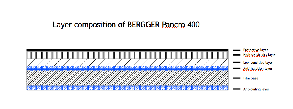

Mes félicitations for this new products. I have the same question as Wildbill how close is it to fortepan, will it be a thick layer or thin layer emulsion?

Well, as you know Forte closed its doors in 2006.
Our wish was to elaborate a modern film, with classic grain.
So Pancro 400 is a two layer emulsion: one fast emulsion layer and one slow emulsion layer.
IN addition to that Pancro 400 has one of the best anti halation layer, and a protective layer. That is 4 layers.
