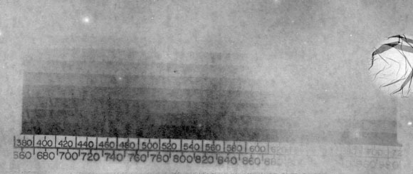

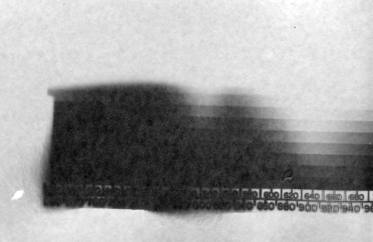

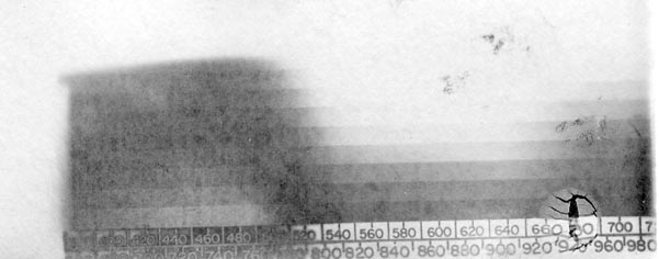

Results are in
I have sensitivity studies on the new emulsion. As of yet I have not spectrally sensitized it (made it an ortho sensitive emulsion) and so you will have to make comparisons between raw, sulfur sensitized and sulfur + dye. It isn't hard if you just read below.
Picture #1 on the left is my 40 speed emulsion with ortho sensitization. At this point, no sulfur has been added and so it is about ISO 12. In the middle, you see what happens when you add the sulfur sensitization. The area under the curve is the speed of the emulsion.
On the right is the new raw emulsion. Its raw blue speed is nearly the speed of the middle emulsion which is ISO 40, and so when I finish the sulfur treatment, it will probably gain 1 - 2 stops at least.
The emulsion on the left was about 2 months old. It was the one shown in the DVD still posted here and has aged a bit unfortunately. The one on the right does not have green sensitizing dye. Why waste dye on an experiment? :D Right?
So, I think I have made a step forward. If this works out, the next step will be ISO 400. I lie. I gotta do all of this well before I go on from here and I think it will be too easy to fog it. Look at what happened to the one on the left. Too much light (IR) and time filming the DVD made it rather foggy. I also have to perfect UF washing, pumped makes and all of that stuff.
The defects you see are blisters and repellancy spots due to the fact that I used such small samples these were coated with no surfactant or hardener. For those that claim that an acid stop causes pinholes, the blister on the left scan shows how it actually shows up on unhardened or poorly hardened film. Not a pinhole, a blister.
The peak on the right is an artifact - a harmonic of UV, as I did not use a UV filter.

Is that solarisation I see on the right scan?
It looks as if the numbers are lighter than the rest, and there's a lighter area in the lower part of the test?

I am puzzled myself, but I think it is due to the extremely high speed. It is also probably helped by the lack of sulfur finish and by the lack of any other 'normal' addenda. But, since it is new to me, give me time to check it out properly. These are preliminary or first tests of something entirely new. I should have pointed that out.

Ole, in answer to your comment about solarization, the second batch also shows that same oddity, so I suspect that the new emulsion is more sensitive to solarization. Now, what is different, well, the Silver Nitrate is a new batch from a new source, the Gelatin is from a new source, and the Ammonia is from a new batch but old source. So..... One of my fellow engineers said I should take George Eastman's advice and "pray for the emulsion". I'm going to take that advice seriously.
But, the higher the speed, the harder things are to do "right". The emulsion will probably be about ISO 100 in-camera from my estimates right now.
