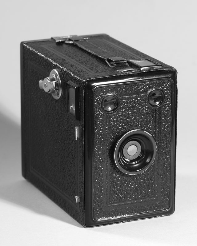

I've been wondering if it were possible modify a box brownie to use this paper? I am a beginner (have only developed - haven't tried any printing yet!) so not sure where to start. If it is possible - any suggestions on where I could find some info to get me started? Many thanks.
They will be small but beautiful. Are you thinking to leave the lens or replace ir with a pinhole as I did?
That's awesome Ralph! I was thinking of leaving the lens on for starters - what do you think? Any hints on how I mount the paper? Your new book sounds amazing BTW...
Considering the paper is already a very slow EI 3 or so according to the posts here, starting out with a camera with lens might not be such a bad idea...

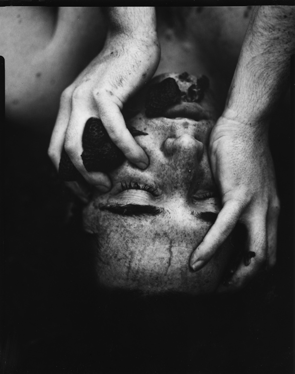

I used it like sheet film, and the results are stunning. Hot contrast yet very controllable. Unlike the Efke stuff. I am in love with it!
Even for skin tones, the hard part is making someone stay perfectly still for 1 second or more.
wow, thats an amazing example. i might have to grab some. ilford should use that photo for advertisement of the paper and its capabilities. care to share your method.
Nice result. Are those strawberries? It must be really orthochromatic, which I guess makes sense, since you can use a red safelight, no?
Thanks, those are strawberries, yes. The entire series is up on flickr (here).
It is very orthochromatic, which is why i decided to use strawberries. It was shot in my Crown Graphic, Sironar-S 135mm wide open. Develop in Dektol. Fin.

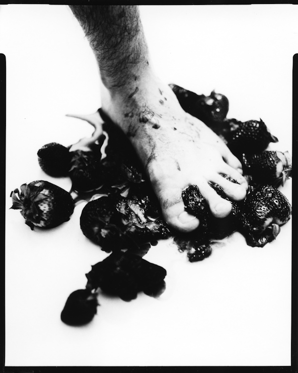

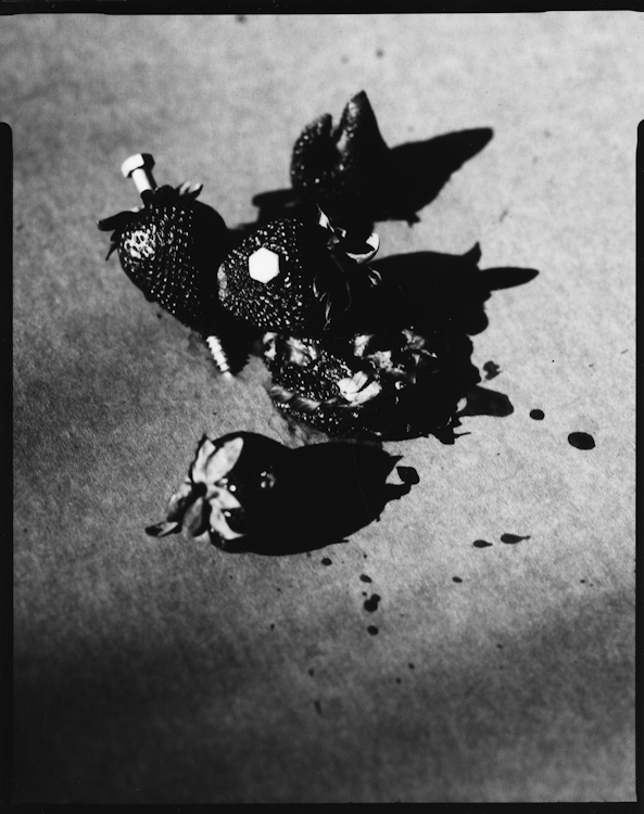

And two more I took to see the extreme ortho properties of this paper:
These are great images, Brad; thank you for posting them.
Can you give us any tips about exposure and development of this paper? I found with the Efke paper that it required (for me) severe amounts of preflash exposure, for which I had to ultimately fix a standard exposure time, and vary the light and/or the aperture to adjust exposure. Most of my first pack has been used up just in calibration tests.
~Joe
There was no preflashing involved, I found that shooting in overcast situations completely mellowed out the contrast situation. I did use that contrast to my advantage though. The higher your dilution of developer will also change the contrast of the paper as well, so I used 1:3 Dektol. I'm going to try other developers too, but this worked like a charm. And at an EI 3, it can get even trickier. The days I shot these it decided it was going to be windy, so some shots were wasted because of that.
I too used up an entire pack of the Efke and Harman stuff for calibration, it's hard to get the hang of, but I believe I have it pretty well dialed in for my use.
