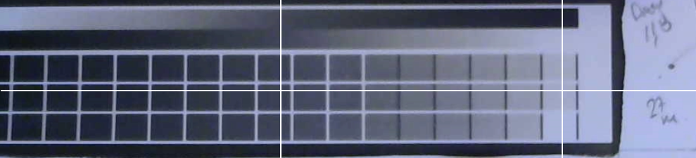

Question & Update/2: with just one drop of Na2 5% (16/FO/16Pd/1 Na2@5%) I get awful grain, this can be humidity right, Is the paper too humid or not humid enough? The same chems and mix and paper have been used two weeks ago in my previous darkroom where RH was 70% without grain. Paper is Hahnemuhle Platinum Rag.
Method followed:
Humidifying chamber 15mins @ 70%
Coat and natural dry 5 mins, a quick blowdry in medium heat after for a minute or so, paper feels dry
Humidifying chamber 8mins @ 70%
Exposure for 27mins

You certainly are running into just about every issue a pt/pd printer can have... :wink: White specks or "grain" are really tough to nail down a cause. Paper can be the issue, but you're using the same paper; I'm assuming it's all from the same batch? I'm assuming, too, that your brushing technique is consistent. You could try soaking the paper in Oxalic acid. Do you have a different paper to try to see if same results? Sorry, but pt/pd printing can be a continual process of experimentation and resolving issues because our supplies, like paper, for example, is not necessarily consistent. When I need paper, I buy as much as I can from one batch and test it. Manufacturers change, raw materials change, it's a moving target!

Could it be that 15 minutes is not enough to equilibrate the paper? I am assuming you had the paper stored at high humidity all the time at your old place which might have been needed to be saturated with water. Perhaps leaving the paper overnight or longer in the humidity box may make a difference....grasping at straws.

I tried two different boxes of Hahnemuhle (8x10 & 11x15) and it is the same i used two weeks ago, I also have 50 8x10 sheets of COT320 on the way and I suspect it will be much easier as i consider it a forgiving paper. I cannot be sure of my coating technique, of course I am trying to do the same strokes each time but maybe I am not, its the time that I am not sure of anything. In general I brush quite some time since there is plenty of extra mix usually
After my post earlier today I did another test, printed a 51step wedge on 2x16in coverage 5FO/5Pd/2Na2@1% and I got a nice smooth non grainy print following exactly the same method, same paper, just flat at midtones, need to fix the curve, but Dmax was very low 1.18, phew (apologies for the bad image)
Yes you are right, paper was stored at old place in 65%-75%
I tried also 24 hours in the humidity box... same results. can it be FO? something happened to it ? I am only 6 months in this so my experience with Fo is limited. i see crystals at the lid lately :-0 in general my chemistry box is stored now at 30 Celcius while before ist was at 22 Celcius

6 months on the FO is about its max lifespan as far as I'm concerned; especially, at your higher storage temp. I never use FO beyond 6 months. I buy it in powder form and mix when needed. The metals, of course, are all fine.
