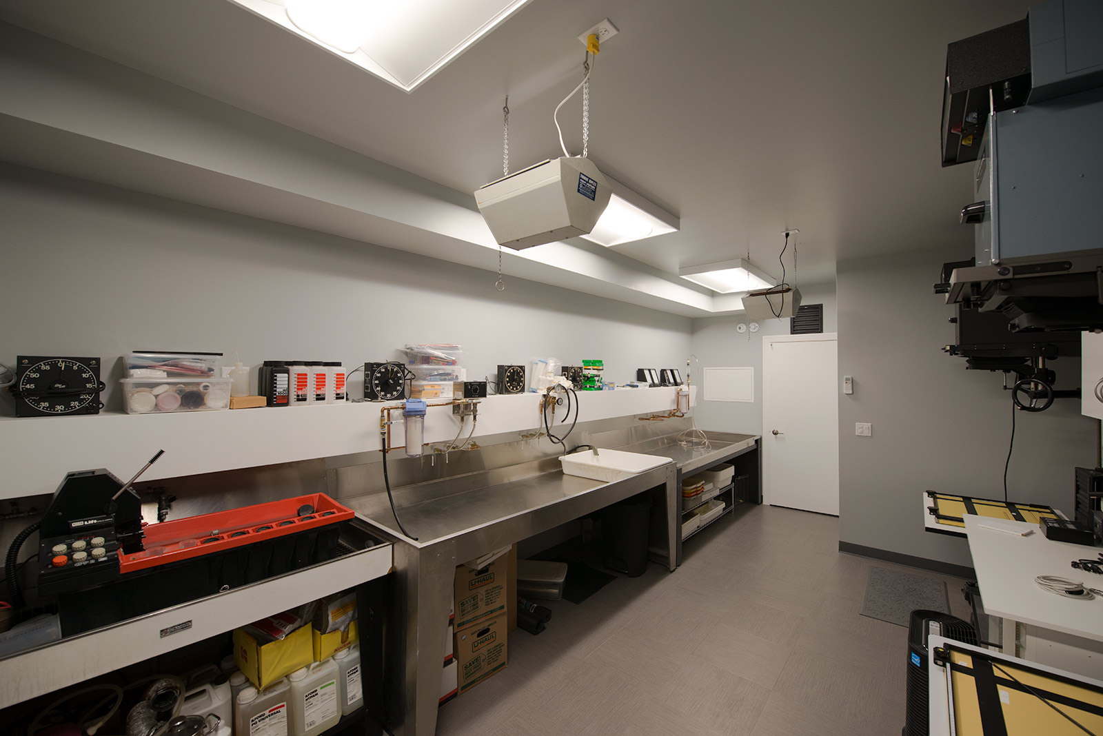

View attachment 151911 Claudio, here's the sink side of my darkroom. You'll notice a long white shelf. About 20 inches above the sink. That is actually and air duct hooked up to an exhaust fan. On the bottom of that duct are vents that are positioned over the dev, stop/fixer and toner trays. Due to it's close proximity to ALL the chemical trays it's does;t allow fumes to build up in the room and you draw the fumes out right off the trays.
I'll send some jpegs of the line over the sink, if you go that route you have to make sure you screw the end brackets into a stud or have them span two studs, because when you tighten up the cable to make it level there's significant tension on it.
Also if you can go to a 96" sink instead of a 84" you might be better off.
What color do you call your darkroom? That's the nicest shade of gray I've seen.
