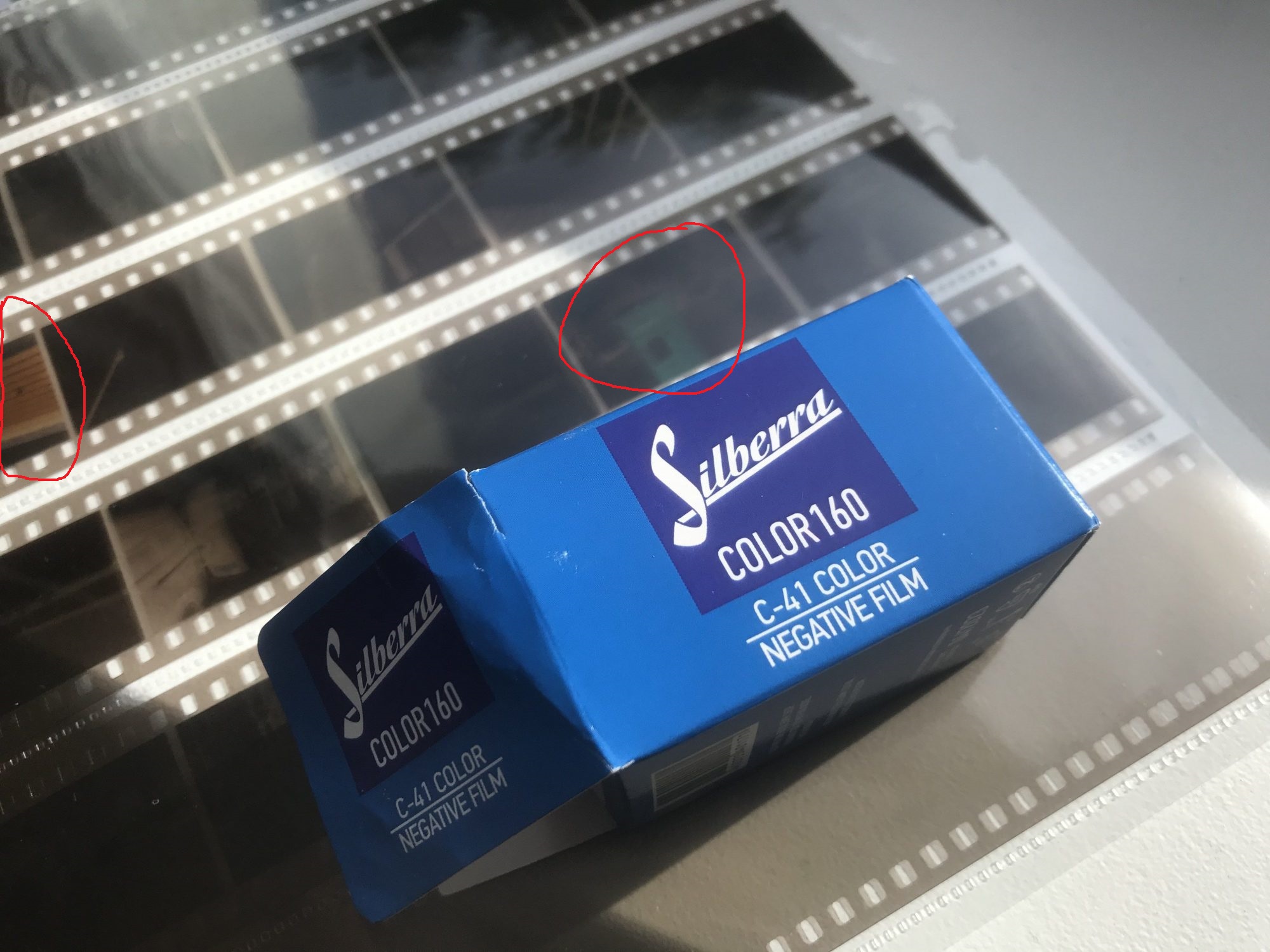

That comment mentioned the film is maskless which it is something not mentioned anywhere.
Yes I saw that and the main image (used in the header) shows what appears to be maskless colour negatives in sleeves.
Stephen said at the end of the article "Kosmo Foto has already developed (but not yet scanned) the roll of Color 160 which shows no edge markings at all. (Note: We’ll be following this post with a first roll report in the coming weeks.)"
I look forward to reading the results.
If you are referring to the picture in the Kosmofoto article, that appears to be B&W film. It is not a good picture, but none of the frames appear to show any color. I've been waiting for one of the major manufacturers to lose that d@mn orange mask and give us something like the Digibase that could be processed as C-41 or E-6.
On my screen I can see some colour in the non masked negatives. (I don't think it is backlighting/reflection colour). See below. They remind me of the old Agfa CN17 maskless negs.
