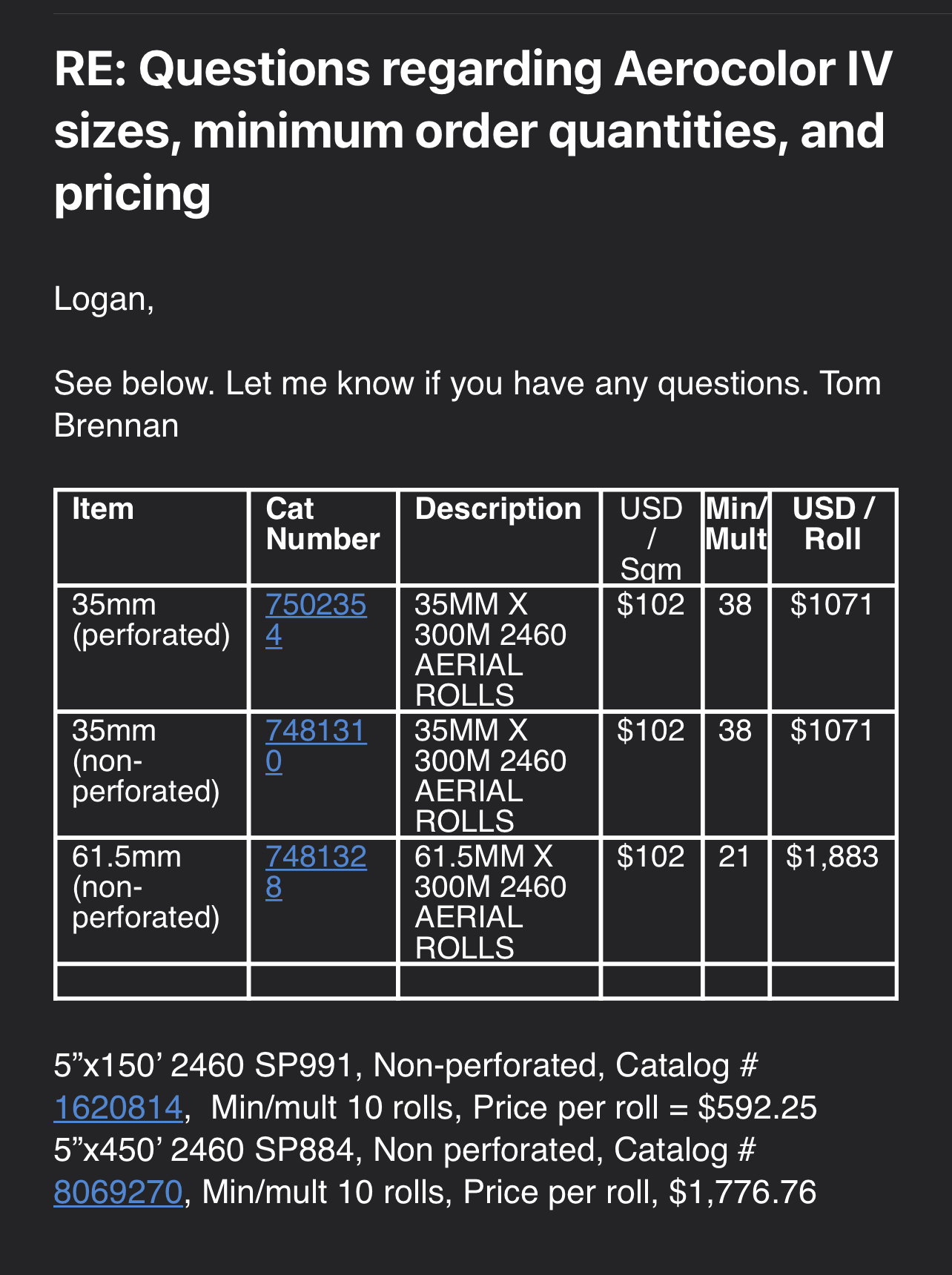

Am I reading it correctly that a five inch wide 150 foot roll is about $600?
Yes, but min order is 10, so really it’s $6000 for 1,500 ft of 5” film.

It is not a film they normally sell to consumers. It is an industry specific film that was never meant to be used in consumer cameras. Thus, they don’t want to use the very limited finishing capacity they have on such a film. The only reason that we have respooled aerocolor in small formats like 35mm and 120 is that the folks buying it are willing to buy a large chunk of the master roll, 300M, or just over 1000 ft. Kodak slits and perfs it, but customers must package it themselves.
The only exception to this is the 5 inch and 9.5 inch rolls actually used by areal photographers, as they have separate machines to package these very specific formats.

I doubt that anyone can sell 3 kilometres of Aerocolor packaged as type 120, which I understand is the minimum order from Kodak. Most likely, we are getting some surplus rolls from military or aerial surveys. I heard Aerocolor (and other aerial films) store well, so the film we get is probaby expired or close to it.
Thank you, that answers my question.
Actually, it is 6.3 km, lol.
And, honestly, I bet you could. That is actually only about 7.6k rolls, so you could totally sell that in a few years. If you are a business that can afford the 50k or so initial investment, which CatLabs almost certainly can, it’s a good strategy to make an extra $40K each time you order a batch of film.
