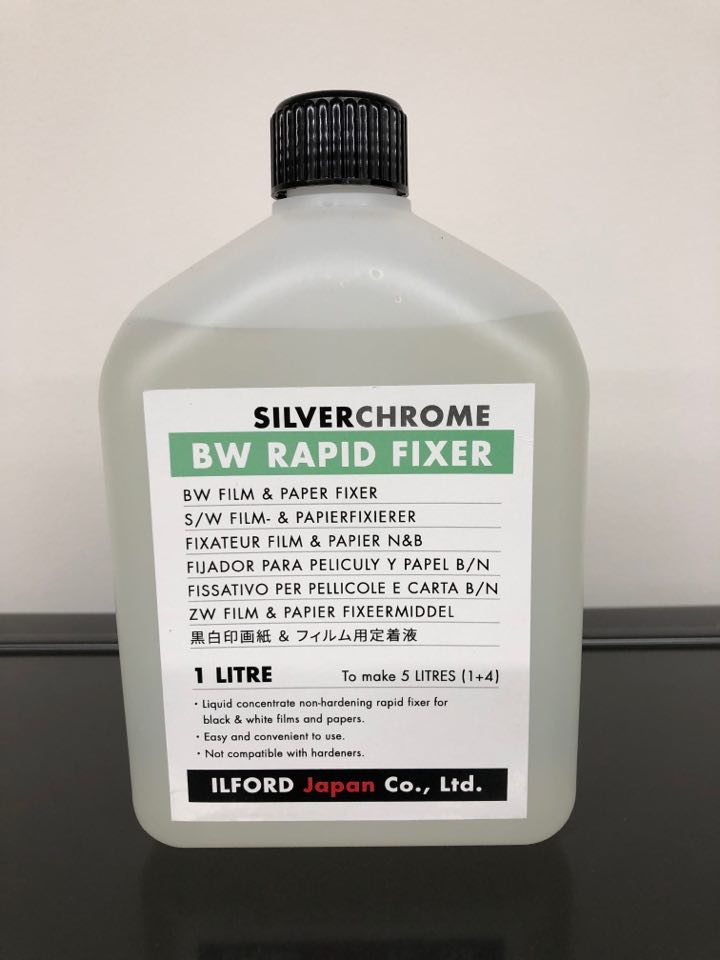

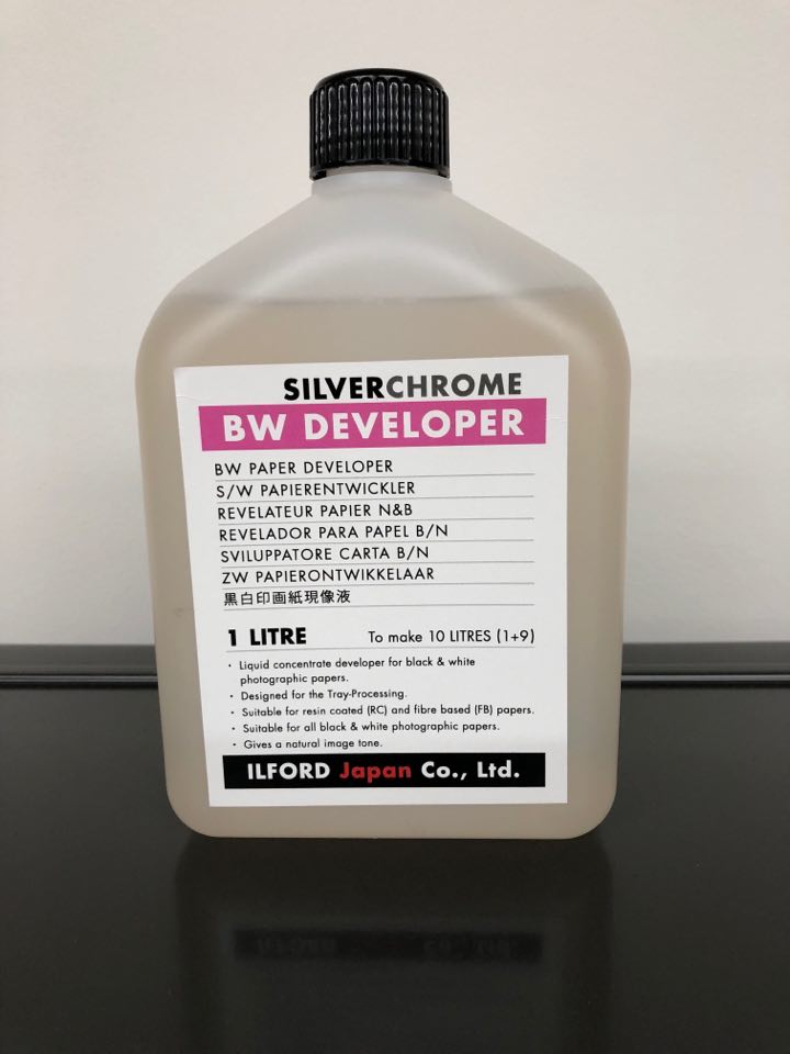

Okay Agx, I confused something, too. Zingst is a while back now and my memory played a trick on me. It´s not Silvermax, it´s Silverchrome. The rest, I cant answer that, because it´s confusing to me as well. Have a look, here are the bottles:
I should note: They didn´t present it. They had it and gave it to us "under the counter" for our Camera Minutera Project. But it wasn´t Ilford Photo. It was the Inkjet/ Bonjet Ilford. I guess it´s some sort of a B2B product. Works really well though.

You mixed up manufacturers.
The one it is about is "Ilford Japan Co. Ltd." It is a japanese offspring of the companies who bought the brands of late swiss Ilford Imaging.
I haven´t looked into it yet. I was just surprised that I got that developer from the Ilford booth at Zingst fair since they only had inkjet stuff. I have no idea why they had it and how they are connected in detail. Sorry to have caused the confusion.
As I said you mixed up manufacturers or more precise booths...
In the start you clearly referred to IlfordPhoto but now it is clear that you got the bottles from Ilford Imaging. Both have nothing to do which each other, except that Ilford Imaging licences the Ilford brand to IlfordPhoto.
But at least we now know there is a product in Japan we did not know of so far...
Though I doubt these bottle were filled by Fuji as you say, as Ilford Imaging/Ilford Japan has access to own manufacture.
